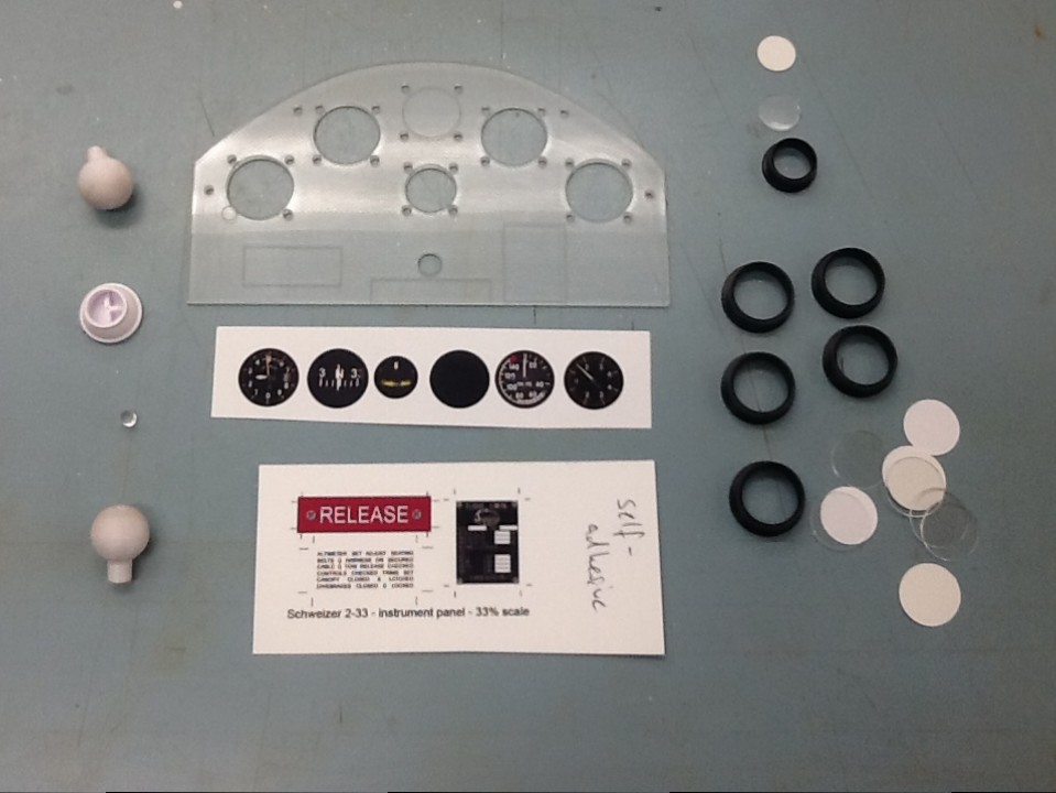

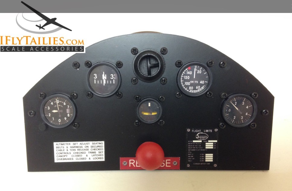

    I ordered one of these from Alex at iflytailies. I got the kit version so I can add my own wrinkle finish. It will be a perfect fit because I gave him the actual autocad drawing of the panel.
    Click image for larger version  Name:	image.jpeg Views:	1 Size:	97.5 KB ID:	29919

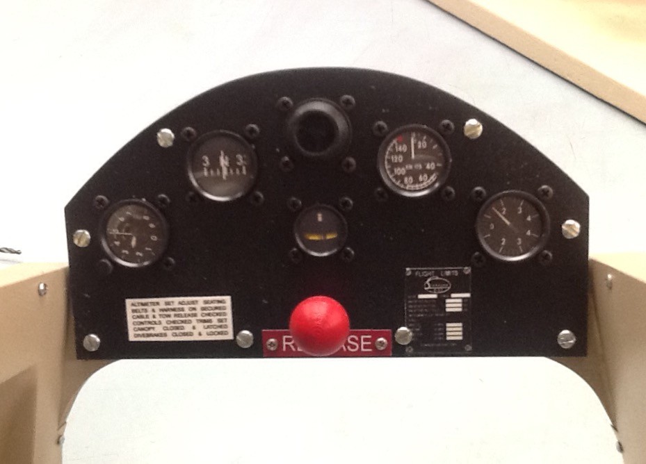

                Got my instrument panel kit in yesterday. Click image for larger version  Name:	image.jpeg Views:	1 Size:	98.4 KB ID:	30078
                4 or so hours later it is done.
                Click image for larger version  Name:	image.jpeg Views:	1 Size:	86.7 KB ID:	30079
