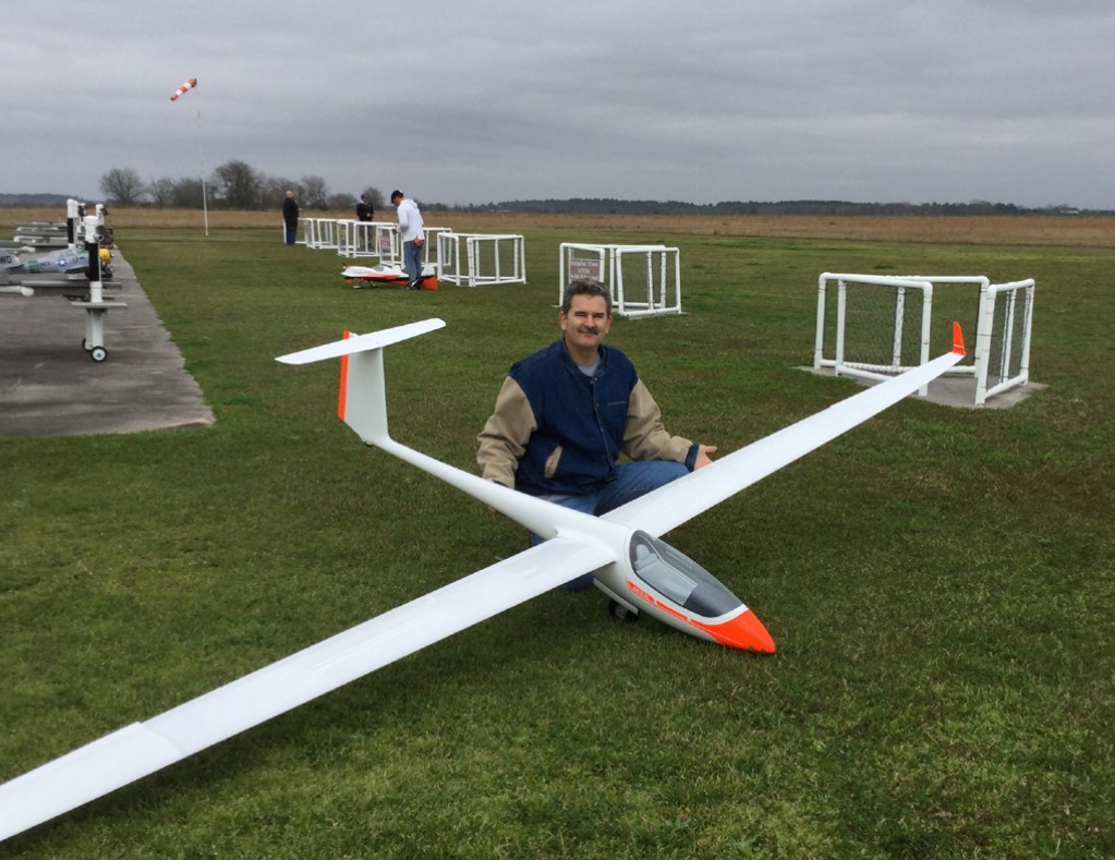

              • Got to maiden the H9 ASH 31 today! All I can say is wow! Two clicks of aileron trim and it was solid as a rock. Not much lift but did my best to work the turbulence!
                Outstanding job Horizon Team! Thank you!

                  Congratulations. I thought I was going to maiden my ASW-27 this weekend but gremlins are everywhere. Can't wait for Apache Pass!
                  Awesome! Congrats, buddy!

                  Congratulations Bryan. So happy you were able to get out an fly the beauty. The ASH-31 has been a wonderful project to be a small part of and to see the global acceptance and positivity is truly rewarding and inspiring.
              • Looks good Bryan. No flying here today. Never out of the 30's, low clouds with fog. Worked on the Ventus some more. I'm beginning to see the maiden coming.
