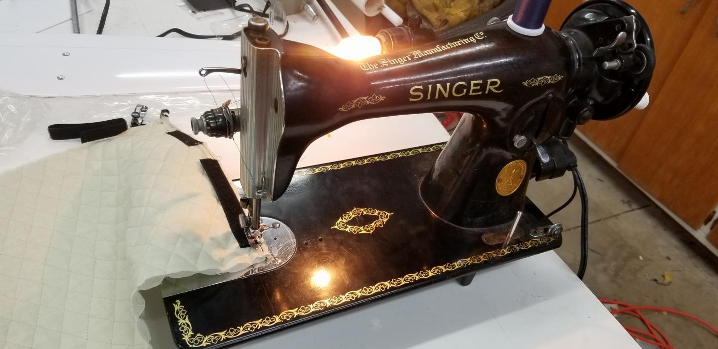

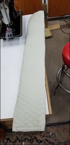

            I sewed up an elevator bag in about 20 minutes for my ASH 31, using my trusty Singer 15-91. It's a gear driven machine made in the 40's that I bought at a garage sale for $25. It will sew though 2 pieces of thick fabric and velcro all at the same time. I buy the material at Joanne Fabrics. I got this idea almost entirely from Kevin K including which sewing machine to use. Good thing I paid attention in high school during Home Economics class! The velcro can be bought at Walmart in various widths. I will finish the wing bags tomorrow. I will probably just sew up something for the vertical tail and go with a canopy cover which I will make oversize to accommodate the propellor.
            I know that many make their own wing bags so this is not new for most, but an option for those that will be discarding the silver bags that came with the glider.

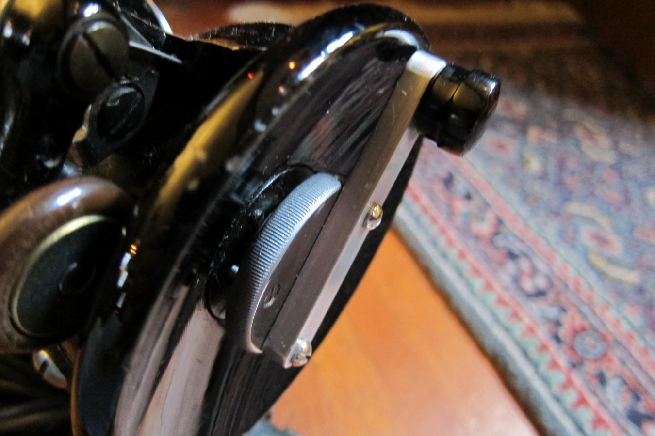

ID:	32441 Another Singer sewing machine that was sold in more numbers is the Singer 201 (late 40's) , also gear driven and works like Tim's. A modification that Tim and I did on these machines was to add an aluminum arm with a knob that lets ya hand crank through the "prickly" side of the sew on Velcro that Tim mentioned in his post. It requires you to take the silver hub off the fly wheel part of the machine and drill and tap....I did mine in 6-32 ...it is small enough that it does not affect the machine when using the motor for all the other sewing. use a # 10 needle or so with heavy thread. Also, much like changing razor blades frequently when doing ultra coat, change the needle on the sewing machine every new project. I am about to start my wing bags and stab bags for my Cmelak this week.

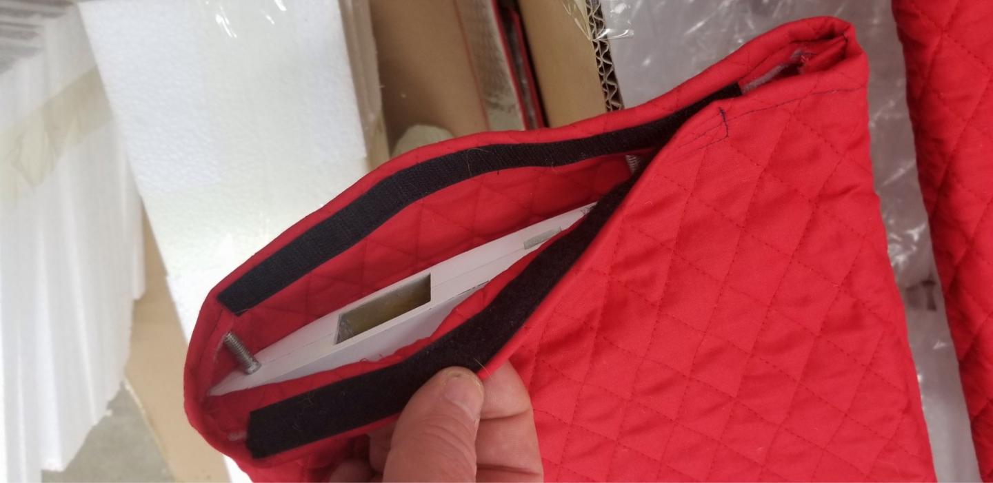

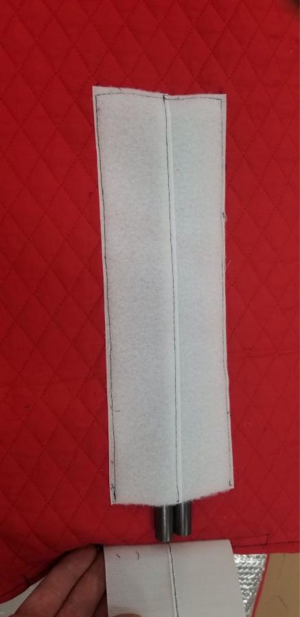

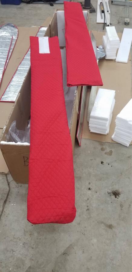

                It might look like I stole Santas clothing but it's merely a coincidence. I finished the second inner wing bags today. I made a pocket that is attached to one cover to store the carbon wingtip rods. It's one of those items that we leave at home only to discover that at the field. This should reduce my odds of doing that, I hope.Tomorrow I'll make up the outer wing bags and start on the rudder cover and a bag for the removable wingtips. Sadly, I will discard the silver bags that came with the glider unless I can think of another use for them. Great idea had they used a better material.
