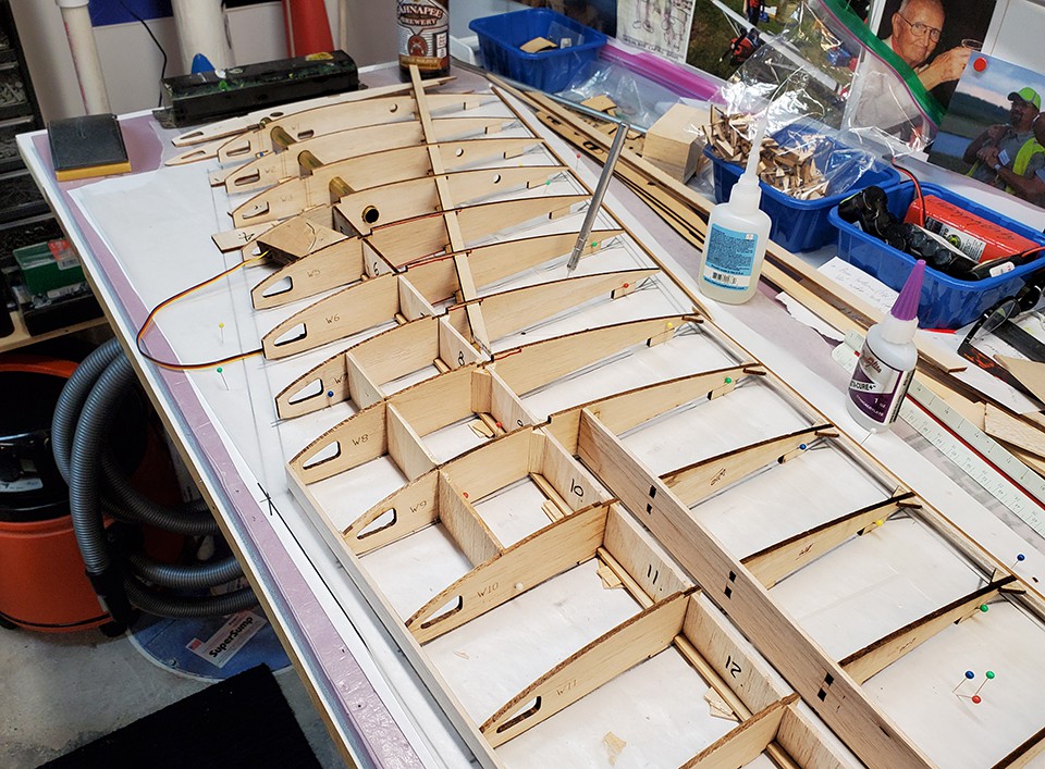

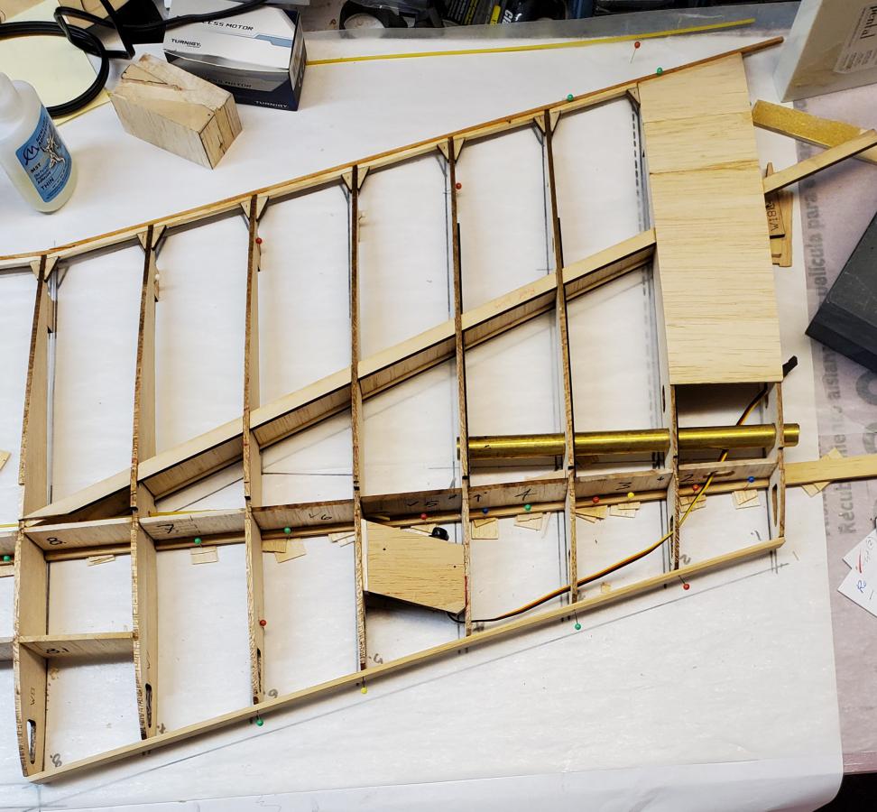

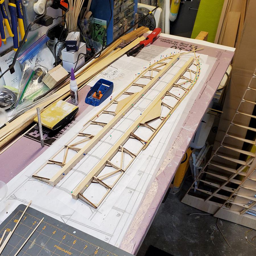

      Back at it now and making progress on the right wing. Is has been great to be in the shop again. Basically decided to begin glueing the darn thing together.
      Click image for larger version  Name:	20200124_073047.jpg Views:	0 Size:	117.9 KB ID:	39823

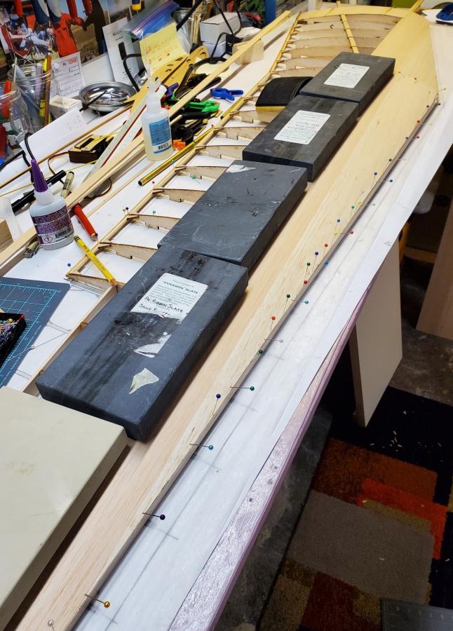

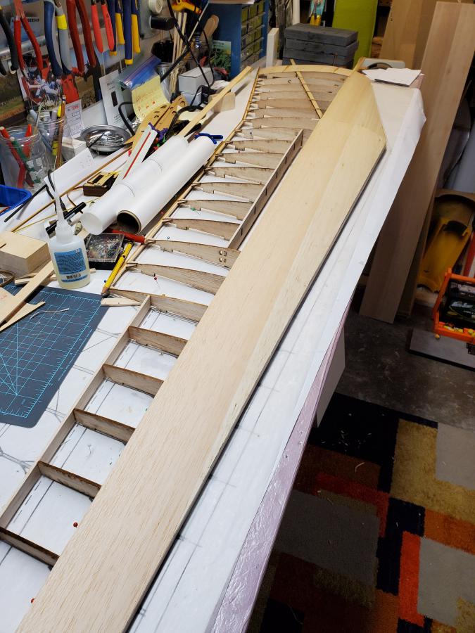

      Used wood glue for the 1/16" sheathing. Gave me time to get everything weighted down and pinned in place.
      Click image for larger version  Name:	20200127_183740.jpg Views:	0 Size:	100.2 KB ID:	39827

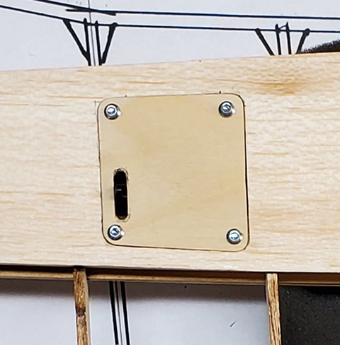

      Compartment for the spoilers. As discussed earlier...will fab spoilers separately as a stand alone piece that can then be mechanically fastened into this compartment.
      Click image for larger version  Name:	20200128_120432.jpg Views:	0 Size:	103.7 KB ID:	39824
      Starting to look like something. Will add the leading edge blocks next and rough into shape. Ailerons will be up after that.
      Click image for larger version  Name:	20200128_060821.jpg Views:	0 Size:	100.4 KB ID:	39828

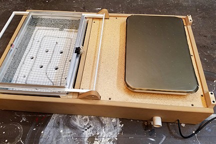

            With the help of a number of friends, we got the vacuum former (Hobby Vac) up and running a couple weekends ago, and then made progress on the canopy plug and frame this weekend. Nice to see some progress on this darn canopy.
            Here is the Hobby Vac.
Name:	Hobby Vac 3.jpg

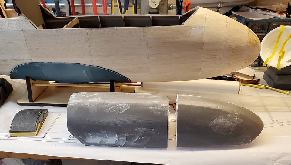

            Canopy Plug

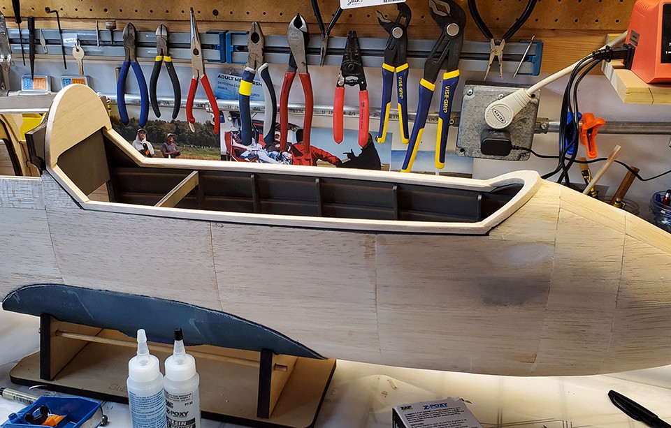

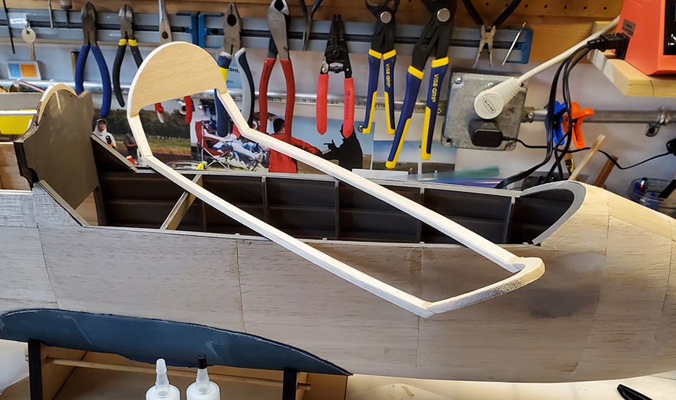

            Canopy frame. Will finish sand, add magnets, then glass and paint.
Name:	Canopy Frame 2.jpg
Name:	Canopy Frame 3.jpg

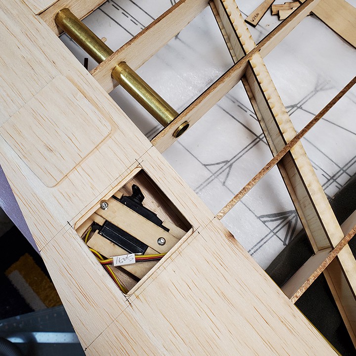

            Spoiler servo hatch.

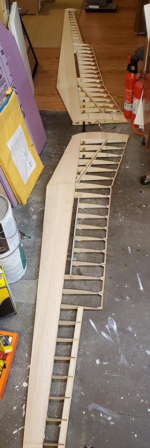

              More progress shots including a few of the left wing, wing strut brackets, and fuse skid shocks. Getting a little more shop time now as I suspect most of you are as well. Hope all is well with you and your families. Take care.

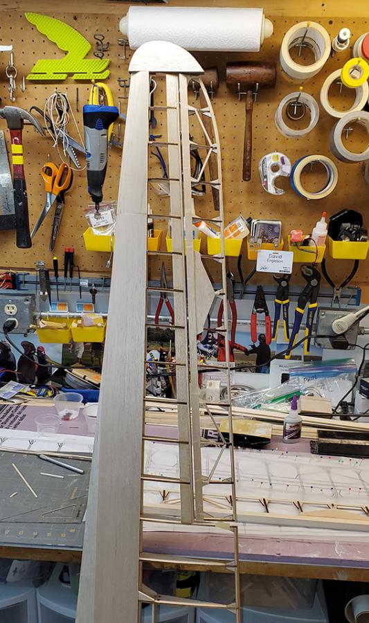

              The start of the Left wing.
Name:	Left Wing Start.jpg

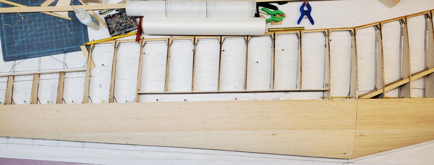

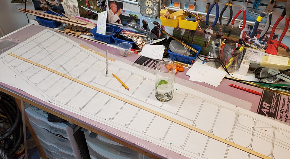

              Little progress...second wing is going fast compared to the first.
Name:	Left Wing Mid.jpg
              Here is the right wing to show size. I think the forward swept wings are oddly elegant.

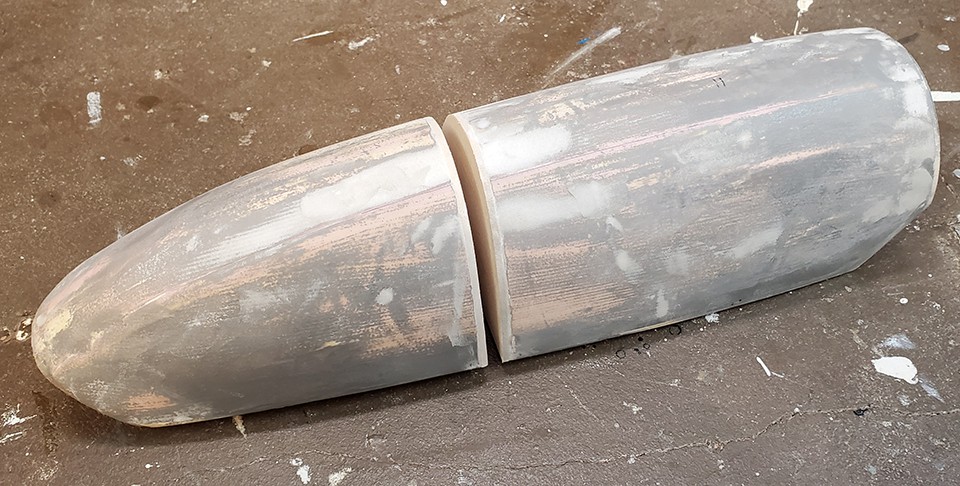

              Canopy Plug - Made numerous attempts to get all the bumps and imperfections out but it seems that each time I do, new ones form. Ugh.

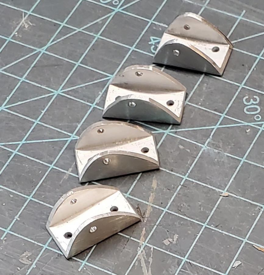

              Wing strut brackets.
Name:	Wing Strut Brackets 1.jpg

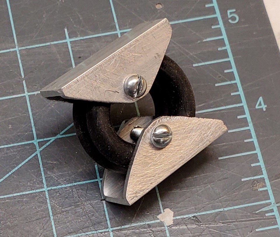

              Fuse skit shock...first attempt. I think they are a tad too large so will look for smaller o rings. Used 1/2" x 1/2" aluminum channel stock as a starter.
Name:	Skid Shock 1.jpg
                David- get the plug as slick as you can then pull styrene over it. Leave the styrene in place then pull your vivak over that. The styrene will level the imperfections pretty good and render a nice canopy.
                Also, make your plug deeper (taller?) than needed to keep 'webbing' from pull to a minimum.

              That's a great tip ARUP. Thank you! Wish I would have know that a month ago...been worrying about it. The plugs are deeper and longer in every dimension as you have noted. Hope to pull those Saturday.

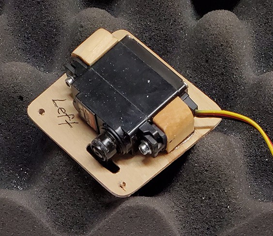

                The aileron servos are installed. Will solder up the Digi-Key connectors at the wing root next.
Name:	Aileron Servo Cover 2.jpg

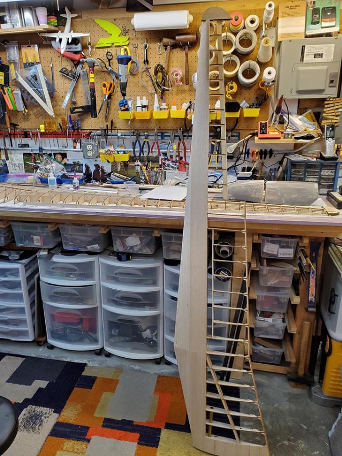

                Wing trial fit...seems fine. Not a lot of room in my little shop.

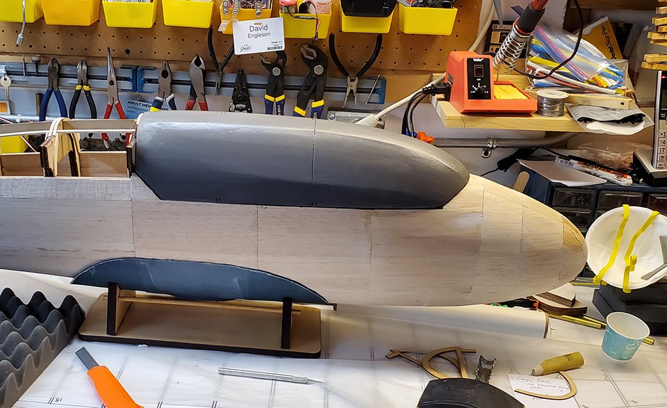

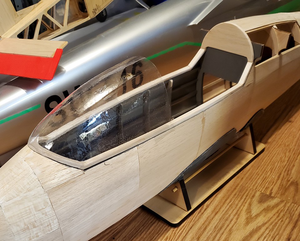

                Also made a few canopy pulls on the Hobby Vac and avoided burning the house down. Always good. Through experimentation I'm now using the right mil PET-G material, have the pump & Fein shop vac dialed in, and the timing and sequencing of the pull down. The weak link is the plug. The finish has been pretty crude on the first canopies. ARUP - I did try pulling a canopy...trimmed it, and then pulled a second over the top. The first was actually my best to date...when I pulled one over the top I trashed them both. Actually was a little funny. Will keep you posted.
Name:	First Canopy Pull Attempt.jpg
                Trial fit the crappy one just to see how it fit. Fit was fine...finish not so much. More to follow, - David
Name:	Canopy Trial 1.jpg
                  PET-G over PET-G won't work. They will stick to each other. Is that what happened? I've pulled Vivak (PET-G) over Styrene without problems. Orient your plug 90 degrees from that shown in picture and you'll get less webbing. That isn't a bad pull, though!

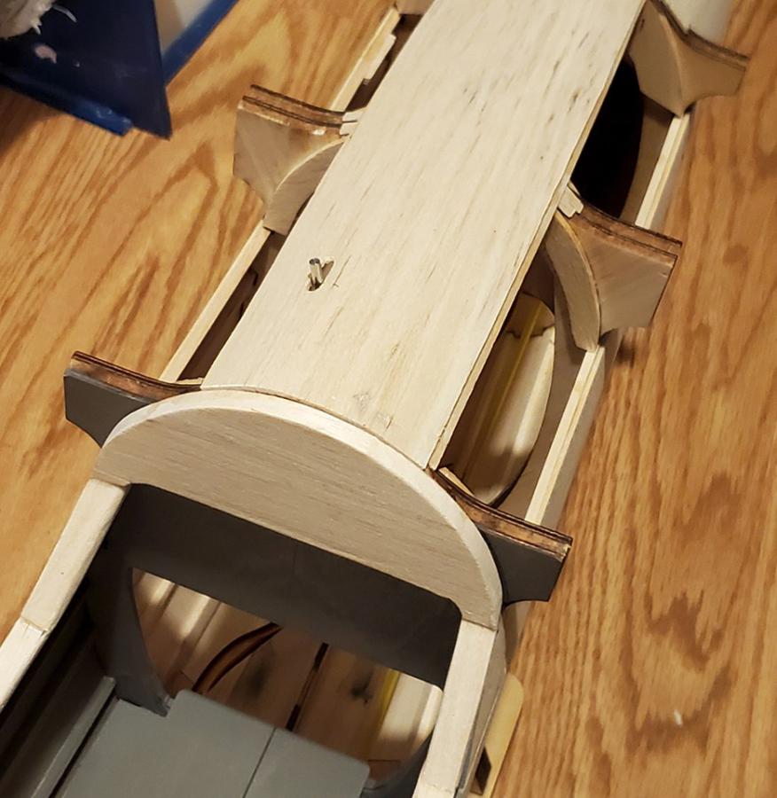

                      Installed the canopy latch and a portion of the turtle deck.

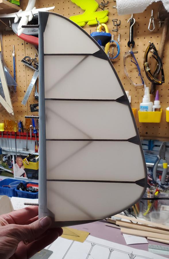

                      Roughed out the ailerons. Still have a few gussets to add and then the sanding. These old birds really do have majestic wings. The front of each wing will be covered in solid white Solartex and the back portion will be covered in the "natural" translucent Solartex to show the ribs and framing like the rudder and elevator.
