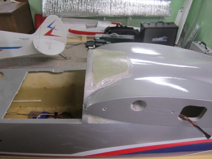

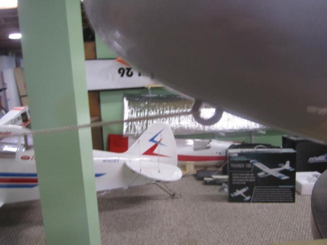

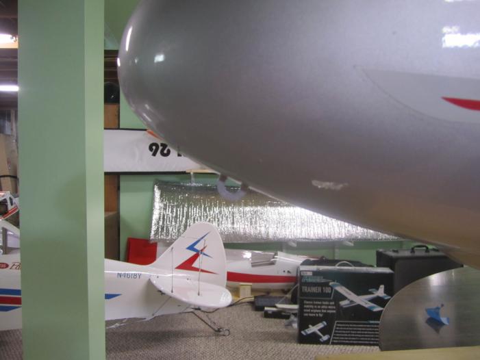

              When Kevin and I were aerotowing at Harris Hill, I noticed the fuse behind the canopy was getting pretty weak. Sort of copied Stephane in that I took out the windows and fiberglassed all around the inside. Much stronger now. Also got the scale tow release installed. Thanks Gunny.
