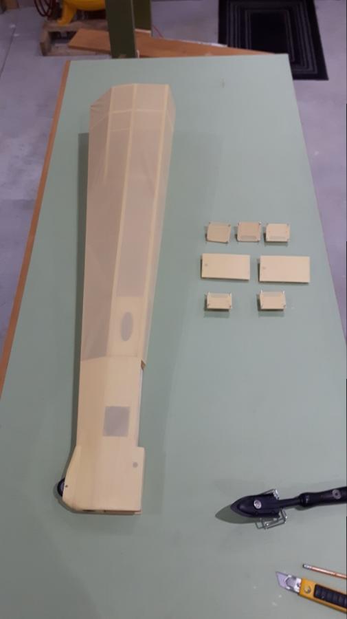

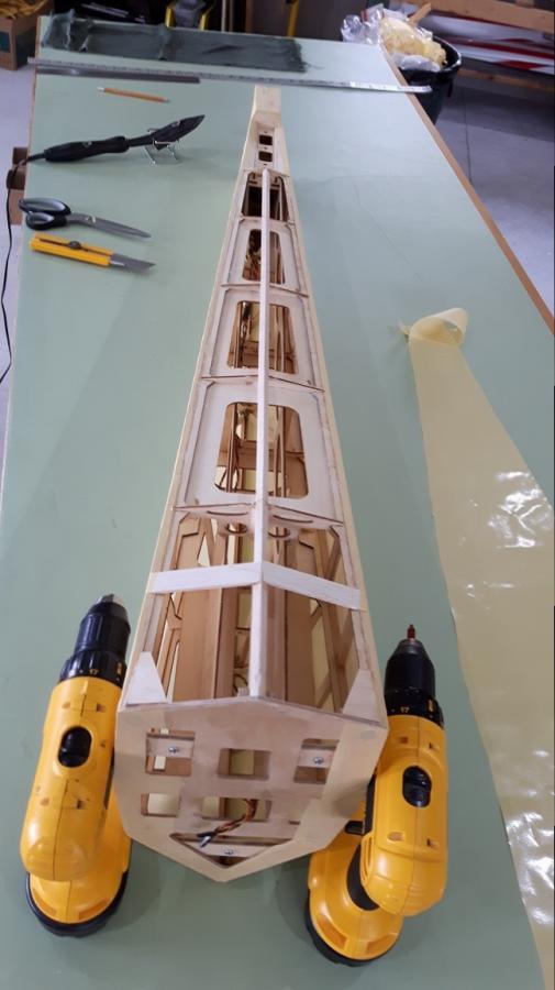

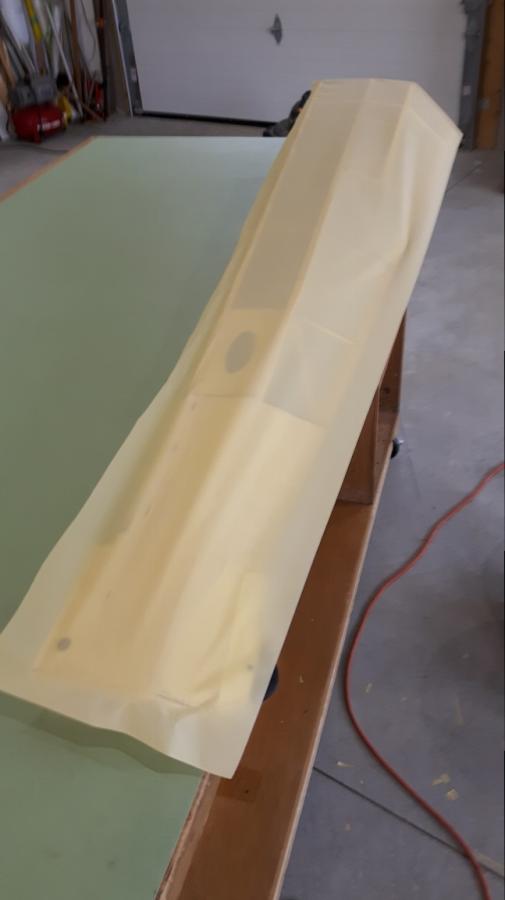

        Starting the rear fuselage
        Two sides done, ready for the top.
        All done!
ID:	16612 Forward part of the fuselage ready for glassing.
        Things continue....

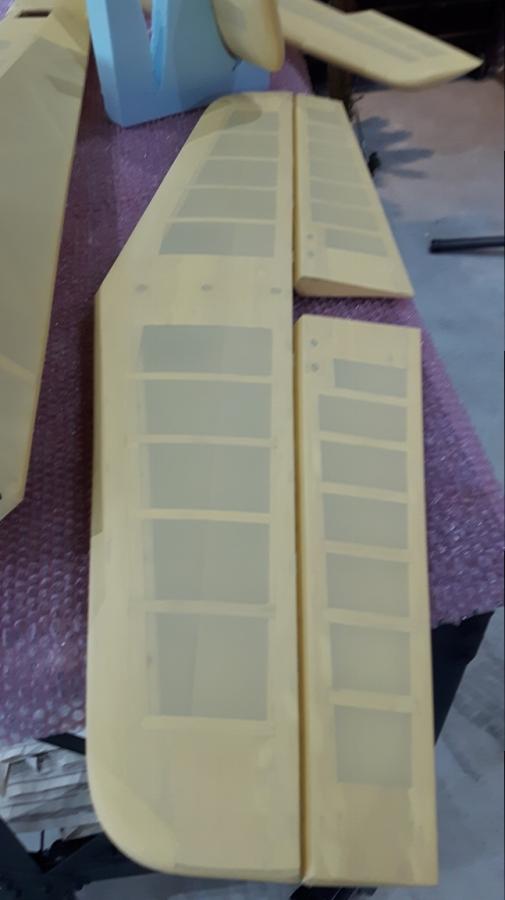

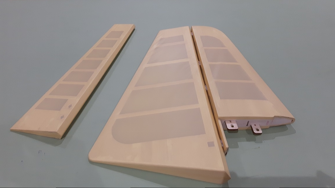

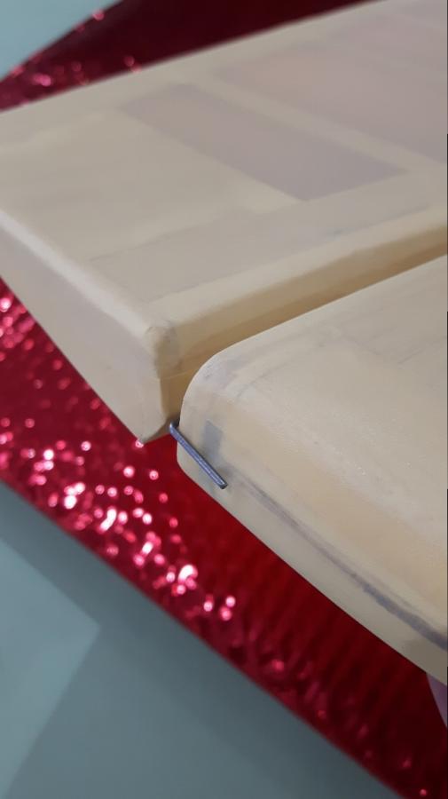

                I managed to get all of the control surfaces hinged and joined to their respective panels.
                My first time using these CA hinges, not bad at all!

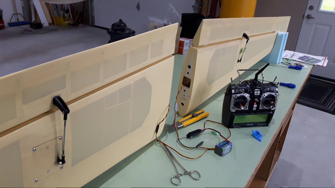

                  Here are the results of my hinging experience today......
                  Horizontal first.
                  Click image for larger version  Name:	20170520_193448.jpg Views:	1 Size:	32.7 KB ID:	16917
                  And the ailerons....
                  Click image for larger version  Name:	20170520_193433.jpg Views:	1 Size:	43.9 KB ID:	16918
                  Rudder was done as well...

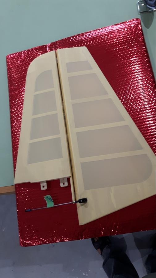

                  I used plastic hinges with a long removable hing pin so the rudder is removable from the fin for transport.
                  Tip of the removable hing pin.
                  Click image for larger version  Name:	20170520_200156.jpg Views:	1 Size:	26.1 KB ID:	16919
                  Rudder is now complete.
                  Click image for larger version  Name:	20170520_200054.jpg Views:	1 Size:	46.1 KB ID:	16920

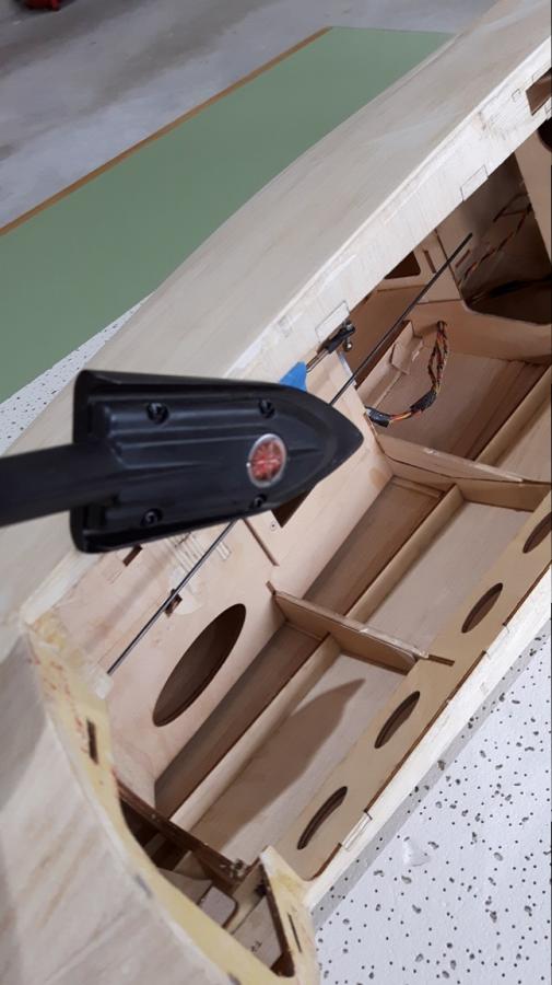

                      Got some good work done on the K8 today.
                      One thing I wanted to tell you guys about using the Minwax process is that you can iron out any small imperfections. I just use my covering iron and works quite well.
                      I iron down the edges as you can see in the following photo. Click image for larger version  Name:	20170521_103448(0).jpg Views:	1 Size:	51.0 KB ID:	16931

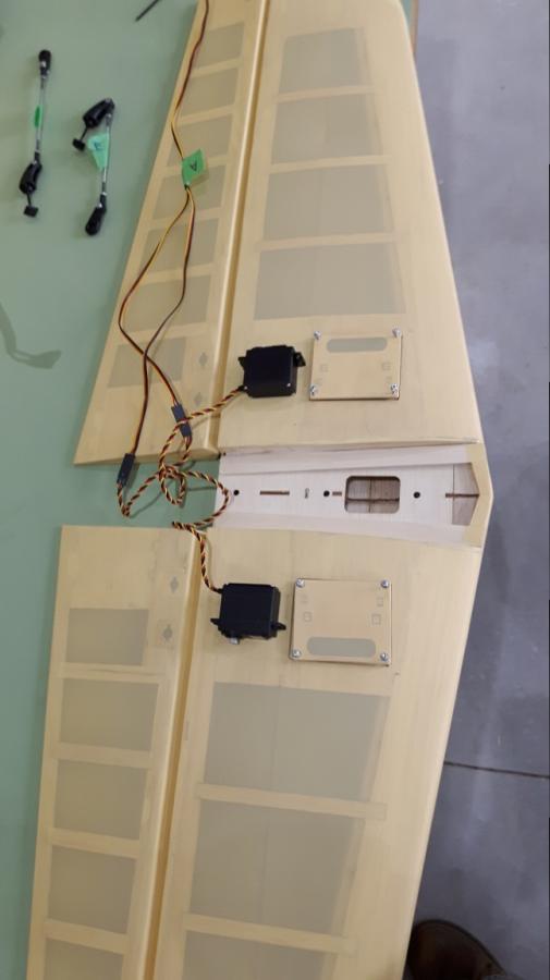

                      After getting the fuselage sanded and another coat of Minwax applied, I moved onto installing the servos and linkages.
                      Thanks to Steve R, all of the hard work was done as far as mounts and pushrods were concerned and all I had to do was install the actual servos.
                      Steve had told me what equipment he had in the airplane so I just copied what he had done and it made things very easy. Click image for larger version  Name:	20170521_145629.jpg Views:	1 Size:	33.4 KB ID:	16932

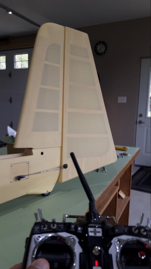

                      The rudder was the first surface to get completed and moving via radio waves. Click image for larger version  Name:	20170521_150721.jpg Views:	1 Size:	32.4 KB ID:	16933
                      Elevators were next, and required two servos. All surfaces utilize Hitec HS645MG servos. Click image for larger version  Name:	20170521_160405.jpg Views:	1 Size:	306.2 KB ID:	16934
                      Here are both hooked up and working. Again, thanks to SteveR and his well executed previous installation, things went very easily and worked perfectly! Click image for larger version  Name:	20170521_164319.jpg Views:	1 Size:	404.7 KB ID:	16935
                      The ailerons were next and again no problems were encountered. Very straight forward and very robust.

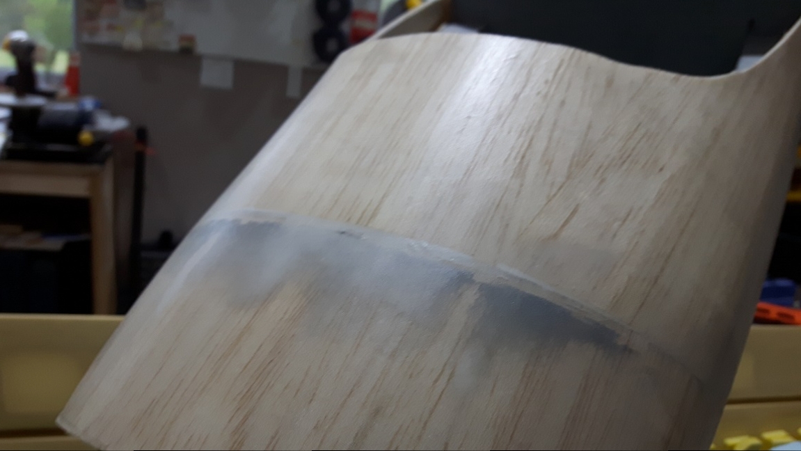

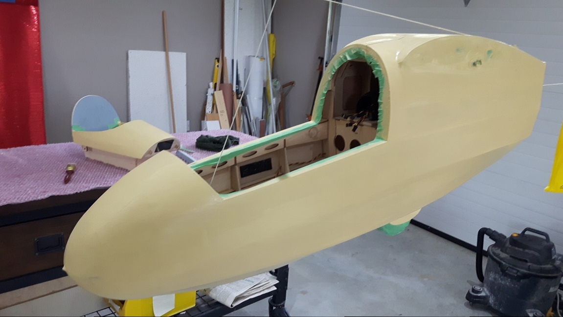

                        Back to the fuselage a bit.
                        Here you can see the forward part hanging from the ceiling. After a quick sand and a little ironing, I gave it another coat of Minwax.
                        It really doesn't require a lot of product to get a nice surface.
                        I took a covering sample to my local hardware store and they had one of those colour match machines. Worked very, well and I'm very happy with the match they came up with.
                        Hopefully I will be painting this and the cockpit area tomorrow.

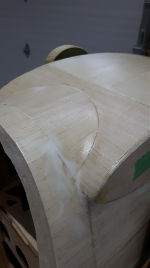

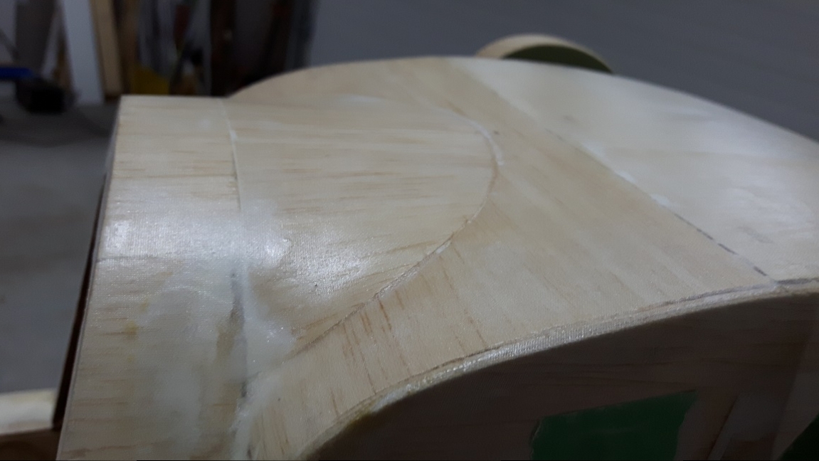

                        Remember the wing root/ fuse junction mess of the stock model. Well here is the reworked area, quite a change I must say.
                        Another view of the same area.
                        Much nicer this time around.

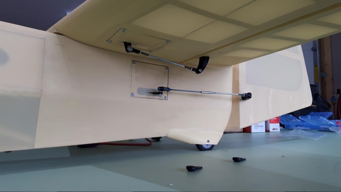

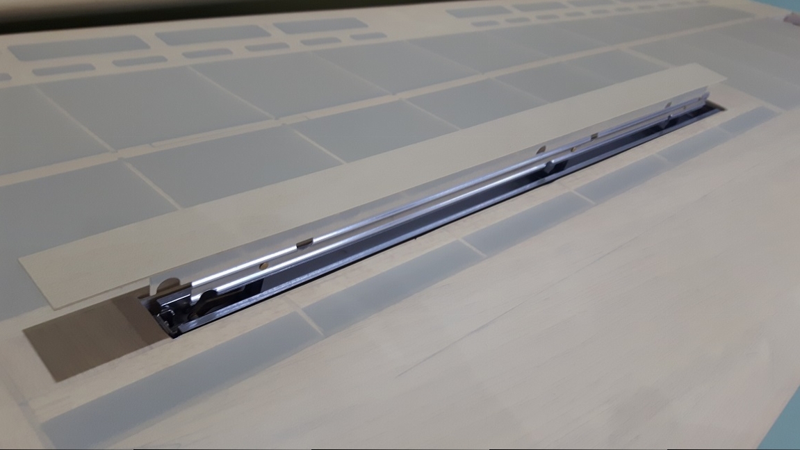

                          I got to spend another good day working on the K8 so it's just about completed now.
                          Today's tasks were installing the spoilers and painting the fuselage.

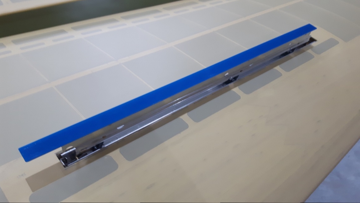

                          I opted to install bottom spoilers in addition to the ones Steve R had already installed on the top surface.
                          Steve's original ones had blue G10 epoxy plates as the top surface, seeing as I didn't have any of that material on hand for the bottom ones I opted for 3/32 plywood.
                          Both worked out quite well as you can see from the photos.
                          One of the new bottom spoilers with the plywood top plate installed and painted. How is that for a great paint colour match to the Solartex!

                          One of Steve's original G10 capped top spoilers.
ID:	16960 View showing one of each. Top surface is the blue spoiler and the colour match is the bottom.
                          Very happy with the spoiler actuation and travel when plugged in and working. Sure beats fiddling with linkages!
