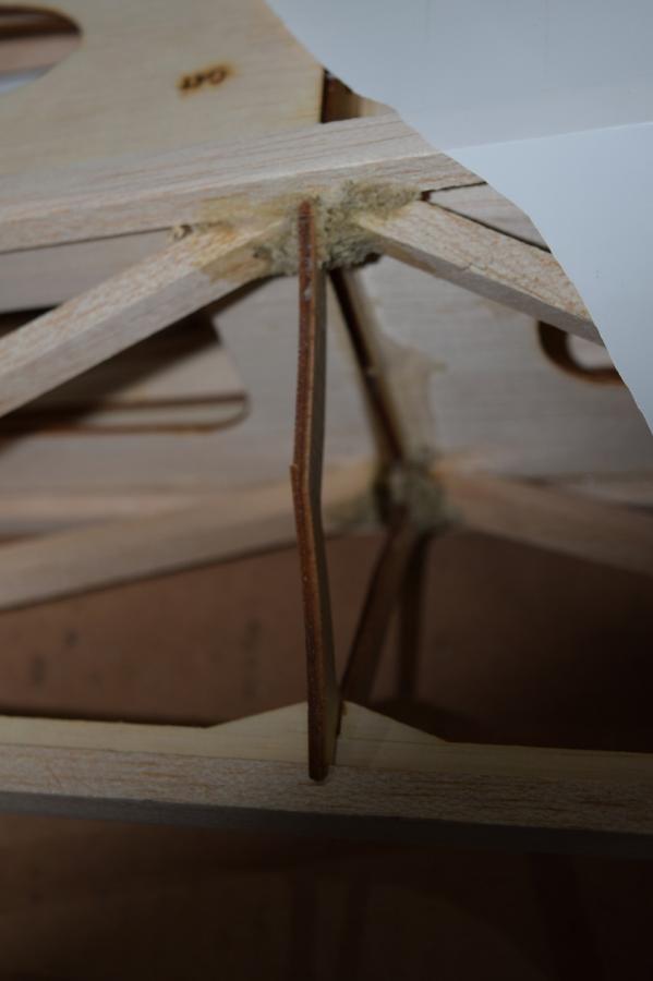

                When I stripped the airframe I found some broken formers in the aft part of the fuselage. These were repaired and some additional doublers were installed on all of the lower aft formers.
                More to come.....

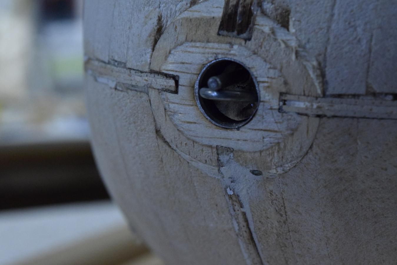

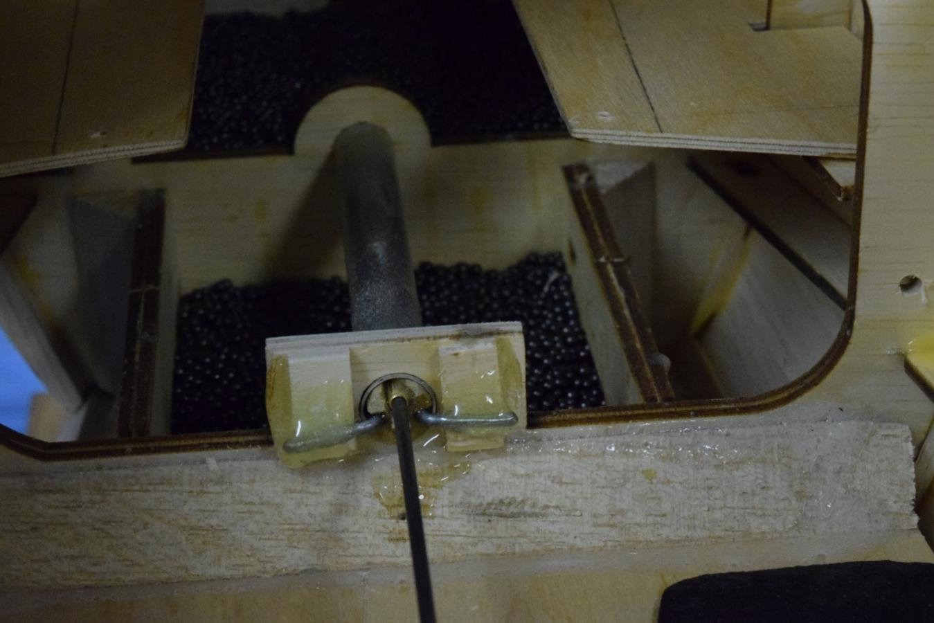

                  The next item that needed attention was the factory tow release, it had to go!
                  Following what Tom P and a few other owners have done, I did the extension dowel in the factory release tube. This moves the actual release upfront where it belongs.
                  Where it belongs!

                  The aluminum tube was epoxied in with the nose weights by Steve R. The wires run the entire length of the tube to the front release loop.
                  More to come....

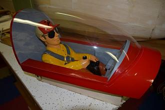

                    Continuing on with this adventure.....onto the cockpit. The stock cockpit is shall we say, a bit "different", and personally I don't like it at all. Because I'm going with a more of a retro look with this rebuild I researched open cockpits for the K8 and found several different examples. As you can see from the photos, it totally changes the look of the airplane and is exactly what I want, so onto the the rework of the canopy frame.

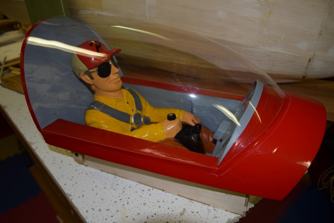

                    I started with the stock canopy frame and removed the crazy looking pilot, and the floor. Then I carefully removed the canopy from the frame and set it aside for now. The windshield will be cut from it later on.

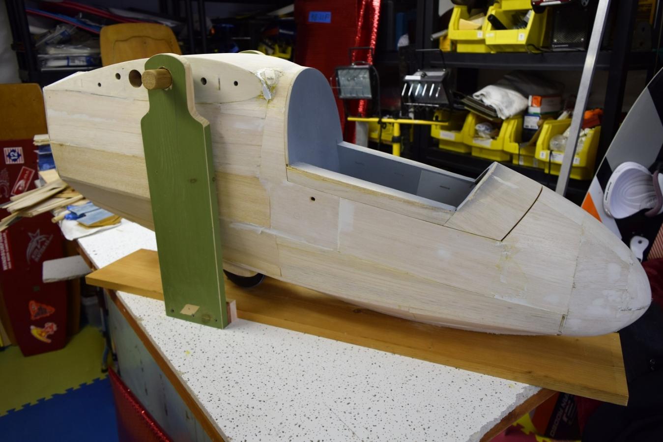

                    After looking at the various open cockpit designs I choose one that I liked the best, and I'm following that one.

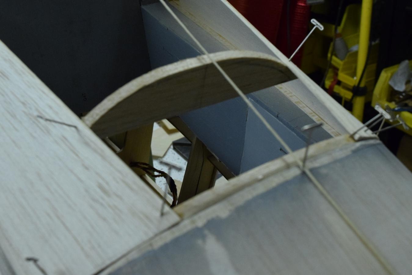

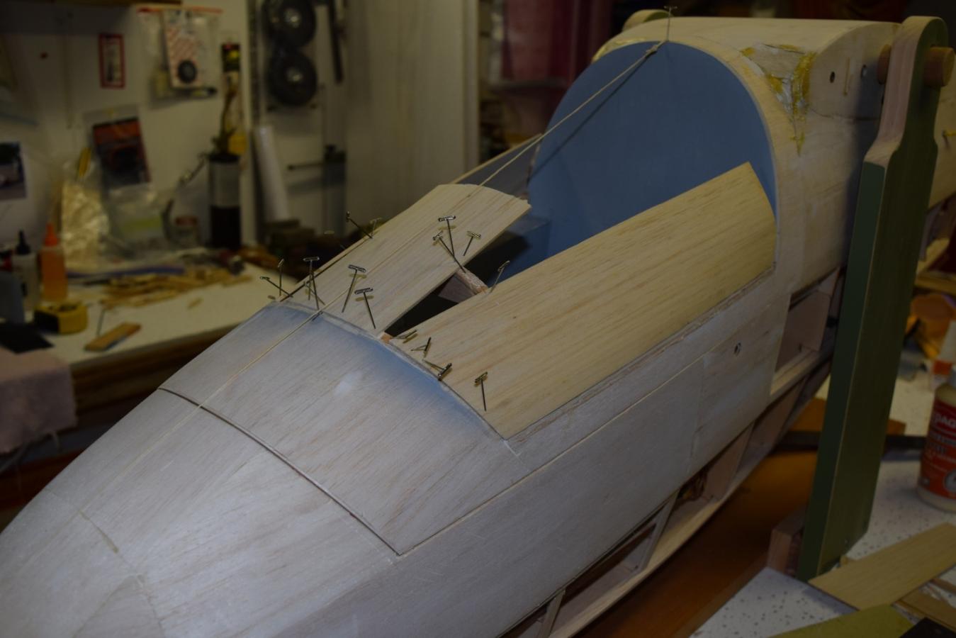

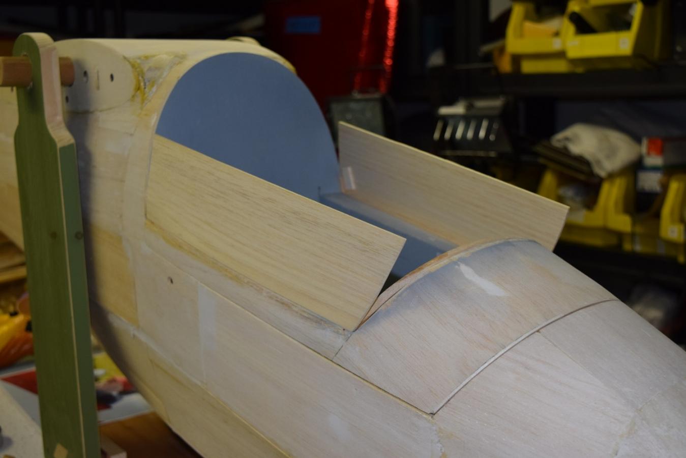

                    Onto building the framework for the added planking needed to achieve the look I wanted.
                    Pretty straight forward actually, as you can see.
ID:	14581Click image for larger version

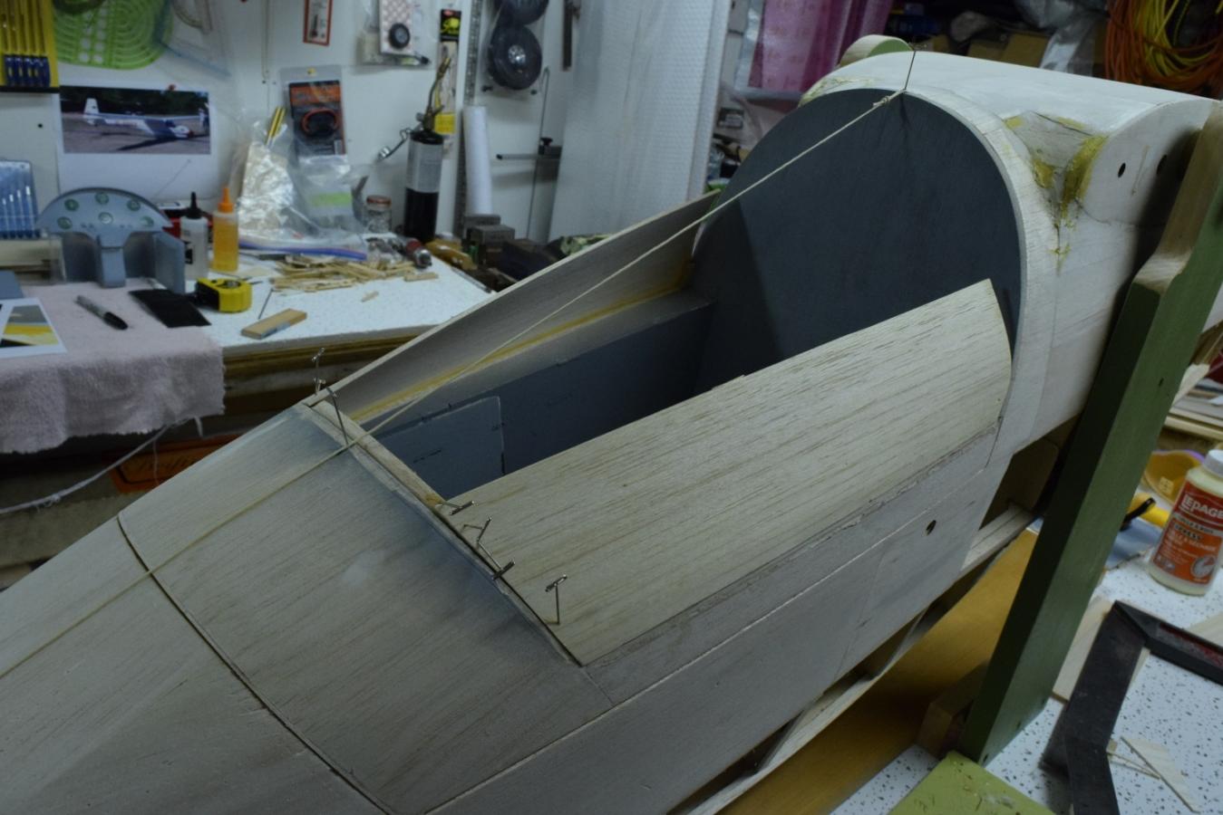

                    Planking started, and I added the centre string to keep things...well.... centered!

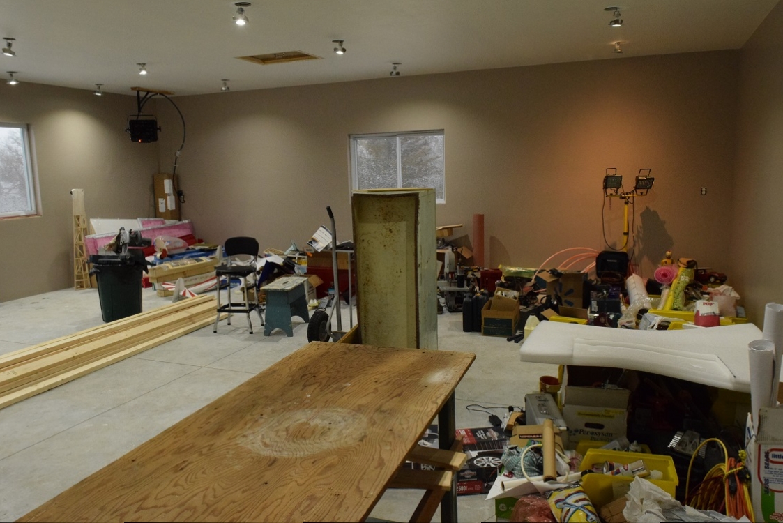

                        Progress on the airplane has slowed due to me moving everything into the new shop!
                        I can't believe that everything you see here came out of the little basement room where I was working before.
                        I am now building a new workbench along the windows, should have it done tonight.
                        Still going to take a while longer before I can get back to the build part of this thread.

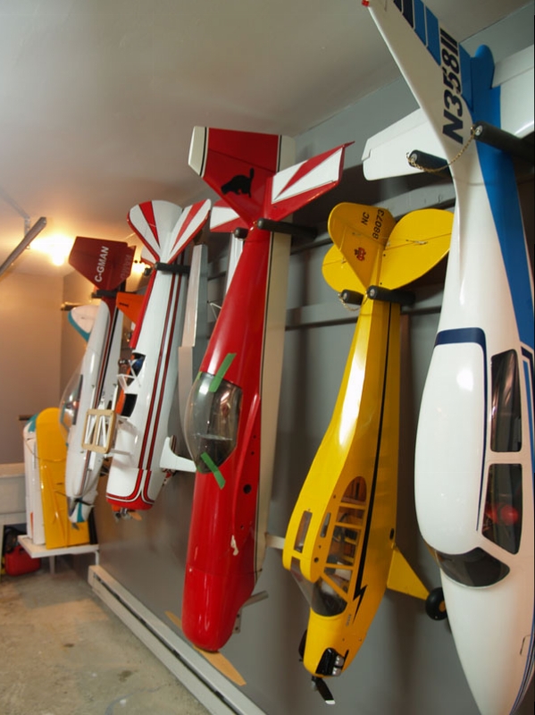

                            Now a question to you guys about wall storage systems for wings and fuselages for these bigger gliders....what do you guys use?
                            The fuselage storage is pretty easy. I like the one in the photo attached here. But it's the large wing panels that I'm worried about. Do you lay them flat, stand them up etc?
                            I did a Google search and came up with some ideas...
                            Something like this for the fuselages?
