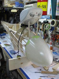

    She has a Nose......

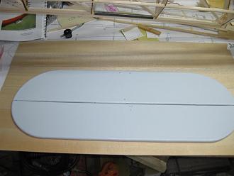

    Got the Poly-Tone Juneau White on the stab/elev

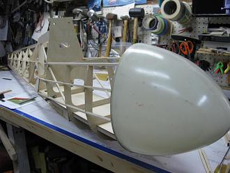

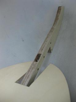

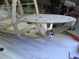

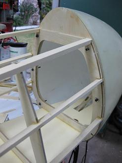

      Finishing up on the scale tow release and nose area....lower stringers installed too. Wings up next.....

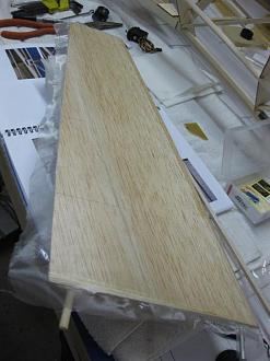

        Now moving to the rear of the glider......

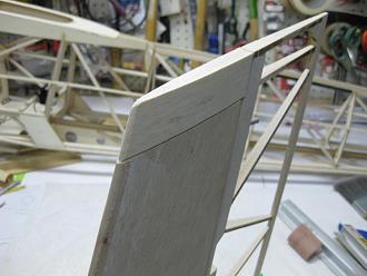

        Profiling Rudder counter-balance and general shaping....
        Click image for larger version  Name:	IMG_3976.JPG Views:	1 Size:	55.1 KB ID:	15576Click image for larger version  Name:	IMG_3977.JPG Views:	1 Size:	88.7 KB ID:	15575Click image for larger version  Name:	IMG_3978.JPG Views:	2 Size:	68.8 KB ID:	15577

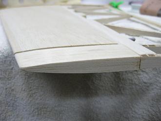

          0.5 oz fiberglass on the Fin - going to try to simulate the panel lines .......

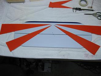

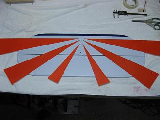

            Got some Christen Eagle Blue on the leading edge of the stab and now trying to figure out ..... two ....or three stripes. I think I leaning toward two.
            Strips are spray painted construction paper....spraying is less messy and more even coverage than a brush.........

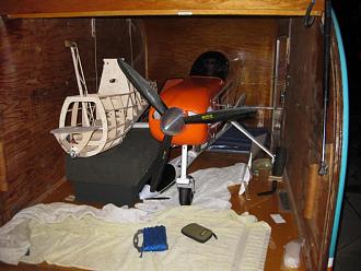

            The fuselage (naked) had to spend the night in the TearDrop Trailer with Big Bad Bidule.....hope it was OK.....

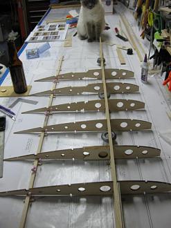

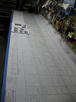

              The Wing......
              Apparently I forgot to order the 3/16 x 3/8 bass wood drag spar material so things came to a screeching halt.....Emergency Aircraft Spruce order.....good part is I can get 5' lengths for the tip section and I wont have to splice.....
              Was geared up for assembly but maybe I'll disassemble a different wing........
              Click image for larger version  Name:	IMG_4010.JPG Views:	1 Size:	62.3 KB ID:	15755

                Looking good Scott. The full scale fuselage and wing has 3 sunburst stripes. So, I'm liking the 3 on the stab. That's just me....
                  Thanks Gunny, I'll have to ruminate on how many strips......meanwhile......its inspection day

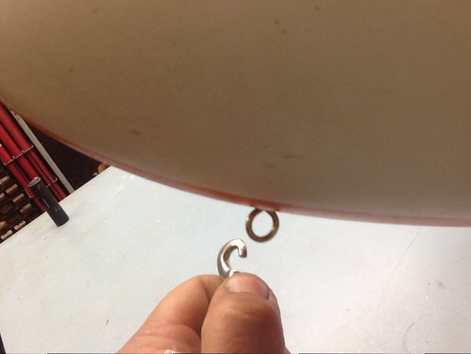

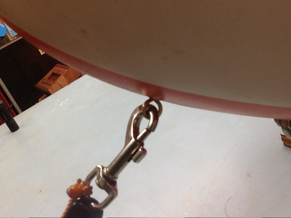

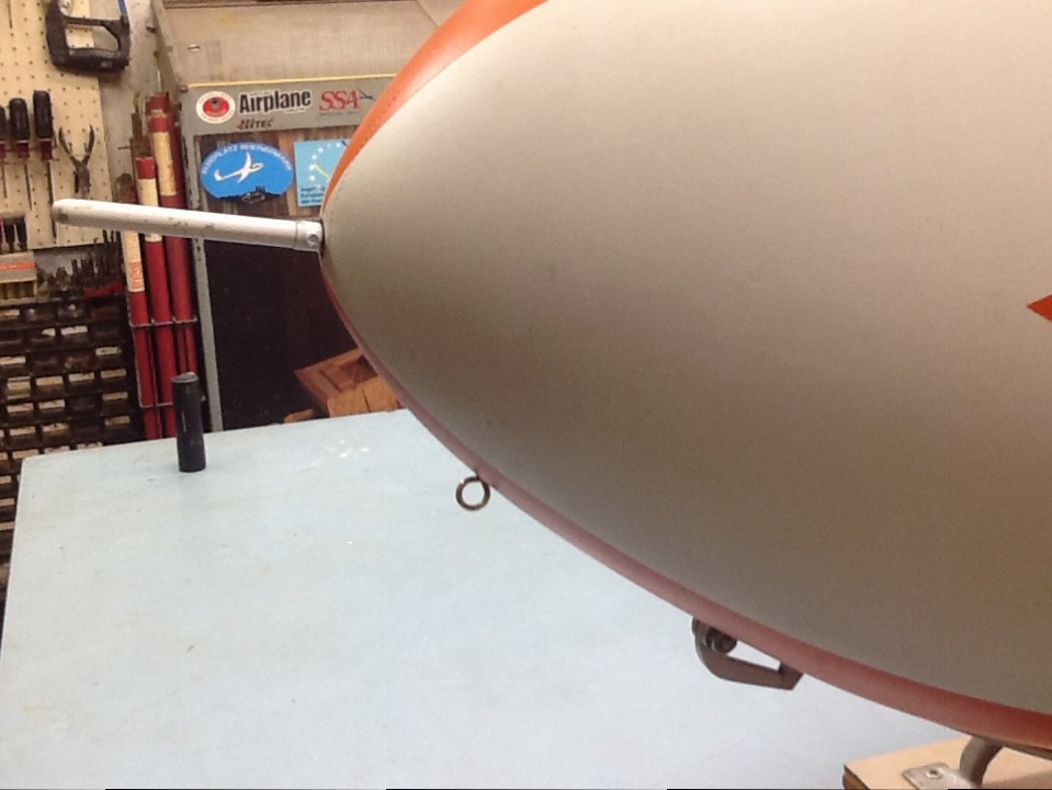

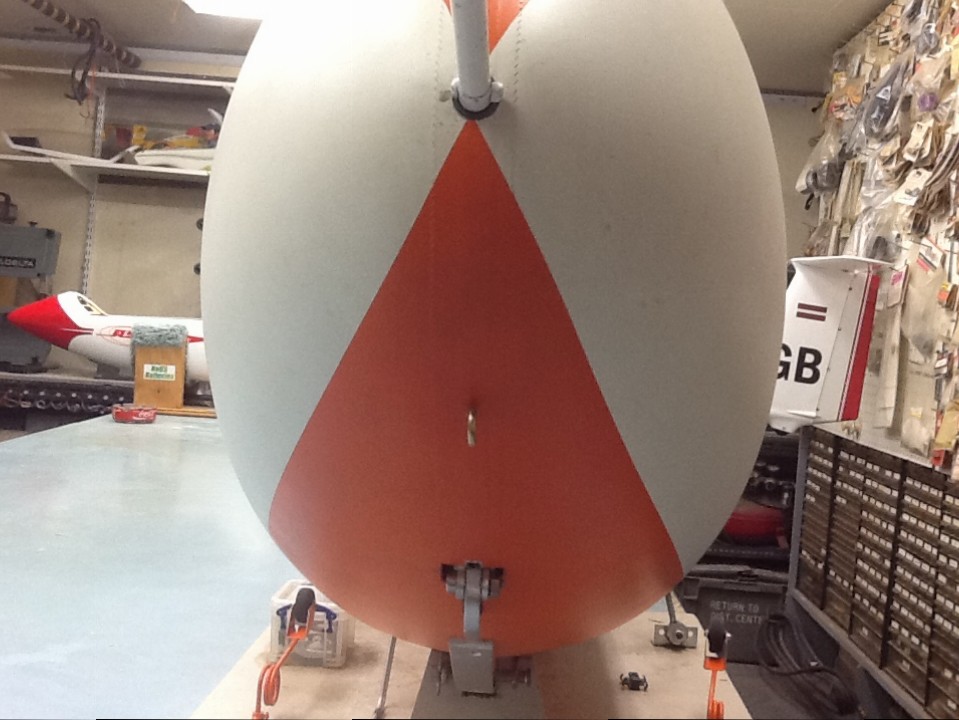

                                Was doing some model maintainence on my sailplanes and 1/3 scale 2-33. I added a brass eye screw between the tow release and the push bar. Reason for this is to retrieve the glider off the runway super fast with your leash when another sailplane is just seconds away from occupying the same spot on the ground! This is a definition of an accident!
                                A clearance hole is drilled through the fiberglass nose cone but the screw part is threaded into the 3/8" thick ply keel extension that is just behind it.
ID:	30092Click image for larger version
