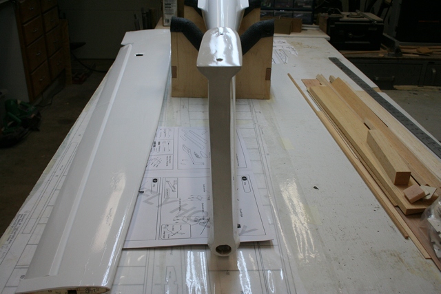

    Within our club, First Arkansas Soaring Team (F.A.S.T.) there are several of us who are interested in Aerotow. We have had some success with monthly Aerotow events and purchased this model for an Aerotow trainer. I thought I would document the build here so everyone can get an idea of the quality of these super cheap models. Stay tuned and I'll be updating this daily.
    Here are some photos just to let you see the overall quality, or lack thereof. There seems to be no concept of true or accurate. It would actually be better if they wouldn't do anything. At least you wouldn't have to undo anything, you could just do right the first time.

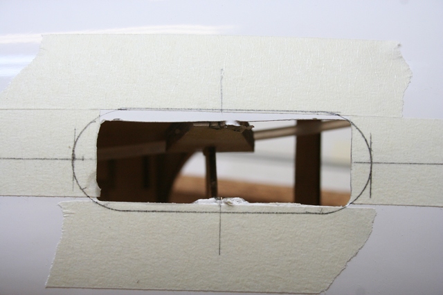

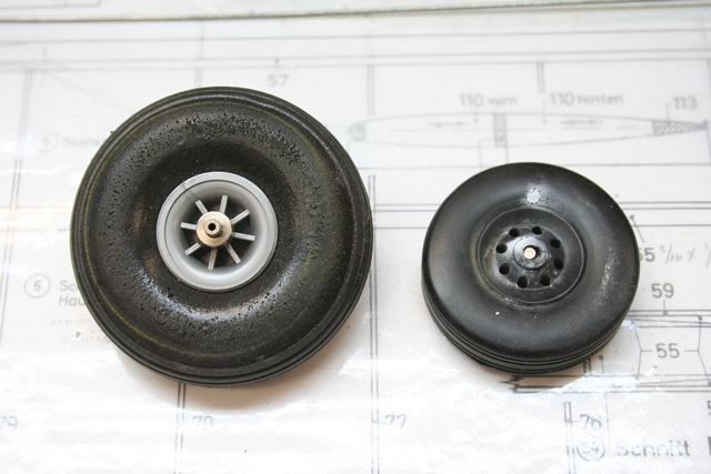

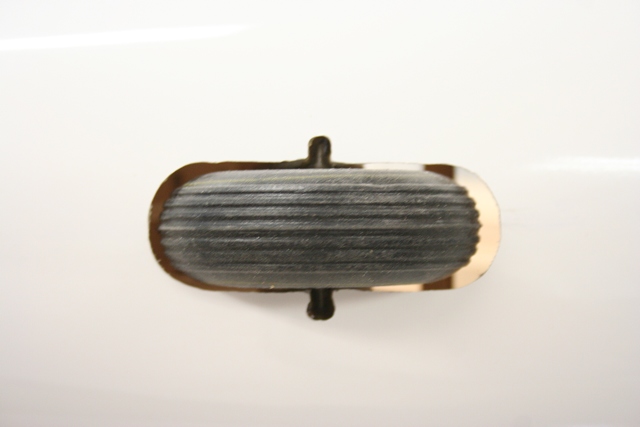

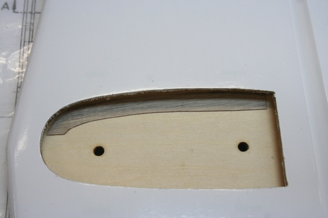

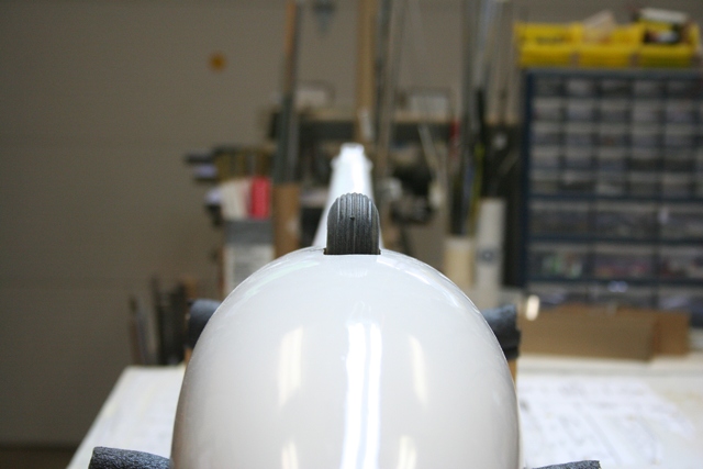

      The first thing I did was use a Dremel to cut out the main wheel. The one on the right is the original the other is a 3" wheel I will use.
      Laid out the new opening. Note the crooked former inside.

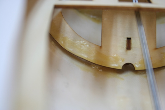

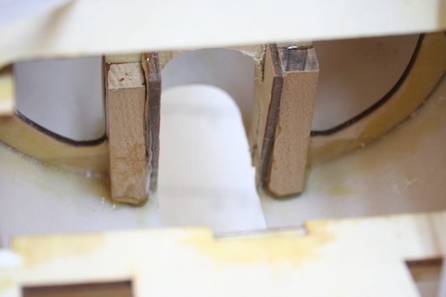

      After removing two layers of plywood to widen the hole I epoxied in some hardwood supports.

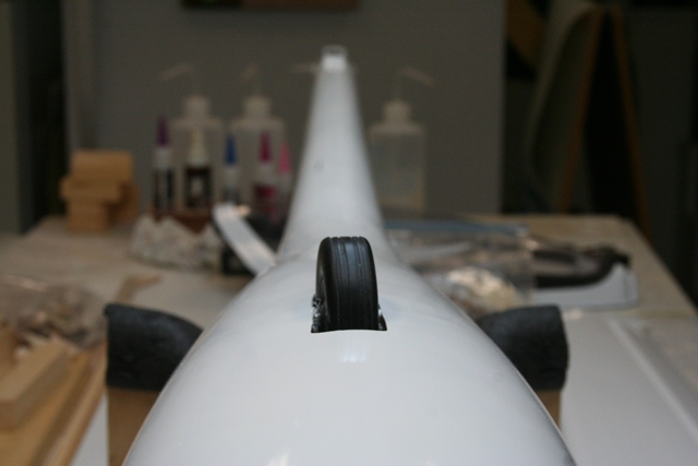

      Then I milled some slots and epoxied in the wheel.
      Much better.

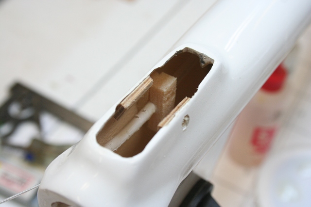

        Obviously the same guy drilled these holes that mounted the main wheel. I think it was Won Hung Lo's brother...Tu Duh Lef. BTW the original wheel was pretty cheesy. This is one I had, very light weight foam wheel. Click image for larger version

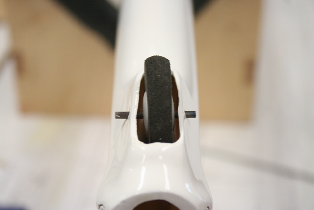

        Used a little dab of epoxy to secure the axel to the fuselage. Click image for larger version

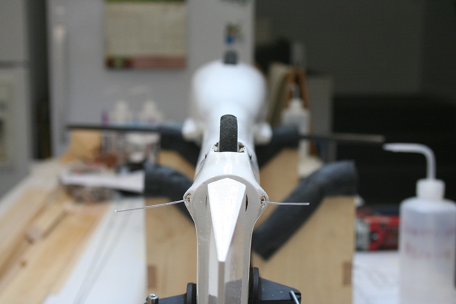

        Next is the rudder.

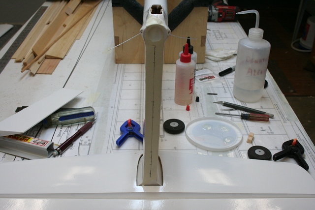

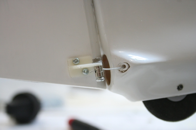

          I found pencil or pen hard to remove from the finish so I covered the tailpost with masking tape and marked the center line. Click image for larger version
          I cut the slots and glued the rudder on using CA hinges. Click image for larger version

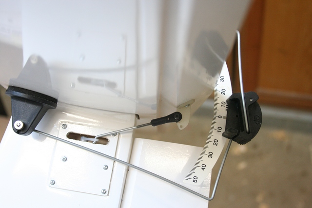

          The rudder is designed to be pull-pull controlled but the solid steel rods that came with the kit would not work. I couldn't even force them through the bends in the tubing. Luckily I had some pull-pull cable and that worked nicely. Click image for larger version

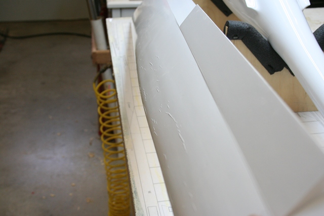

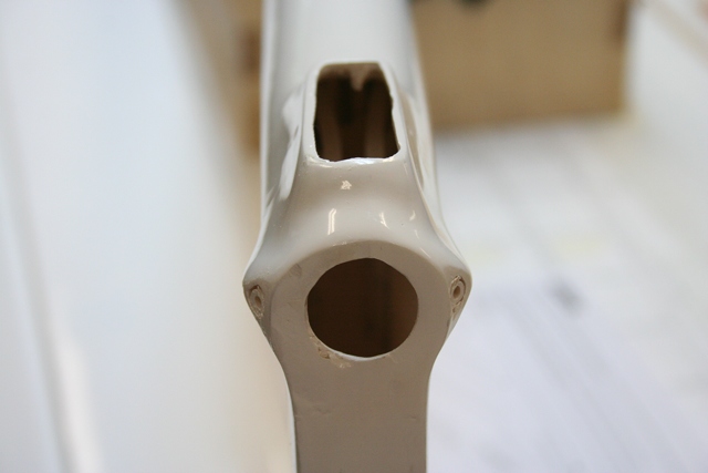

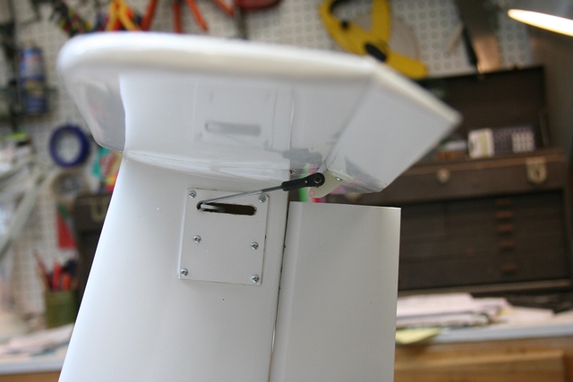

            Like everything else on this model the horizontal stabilizer was crooked. A 1/64" shim on one side took care of it.

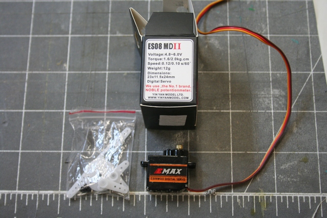

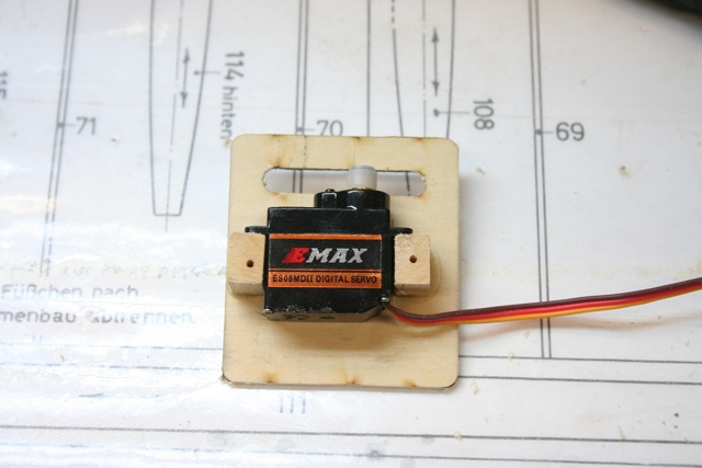

            Ok so this entire project is an exercise in cheap. That includes the servos we ordered from LemonRx.

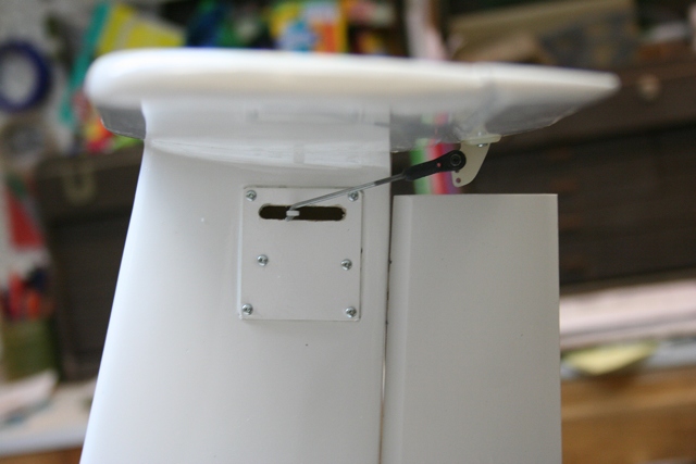

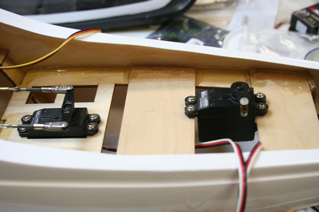

            I mounted the elevator servo the traditional way, on the hatch cover.
            I used a ball link connector for the linkage to make it easy to remove. Had to go to the innermost hole on the horn to get the recommended throw of 20 mm.

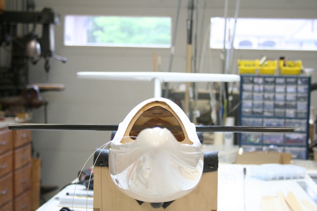

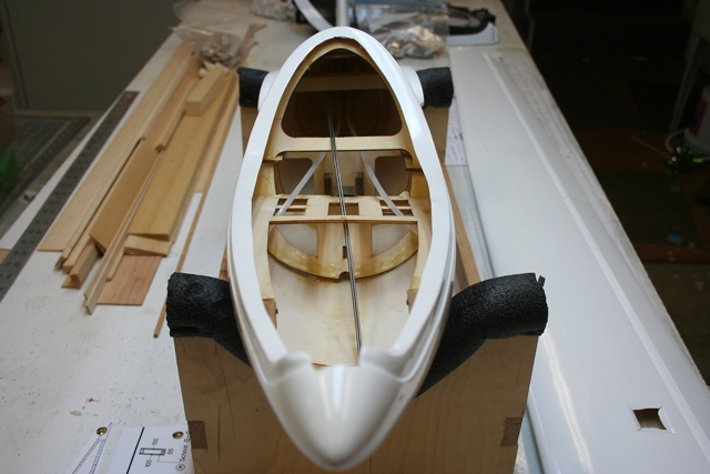

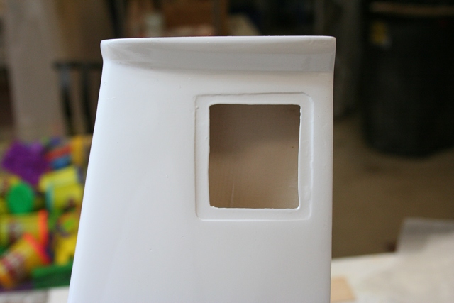

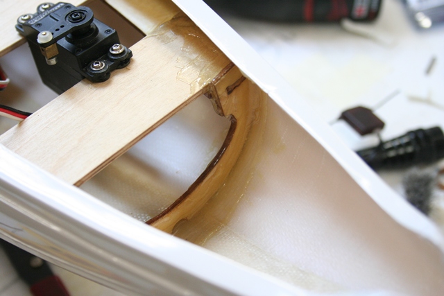

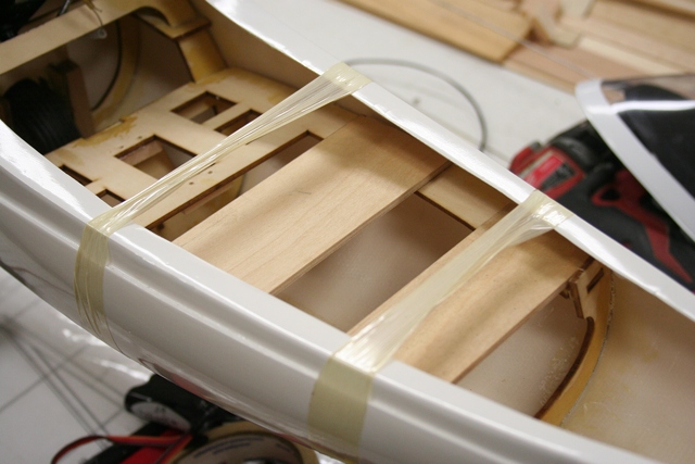

              I checked the canopy fit and found that the fuselage was too wide. This area of the fuselage was very weak and poorly assembled. I removed the front former and radio tray. Then pulled the sides of the fuselage together with some strapping tape. I epoxied the former and tray back in and added some plywood cross pieces for structure and mounting the radio gear.

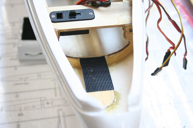

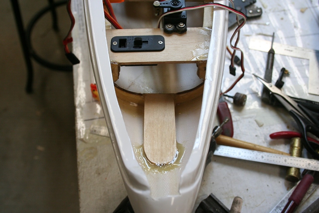

              I added this piece to mount the batteries on.

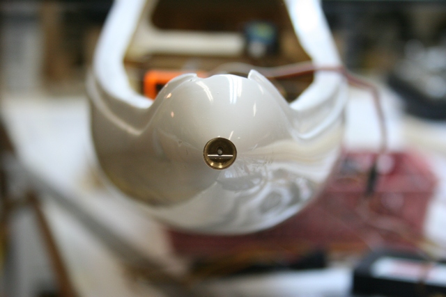

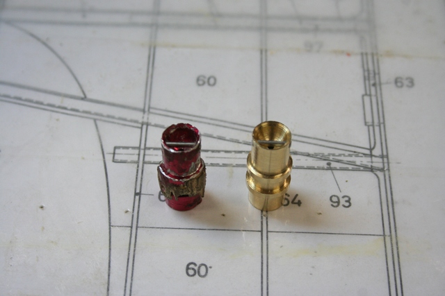

              I have some of these Multiplex tow releases on order, but as usual I was too impatient to wait on them to arrive so I headed over to my sons shop and made one on his lathe. I chose brass for the added weight.

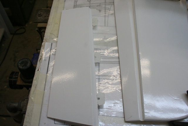

                  The flaps were cut off, turned over and re-hinged (as recommended in the other thread).
                  We left the ailerons alone. They don't go down as far as they go up because of the hinge but that just gave us some built in differential.
