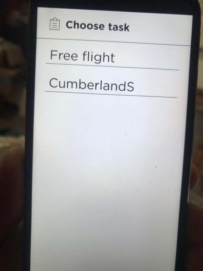

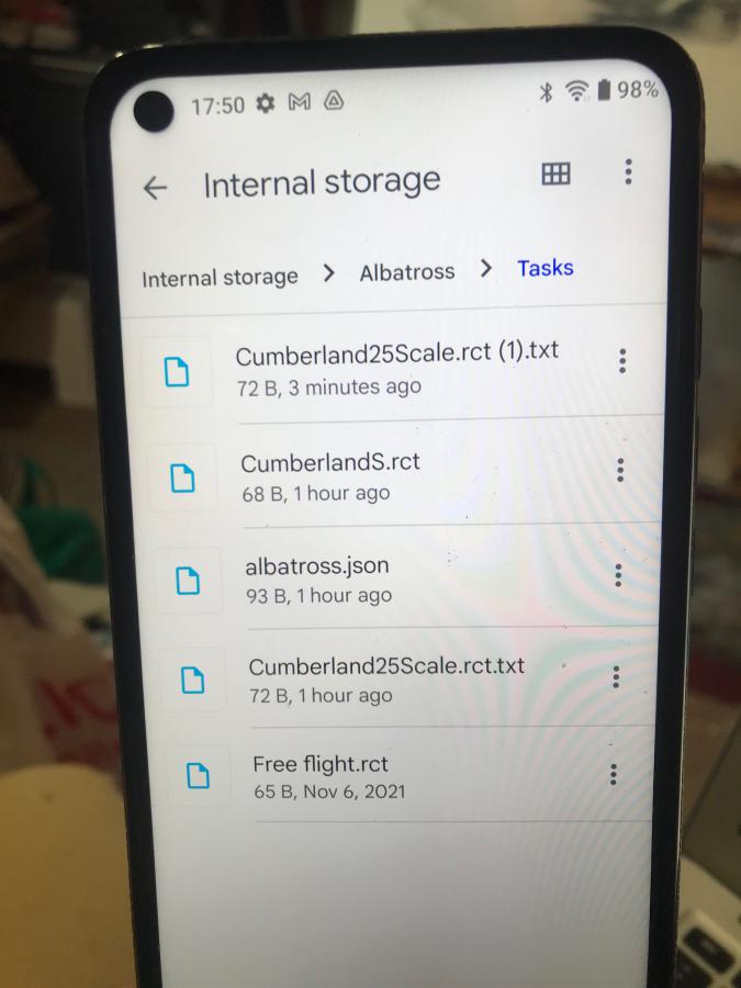

              hey guys...all packed and ready to hit road in am from Boston...long haul. I tried downloading via Kevins video thank you, took a few tries, and first it said to large to down load, but kept trying and I think it went through now. I had last years Cumberland in there, (which Stephane loaded for me). and it was called CumberlandS...is this one also called CumberlandS? There is only one in my tasks and I can't tell if its the new or old one? How can I tell ?
              thanks
                thanks
                Matt,
                this is not the right task for this year, read again the first post
                Scale task is link below
                  thanks Stephane....I see the new one in internal storage >albatross > tasks. but when I open open Albatross app itself, and go to tasks >edit, all I see is the Freeflight and CumberlandS? see attached photos. thanks

                    Hey Matt, the issue is for some reason the task file is downloading as a .txt file instead of a .rct file. If you press the 3 dots next to the file, tap rename, then delete the .txt it should work correctly. It should look like this when you're done.
                    • Csessa
                      Csessa commented
                      This is what happened to me. After cursing for a bit I finally realized the issue and edited the file names. Weird how this happens only on some devices. Anyway, What Kevin said works fine. No harm.
                    thanks Kevin....tried that now, but it says file already in tasks....so deleted all similar, started over and re downloaded, renamed, and still getting message that file is already in tasks? nutty
                      rebooted 3 times and now it has shown up in the app, thanks all! see you at the hill. Matt
