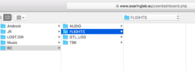

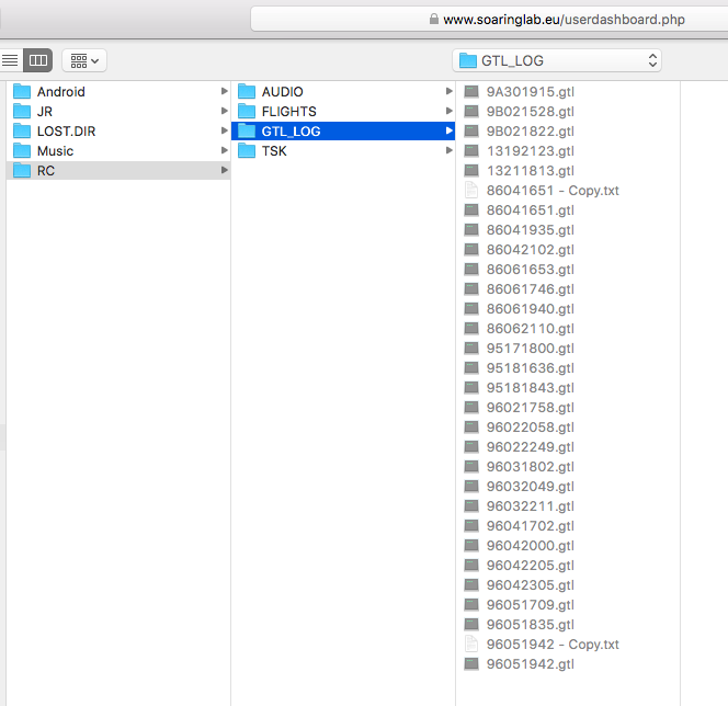

                  Have some flights now on my T3000 at Cumberland and was trying to download the files to the soaring site you tried Stephane to see what they looked like....I plugged the T3000 file into a card reader and plugged it into my laptop...I go to the soaring lab site where I have registered and go to download flights....this opens up to my files and this is what I see below????
                  there are no flights at all in the fight folder ? or anywhere else I can see... or anything called IGC or anything in task folder that looks correct as a flight. etc
                  Please let me know if you can tell what I'm doing wrong....do not see the t3000 flights in my logbook anywhere on the file when on computer

                    Matt,
                    What version of the firmware are you using? if it is not 3.0 (check on the menu of the T3000 INFO), the IGC files are on the onboard unit
                      thanks Stephane...it says under info . FW version 2.2a. and HW version. 2.0
                      So not sure what either of those imply..... so you are saying the files cannot be downloaded then?

                      Also, when I come directly out of the T3000, I see all the folders on the computer, but the flight folder itself has nothing in it. If I come directly out of the Multi 2 Unit in the sailplane, nothing at all even shows up on the computer, not even empty folders.

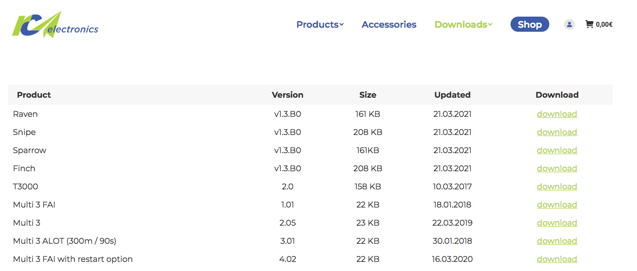

                        Matt,
                        you need an upgrade, follow the link :
                        if you have not that version you won't be able to post result on the website
                        As stated, for your version the IGC file is not in the T3000, you need the V3 version
                          thank you very much Stephane, will update that! I went to the site a few days ago and checked under firmware heading, and it says the latest version is 2.0, ....from the way I understood it in this list, so I was scratching my head a bit. lol
