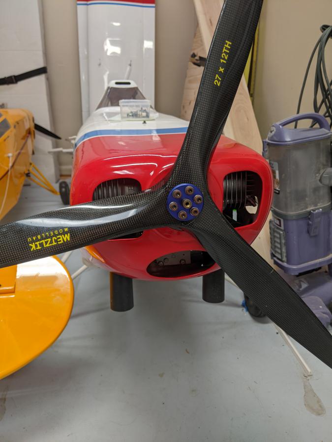

            All the motors will spin the prop in the same direction, so the thrust built into the firewall will be fine. The 130 is a great engine, the only issue is it needs slightly more prop than the 120 and it tends to rip at full throttle. I went with a Mejzlik 3 blade 27x12TH and its not any louder than any of the 2 blades we run.
