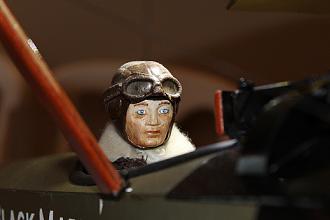

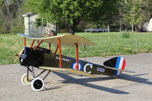

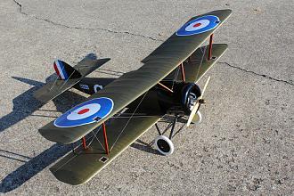

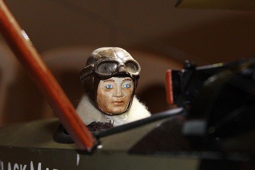

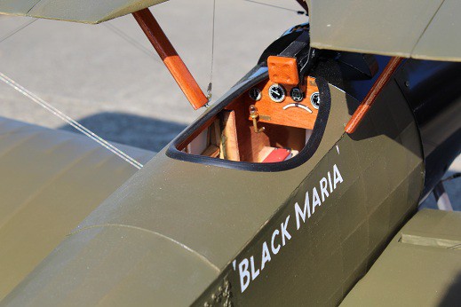

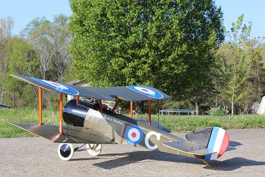

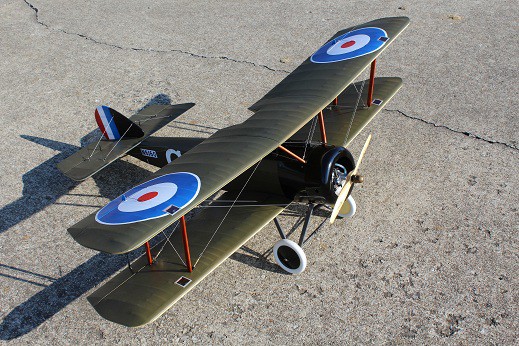

    Dave 'Boddo' Boddington 1:6 scale plan build of a Sopwith 'Pup'. The FG cowl was made (plug-mold-part) by me. Full body pilot. Functional rigging with Proctor turnbuckles all safety wired. Three piece upper wing. Koverall and dope with painted graphics... no crappy vinyl. Raymond Collishaw flew a 'Black Maria' 'Pup' before flying the Sopwith Triplanes of the same name (he had a one gun Tripehound and a two gun Tripehound at his disposal much to the consternation of the German pilots)! He was one bad azz!

    Hope ya like it! I do! lol
    Power? Span? Weight? Prop? Details we all; er, I mean; I would like! Has she been had her 1st flight yet? Did you laser cut all those ribs or did you hand cut them? Oh yeah, very nice! Thanks for sharing.
    Thanks, Mark
      Hi MarkY- thanks for comments! OS40FP from LenB, 54" span, ~4lbs, wooden 10 x 6 prop, no flights...fields closed, what is a laser??? lol I enjoy the whole process: research, drawing or modifying plans, lofting, cutting parts, building, painting, running engines and flying. Well... almost the whole process... because I don't like installing electronics for some reason!

    This transcends being a model airplane, it is a work of art...and Michael, you are a true artist!
      Thank you, Jim! I make sure to cherry pick photos. lol

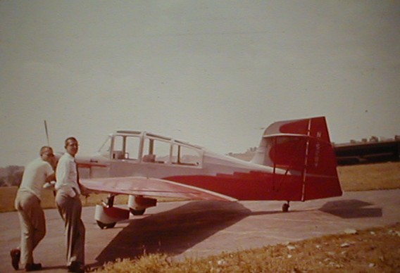

      An old friend gave me this photo, (I would guess from the early 60's- 1960's that is!) he is the fellow on the left. He and his father owned Mount Pleasant/Scottdale Airport in PA. My flight instructor said if you learn to fly at Mt. Pleasant/SD airport you never have to worry about landing off airport. The only flat spot on the airport is the pilots lounge floor, and that was stretching it. A wonderful and magic place! A place where Cubs, Champs, Chiefs, Taylorcrafts, C 120 and 140 still find a resting spot. A place where DC-3's used to visit and a movie star would visit. Jim would say when the movie star landed in his plane the value of the airport more than doubled, haha .
      Jim (my old friend) said four fellows from an aeronautic school landed in this homebuilt that was designed and built at the school. He said it flew quite well. Which proves, in my humble opinion, it doesn't have to look good to fly good. Unfortunately this is the only photo he still had of the plane. Just looking at this photo it appears to me to be short coupled and the vertical stab and rudder is huge. From the shadow of the wing it looks like a tapered wing. Would have been nice to see additional photos from different angles.
      Unfortunately my friend passed away many years ago so I can't pick his brain to see if he remembered any additional info on this plane.
      In conclusion, ARUP's Pup - beautiful, this plane not so much. (Even though I still think all planes are beautiful.)
      Mark
      Mark- great story! Thanks for posting! Yes... looking at the shadow, which appears to be either 10 AM-ish or 2PM-ish, shows it to be pretty short coupled. A large stab and rudder would be needed.
