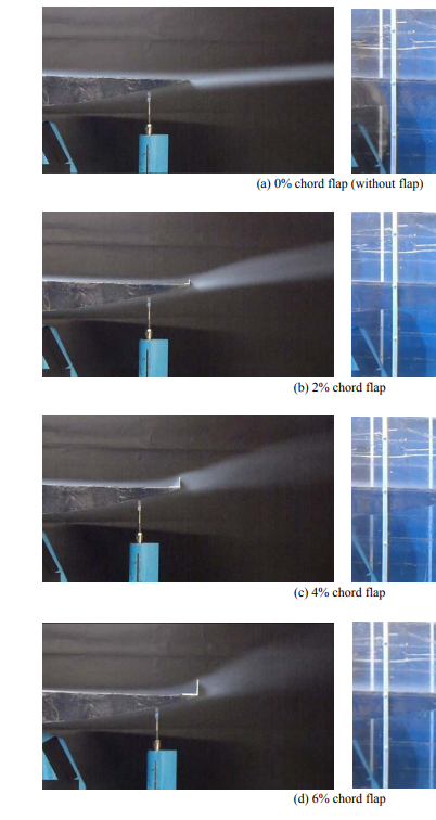

    I have an AMR Trainer 50 that I bolted a big outrunner on and it seems to lose lift right at touchdown sometimes, maybe due to lack of thrust at zero throttle? I'm thinking Gurney flaps will help, and prevent me from having to leave a little power in, so I bolted on some as an experiment for the next time I get the tug out to the field. Seems like most of the wind tunnel experiments that I read used flaps in the 2% of chord range so I went with 1/2" flaps on my 24" chord wing and they extend from the root area to about 2/3's span. I had reduced ailerons to 1/3 span on a previous modification. Hopefully it makes the plane fairly fool proof. It already flies great but I'd like it to fly a few mph slower before full stall. Maybe a CG change would help too but I always wanted to experiment with Gurney flaps so we'll find out soon.

      Thanks. I'm right on the spar but I also put a lifting horizontal stab on her at some point so no telling where the CG should be. I'll move some batteries around after I try this experiment. Found some real time photos of GF effects on an airfoil. Pretty neat visualization.
        If the 2% Gurney flaps slowed the stall down, it wasn't by enough to offset the side effect of increased apparent incidence. I had to dial in quite a bit of down elevator to compensate, and the plane needed more and more down trim with increased power. Might be time to build some new hinges and put the big fowler flaps back on. I removed them before converting the plane to electric because the hinges weren't strong enough for the vibration of an 80cc ZDZ single. Landings were so fun with those things at full droop.
