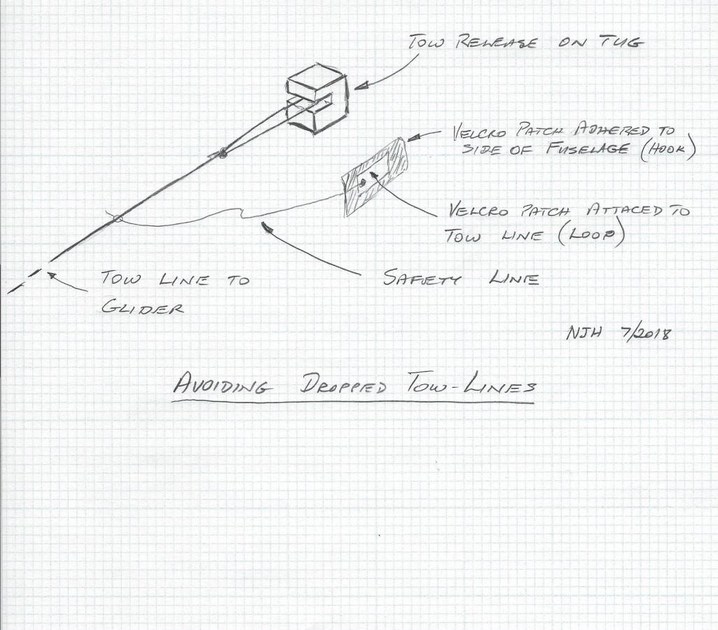

          The "dropped tow-lines" that I have witnessed - including a couple I dropped were the phat-phinger type that Lenb mentioned above. Something like the release switch was flipped when the pilot meant to flip the flap switch. This is a great forum thread as it has made us brainstorm the issue. Here's an idea to kick around (sketch attached): Tie a safety line to the main tow-line, just down from the tug release. The other end of the safety line is firmly attached to a strip of Velcro (loop surface). The opposite Velcro (hook surface) is adhered to the fuselage.
          In an emergency release situation, the tug pilot releases as normal; the Velcro patch is small enough to let go under the load of the glider.
          However after a normal glider release, if the tug pilot mistakenly hits the release switch, the Velcro patch is strong enough to hold onto the tow-line.
          It will take experimentation to get the right Velcro patch size.
          Thoughts?

              A good idea, but I think the initial pull of the line will require a large patch of Velcro to keep the line with the plane, and when the situation happens with a glider on the end of the line the pull of a large piece of Velcro could rip the covering of the tow plane if its not composite! Just my 2 cents

                Jeremy- If the tow pilot accidentally releases then the line will come 'unstuck' from the hook and loop patch. If that occurs then the sailplane pilot should NOT release and should only attempt to drop the line over the field or just land with it. As Noel has stated, some experimentation will be required to see how large a patch is required to keep the tow line from falling away when it doesn't have a sailplane attached to the other end.
                There is always a possibility that the patch size needed to retain the tow line may pull covering off the tow plane.

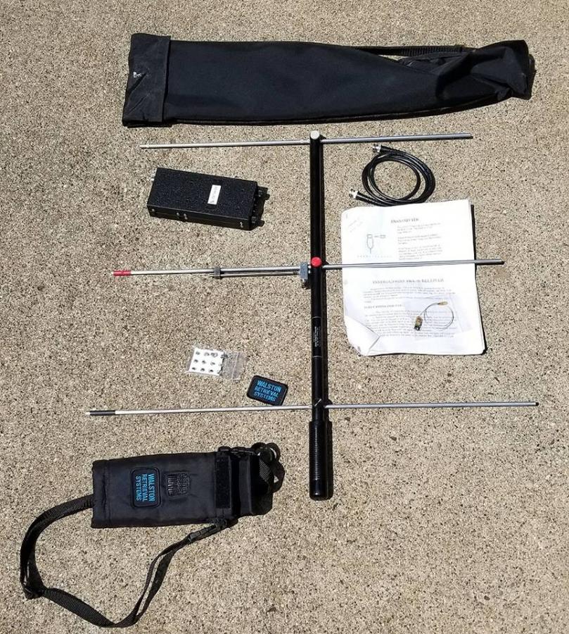

              A complete system just came up for sale on one of the freeflight Facebook pages. It's being offered by one of the kit manufacturers if you don't have Facebook so you can contact them through the website I would imagine.
              FOR SALE - $350 SHIPPED*
              Older Walston Retrieval System from Stu Weckerly's estate. Includes a 3-channel receiver and a single 3-gram transmitter.
              Includes fresh AAA batteries (8 total) and OLD #317 transmitter batteries (suitable for TESTING ONLY). Also includes carrying cases (as shown) and instructions.
              This unit works and served Stu well. It still works - tested yesterday. The clip on the receiver case is broken and repaired, but should be replaced.
              This is a great price - priced to sell. SELLING FOR THE CLOUDBUSTERS CLUB. * - NOTE: free shipping in the US only. Payment via PayPal preferred.
              https://www.facebook.com/VolareProdu...37231176391963
