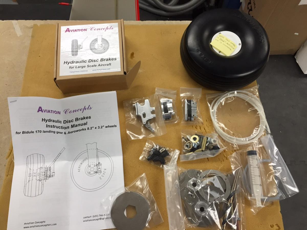

    I'm really excited to show a new product that was introduced at the Wram' s show this weekend. It's really Gunny's story to tell, but Jim received a prototype set a month ago and spilled the beans to me, so I ordered a set a few weeks ago and picked them up at the show.
    All I can say is WOW.
    Back tracking the story a bit, the Bidule 170 with its big motor and prop spinning up front is sometimes a challenge to get to stop where you want it. Especially if you have bearings in the wheels. When waiting for the glider to hook up, you need to idle down as much as possible, but then the plane will shake from vibration if you go too low on the idle. MANY times I'd mutter, I wish this think had a parking brake.
    Well, Jim uttered the same thing to Gunny one day about the Decathlon, and with Gunny being a brilliant mind, set out to find a solution.
    The result is a beautiful hydraulic brake set. Fully proportional, you can set it to a switch for predetermined braking or a slider for a proportional braking action.
    I'll let Gunny or Jim jump on with more details, but I opened my box up today and couldn't wait to share this cool "MUST HAVE" with all the Bidule or big tug drivers out there.
    For more info, pricing and event test VIDEOS------- check out http://www.aviationconceptsrc.com/hydraulic-disc-brakes

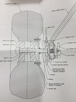

    Here are the pictures from my set. They're fitted to Aeroworks Carbon Cub wheels, but any wheels can be fitted.

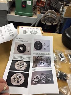

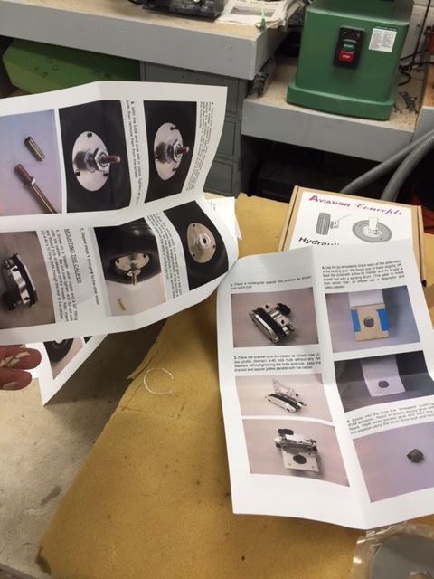

    Over the top detailed instructions. Lots of pictures, even my cat could put these on the plane.

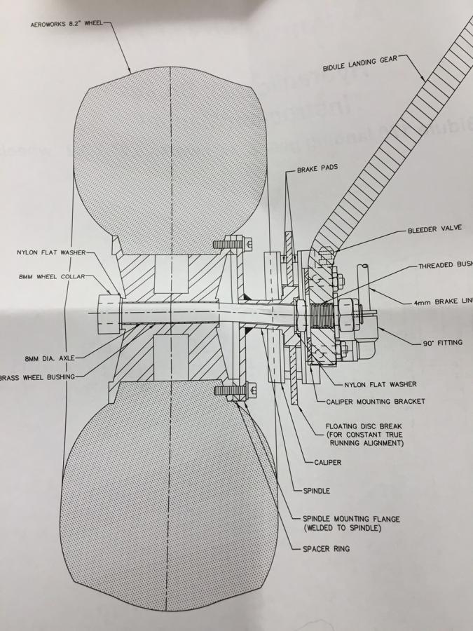

                    The brakes are designed to mount on flat plate gear. The problem with wire gear set up is that the axle needs to be extended and the caliper mounting plate has nothing to mount to. The brakes are recomended for 1/3 scale and up. the 3.2 meter porter just does not need them and they would be physically too large for the gear/wheels.
                    The only way to get them to work on the Porter or Pawnee (another persons request) would be to send me the complete landing gear and wheels and then I could design something to fabricate / modify and manufacture and have TIG welded parts added to the gear. This would /could be cutting the axle completly off and have a thick wall steel tubing stub welded with a set screw holding on a new longer axle and a thin steel mounting plate welded to the stub. This is only a theory right now.
                    The easiest way to get them to work on the 5.2 meter Porter would be to put on a plate landing gear like the Hanger 9 Decathelon.
