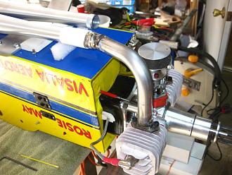

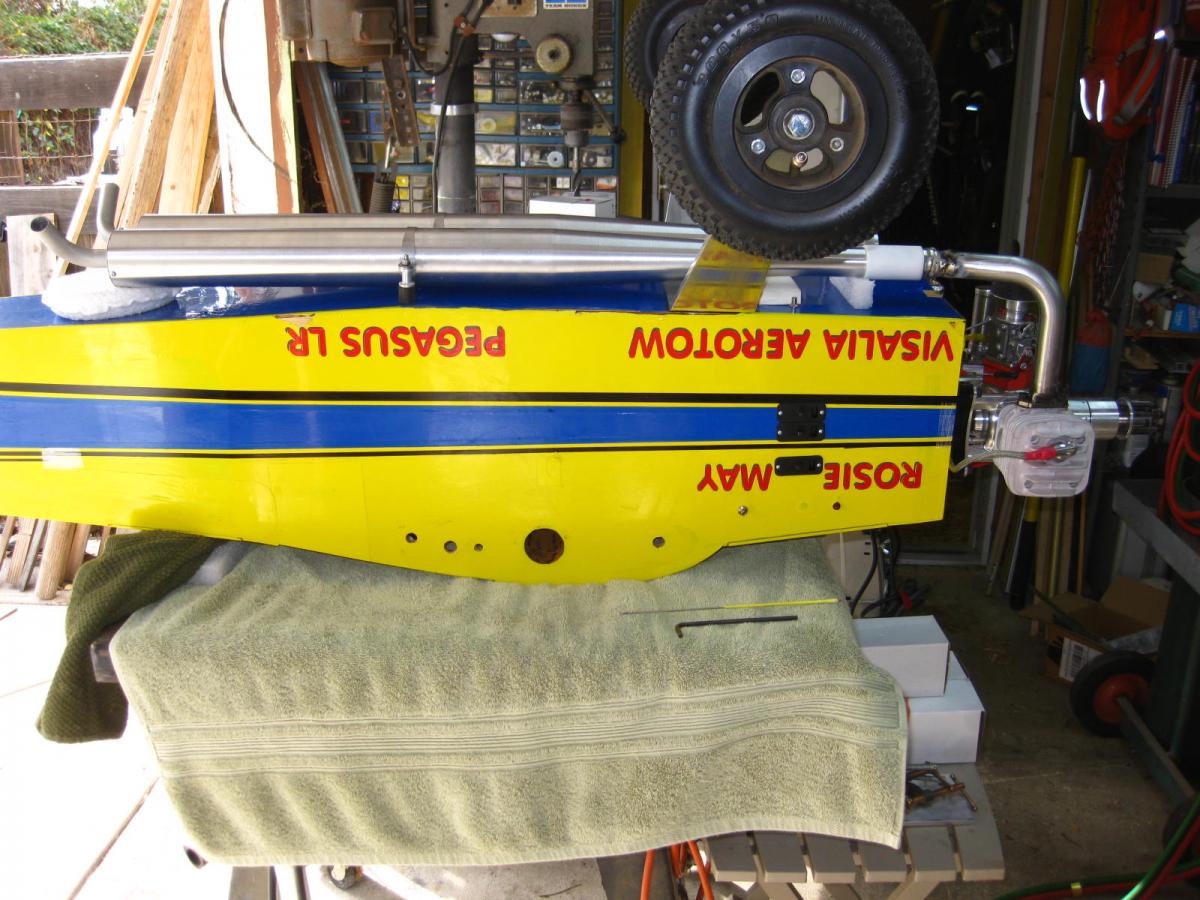

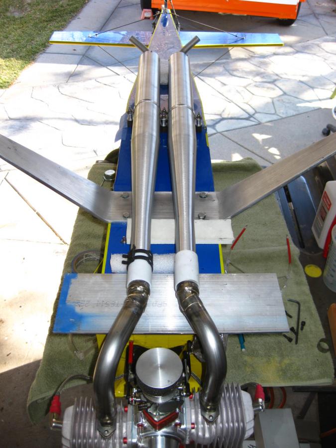

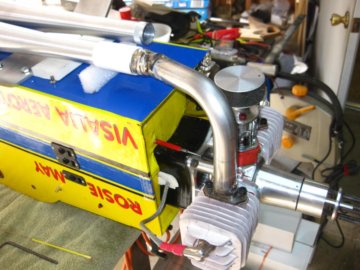

    One of my winter projects was to add MVVS tuned pipes to John Wilson's Pegasus Tow Plane in an effort to change it's "audible profile"
    Using KS exhaust stubs and tubing, I did have to adapt the 25mm OD tubing to the 28mm OD inlet to the MVVS tuned pipes. I found that the flexible metal tuning has the same OD and the ID of their 28mm connector tubing (flared part) so all I needed was an excessive amount of silver solder to fill the void. Finally got the Acetylene torch gas flow setting down so I wasn't over heating the tubing/solder... Of course, the aluminum plate is in place to avoid torching the covering/Airplane while I tack the tubing in-place.....

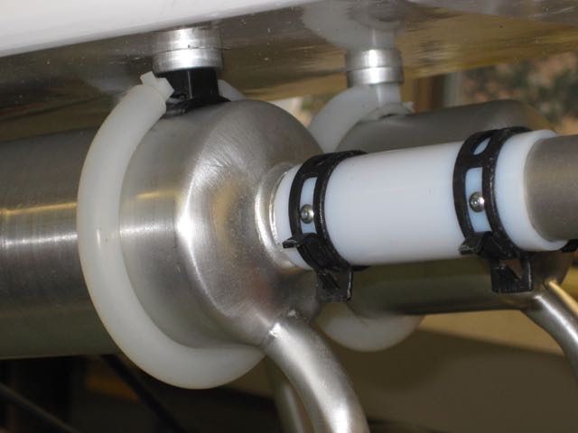

          We had that problem to, a quick solution for us was to drill a hole and install a fat pan head screw into each pipe, then put the clamp over it.
