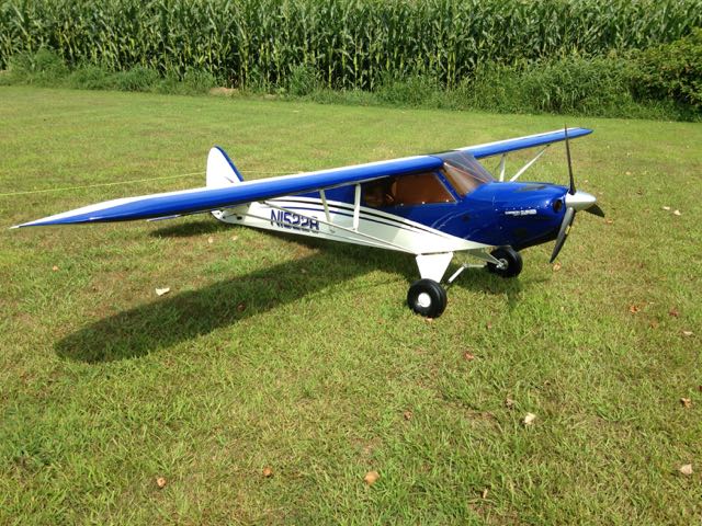

      The Aeroworks Carbon Cub was also a very good tow plane, for that matter, its a very good plane in general. Powerful, scale, GREAT flight characteristics and lands like a dream. The downside is its expensive and the gear is a bit fragile. Of course if you land easy its not a problem. ( just try to do 150 landings in a weekend and not get one bummer )

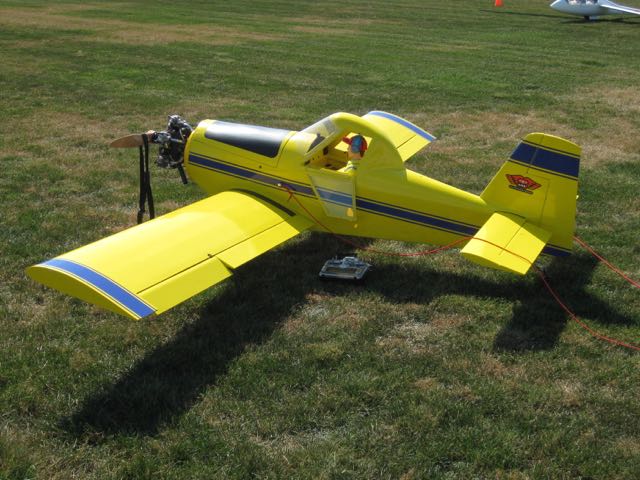

      Pawnees are just cool.. Albeit real draggy. Power it with a 120 and it will pull pretty well. ( I have a 100cc on mine and its OK )

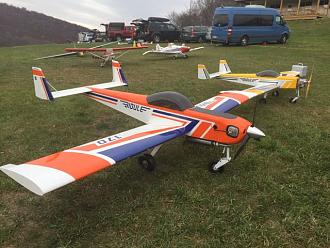

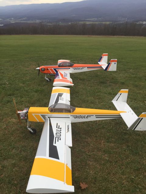

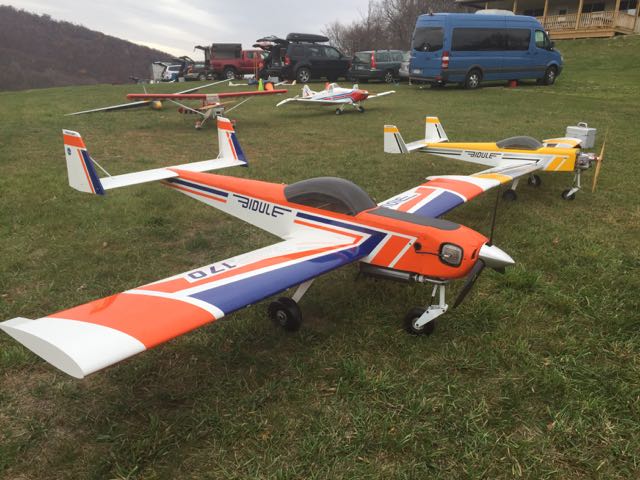

      In my opinion the Bidule is the best tow plane out of all of them, unfortunately its not scale, but it does resemble an Aircoup!
      Having 85 hrs on the Bidule in since The middle of July, I can tell you its predictable, stable, and the best for windy or calm conditions. Due to the dual rudders it handles the wind perfectly and will yaw instead of roll. The nose wheel allows the pilot to relax a bit after each touchdown, not fighting the tail wheel. Over the course of a long day that really helps out. Available in 170, 111 and 55 cc versions.
      Miss Tractor, good flying tug, 85cc version will tow pretty large planes due to the low drag design..
      Another excellent tug is the Payload Master from AMR. Its a KIT built plane and flies fantastic. The landings are a blast.
      Having flown Porters, Decathlons, Pawnee's, Peg's, Cub's and quite a few others, I would fly any of the above again without hesitation but prefer the Bidule's.

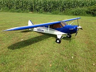

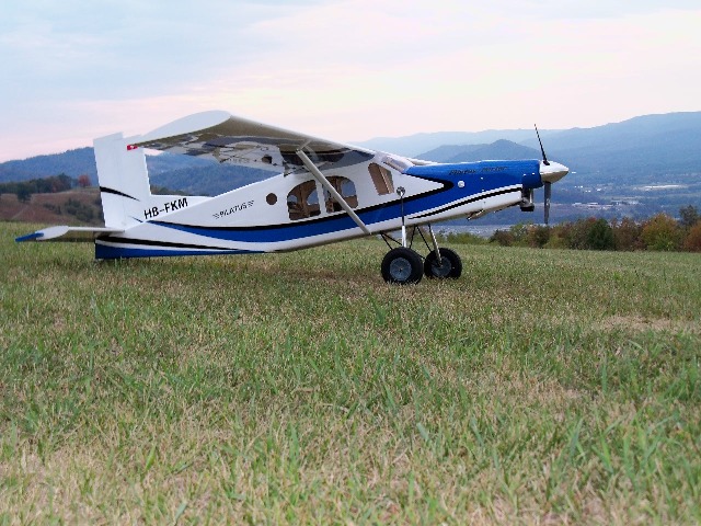

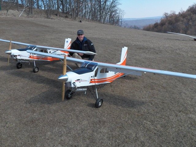

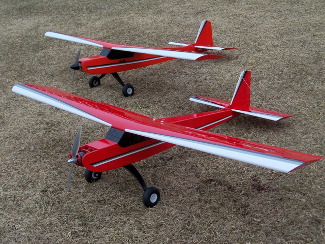

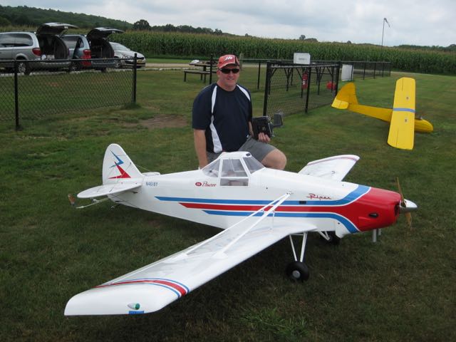

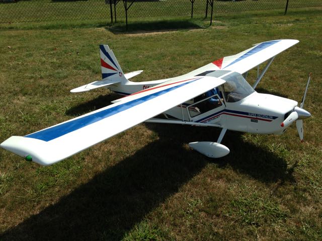

        A few more photo's
ID:	6242 Click image for larger version
ID:	6243 Click image for larger version
ID:	6244 Click image for larger version
ID:	6245 Click image for larger version
ID:	6246 Click image for larger version

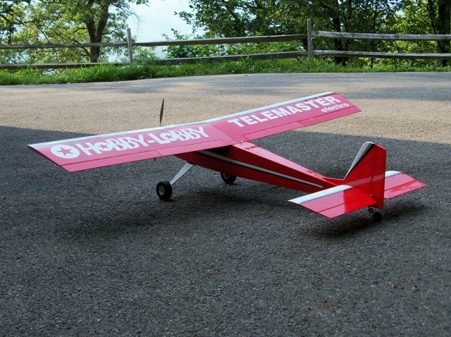

              2011 Hobby Lobby Telemaster Electro with Rimfire .80 motor on 6s
Name:	Telemaster Electro.JPG

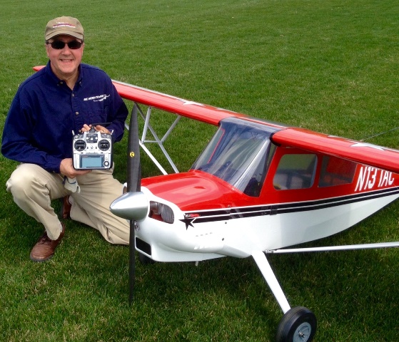

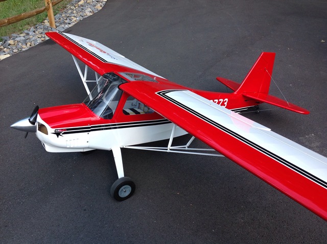

              2013 Hangar 9 36% Super Decathlon with DA-120 gas engine

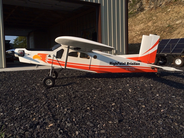

              2014 TopModel 3.3M Porter #3 with DA-120 gas engine
              2014 Hangar 9 36% Super Decathlon with DA-120 gas engine

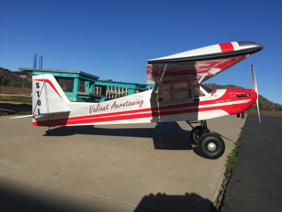

                    Hangar 9 Valiant
                    http://www.hangar-9.com/Products/Def...ProdID=HAN5060
                    SPECS FROM THE HORIZON SITE
                    Wingspan: 108.3 in (275 cm) Overall Length: 78.2 in (199 cm) Wing Area: 1663.0 sq. in. (107.3 sq. dm.) Flying Weight: 16.5 - 17.5 lb ( 7.48 - 7.94 kg)
                      Fix a couple things and added link.
                      How do you like the plane? Haven't seen one towing yet although it looks like a great platform
                        Thanks Len, As far as a Tug, You wont find a better one in its size. I routinely tow anything from a ParkZone KA-6 to 6.7m glass ships. Even towed Dan's 50% Hemple KA-6 once, but not very high....lol. Ive flown the BH 40% Decathalon, H9 Pawnee and various others. The Valiant is the best behaved and easiest flying Tug (and towing) Ive ever flown in my 35 yrs in this hobby.
                        And if I could fing the guys at H9 that designed this plane I would give them a big ol hug. The Valiant is the best behaved plane and encompasses everything Ive ever wanted in a STOL Bushplane / Towplane combo.
                          Nice video. What engine are you using in the Valiant?
                            Hi Steve, Im using the DLE-40 twin turning a Zoar WW2 20x8 prop at 7500rpm.
