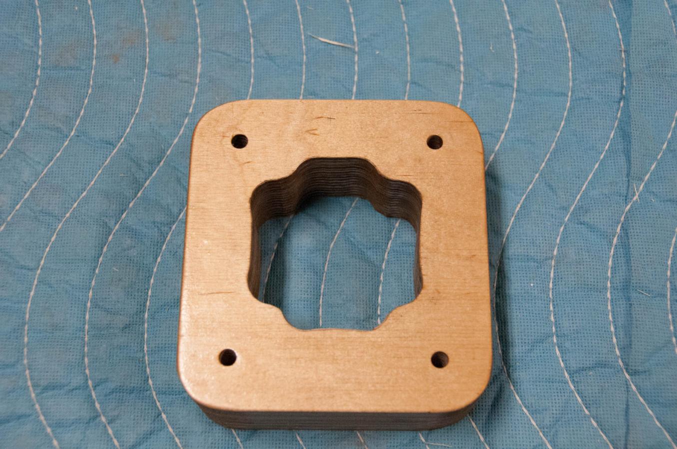

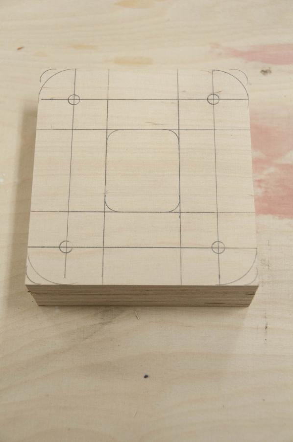

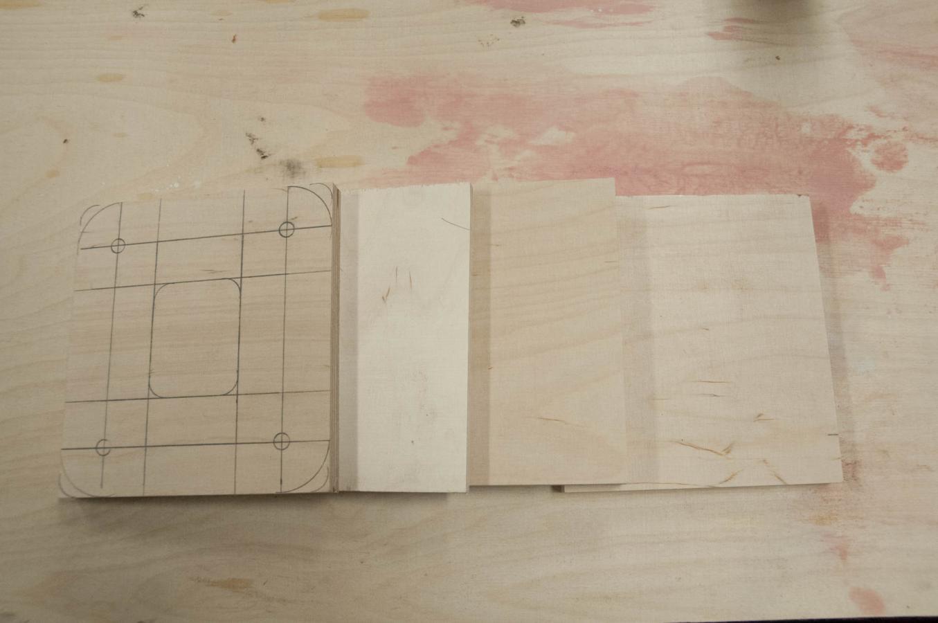

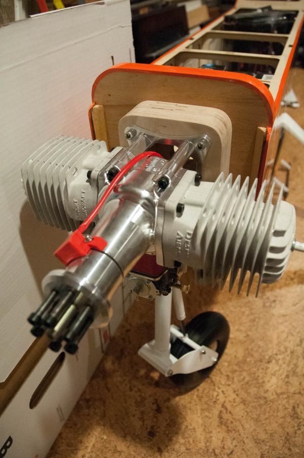

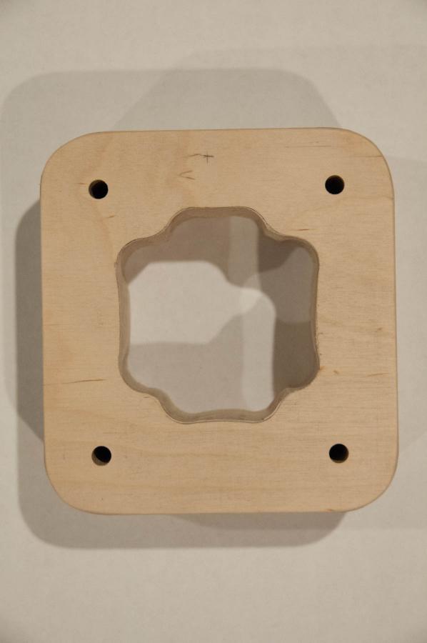

        I worked on a plywood standoff for the DA 170 yesterday and today. I think this is going to work well.

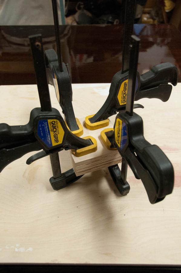

        It is a set of 3 layers of 1/2" aircraft grade ply with an additional layer of 1/4" aircraft grade ply sandwiched between the others.
        The layers were cut on the tables to the outside dimension plus about 1/16" extra that is trimmed after glued.

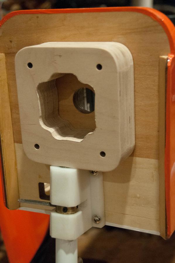

        I used West Systems resin for the task and clamped the layers until set. Afterward I trimmed the block and drilled and cleaned up the inner space.

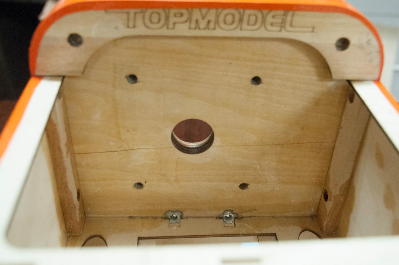

        The mount fits the firewall well. From here it will be attached to the firewall with resin and then fully coated with thinned resin to seal it from fuel.
        The DA 170 is test mounted to make sure everything fits properly. So far so good.

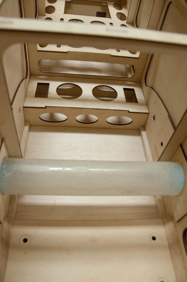

        Tomorrow I start the internal reinforcements on the fuselage with hardwood stock and balsa tri stock.
        I should be about ready to start working on the rest of the airframe (tail and wing panels) as well as staring the installation of electronics very soon. Hope to have this one flying in about 2 weeks at the most.

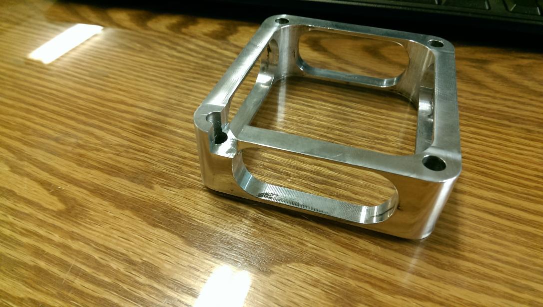

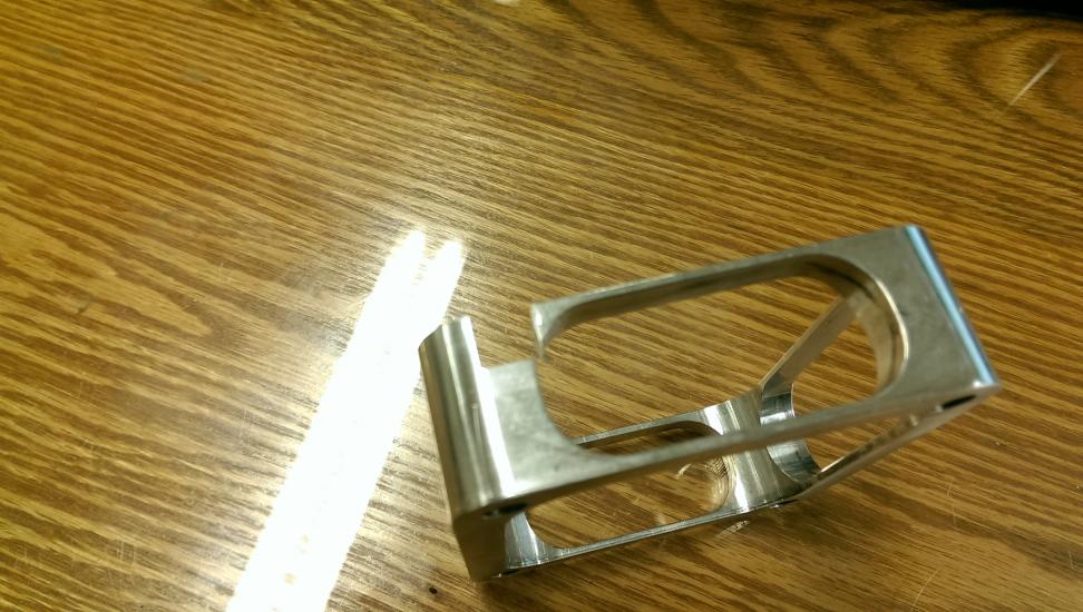

                  Working away on the Bidule here. I just got an email form the person machining the mount for the DA 170. He had a slip and accidentally left the feed running and cut through the mount in one of the corners. He has been very helpful to work with though and is making the replacement mount and shipping tomorrow.
                  Here is what it is going to look like (without being milled through though):

                  The mount should save weight in the nose, which from Len's build looks like a good thing to do (I think Len had to add some weight to the tail for his final balance..
                  The other thing I really like about this mount is the ability for air to flow around the engine from the rear. Having the metal machined out helps with this, yet the strength is still there with the corner piers being connected to each other.

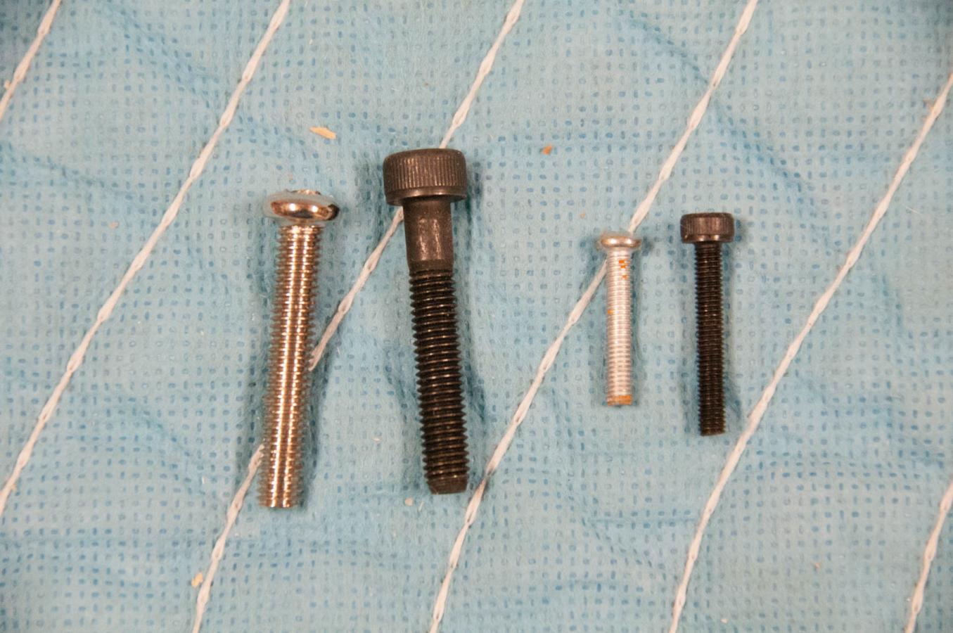

                    I looked at the hardware and the screws/bolts are all phillips head. I thought it would be better to use hex screws instead. These will be used for the landing gear (nose and main), the tow release block, and also the engine mount.

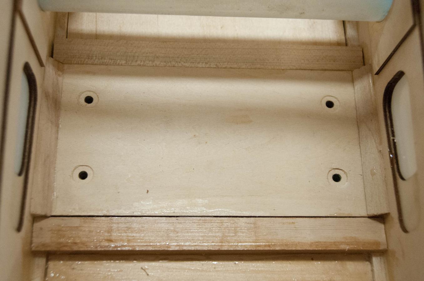

                    In talking with Len he showed me how he reinforced the bottom of the fuselage for the canister mounts. One of the things he suggested was to use full ply plates instead of individual reinforcement points.
                    I made plates that fit inside the fuselage and then put them in place with resin. This should strengthen the attachment of the canisters. I will be using KS Comfort Mount clamps that have silicone tubing on them for the mounting system. There will be 2 rings for each canister to help prevent movement of the canister and reduce the chance the header will break due to stress.

                    The plate just after the wing tube is balsa. I then placed the plywood on top of this in 3 locations:
