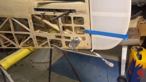

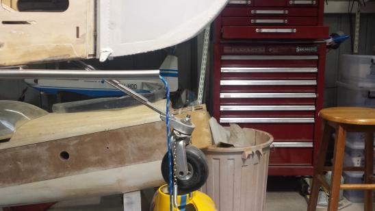

ID:	5495 [ATTACH=CONFIG]n5496[/ATTACH] [ATTACH=CONFIG]n5497[/ATTACH] some of the changes include sheeting the forward fuse in 1mm ply sides sheeting the bottom in 1.5mm ply glueing the front to the rear of the fuse, new undercarriage made from aircraft grade chrome olley tubing with stainless hinge mounts, a new redesigned tow release, cast alloy tail wheel assembly with custom leafe spring and mount. the rear fuse has 9.5x9.5mm balsa sriffeners added to tgw sides of the fuse behind the pky diagonals with diagonal trussing accross the fuse to stiffen the rear fuse. The turtle decks have all been fibre glassed in 3oz S glass to stabilise the turtle decks (crappy foam) then there is the redesigned and new 1" thick ply carbon laminated firewall with 1" diameter dowls between the new and old.and the 3mm ply doublers over the engi e box which is glued and dowled through the structure to tie things together upfront. loads of work but easy stuff, just time consuming.

              Here you go Larry. I've opened up the first wing for refinishing and have now glassed the sheeted areas and overlapped the cap strip joints. from what I can tell Bill has done a pretty good job with the wings and have nice timber spars in the wings. for longevity Ive fibreglassed the wings and will be fabric covering the open bays in fabric. my choice is Polyfibre lite applied with shrinking dope.
