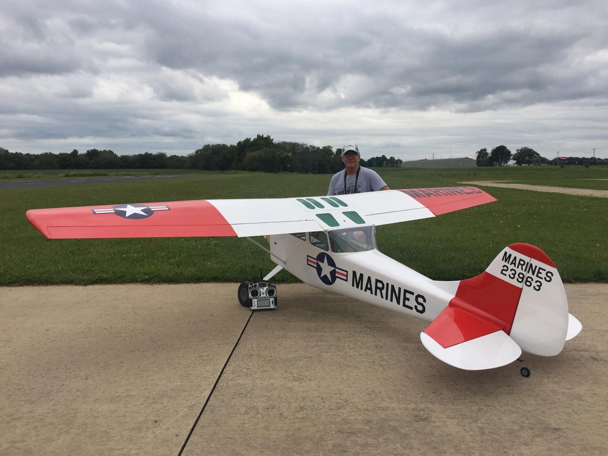

The primary reason for the Bird Dog was the form factor allows for internal canisters. Although the Smelly is a awesome design it’s very difficult to hide canisters inside the fuse. As more fields become noise sensitive it’s important that I try to incorporate canisters in my tow plane designs. Additionally a high wing design is less affected by the Sailplane in pitch due to the tow location. Being closer to the center of pressure.
1.3 scale L-19
 Success , flys wonderful, soo happy. I love it when a plan works out. Thanks everybody for all the encouragement along the journey.
 Model Specs.
 1:3 Scale L-19 Bird Dog
 Span 143â€
 Length 108â€
 Weight 47.2lbs
 DX18 TX
 Spektrum Powersafe receiver SPMAR12310
 Gyro Spektrum AS3000
 Servos Spektrum 6320’s
 Batteries:
 Spektrum Li-Po Smart batteries 2 x 5000
 Spektrum 4000mah Life (for ignition)
 Engine DA150
 MTW Cans
 Prop Falcon 30 x 12â€
