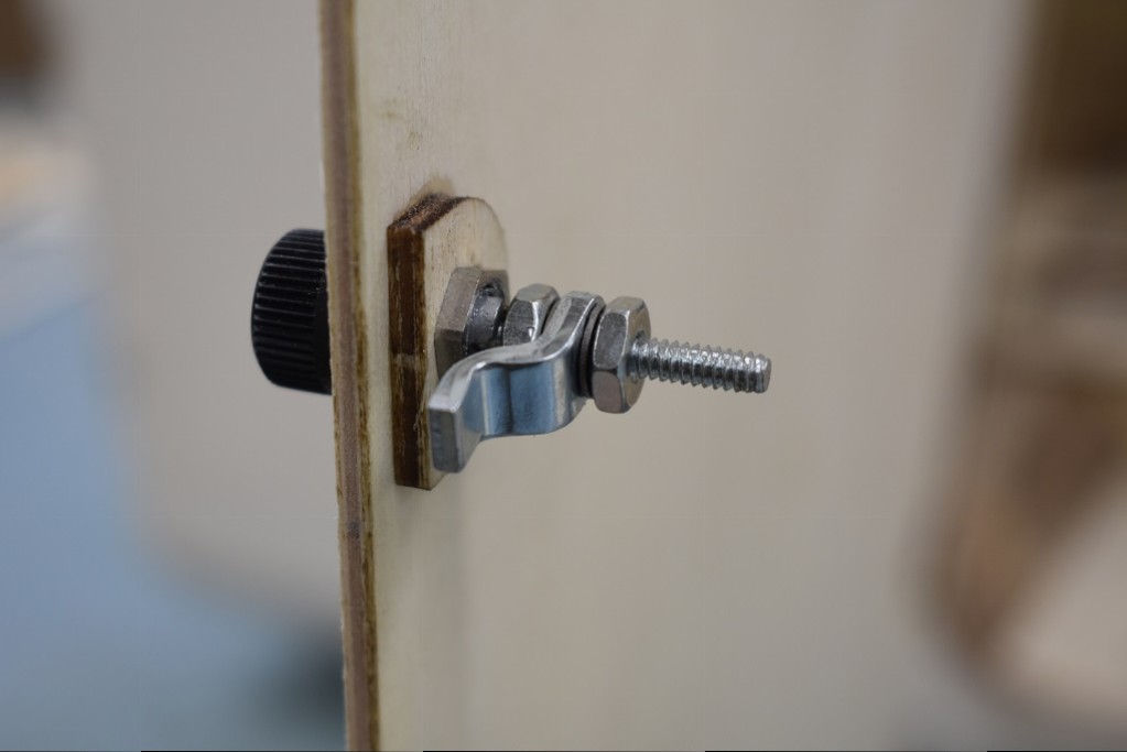

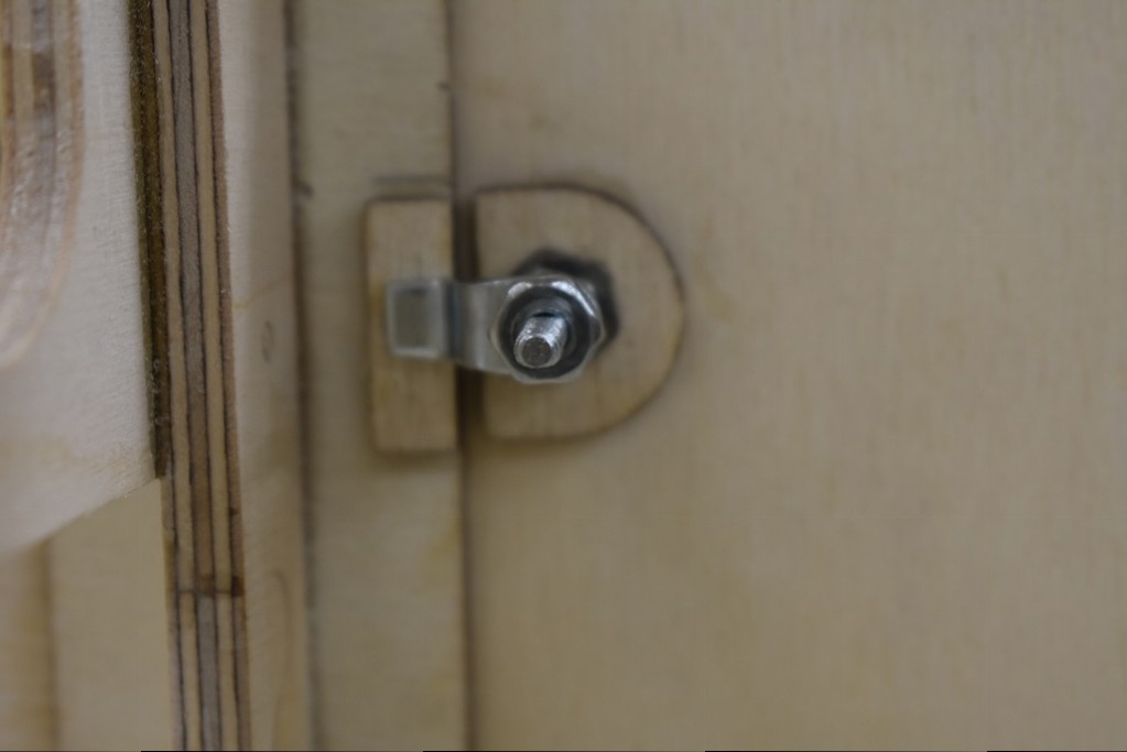

    Maybe this can work for you. McMaster Carr knob latch cam #1702A39

          Thanks guys! Lot's of options to ponder. Size will be the limiter. The plate in which the current blind nut resides is not much bigger than a half inch wide.
