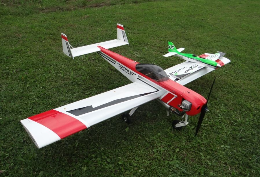

    Hello,
    here's my Bidule (didn't find 55's topic here)
    MVVS 58cc engine biela 22'' 3 blade and Falcon 24'' props
    Click image for larger version  Name:	Bidule.JPG Views:	3 Size:	165.4 KB ID:	32246
    already did the main landing gear mod,
    but the rest of it seems ok.
    do you have some tips for towing (many I see online are for foamies both towing and glider plane)
    glider seems to overtake me in turning point (like slingshot)
    My maiden tow was 5 meter glider around 33 pounds, adrenaline rush for both of pilots
