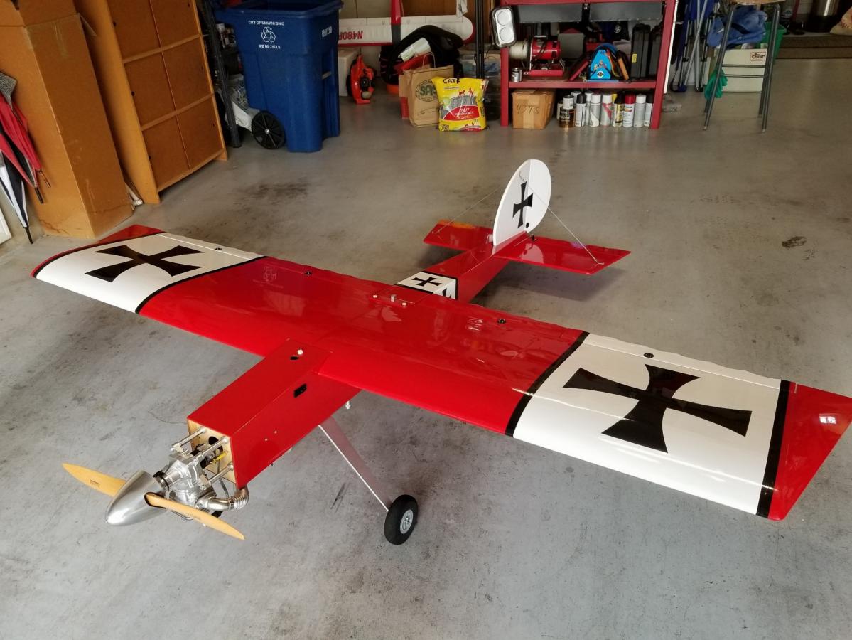

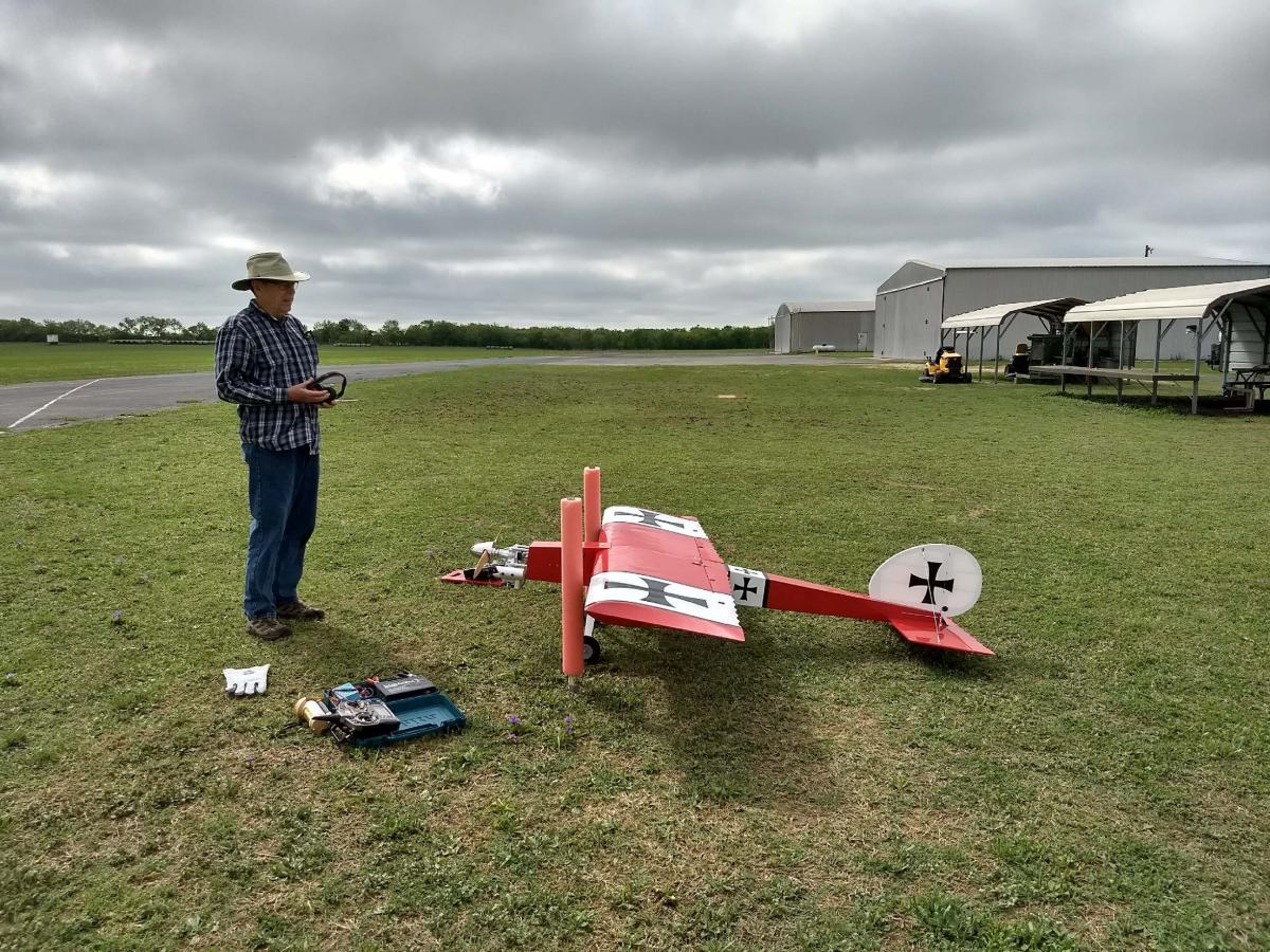

    We were pleasantly surprised at the high quality of the Giant Stik kit. The covering was nice and tight with only a few wrinkles to iron out. The firewall to fuselage joint was already reinforced with metal angle braces and the main landing gear attachment was solid plywood. No additional fuselage reinforcing was judged to be necessary. We figured that we would be swapping out all the hardware but the materials supplied with the kit were plenty adequate.
    Our only concern with the basic design of the Stik was its spindly landing gear. So far, with around 30 landings, the gear is holding up fine but it has not as yet been tested. Our tow pilots have greased in every landing. Whether the gear can survive an "oops" landing won't be known until we actually have one. We have the advantage of a large, smooth grass runway which should be easy on the gear otherwise.
Name:	20180412_105115 landing gear.jpg

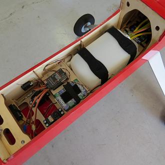

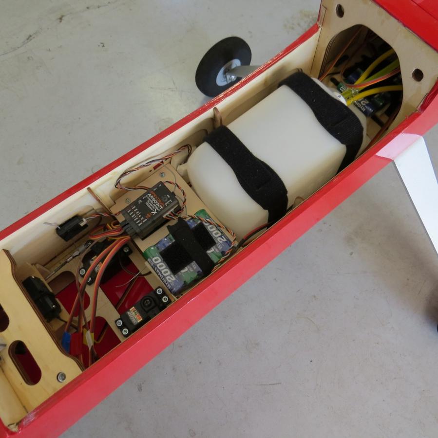

      Three changes were made to the Stik to turn it into a tow plane. First, some of the light plywood on the floor of the fuselage was removed so that a 32 oz fuel tank could be installed at the airplane CG. A 1/8 inch plywood shelf was added at the rear of the tank to keep the tank from sliding aft and to serve as a mount for the receiver and battery. A couple of 1/8 ply braces were also installed across the fuselage below the tank to restore any strength that might have been lost when the original light ply was removed.
Name:	IMG_2843 resize.jpg

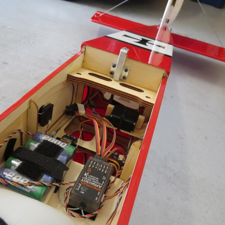

        Next, a tow release was installed on the bulkhead at the wing trailing edge. A shelf was built above the rudder control rod to accommodate the tow release servo. The bulkhead was reinforced on its backside with an additional layer of plywood.
Name:	IMG_2844 resize.jpg

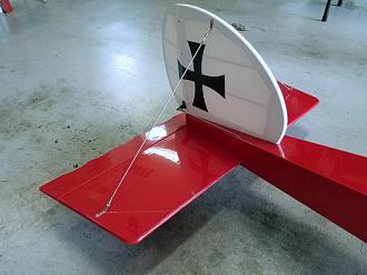

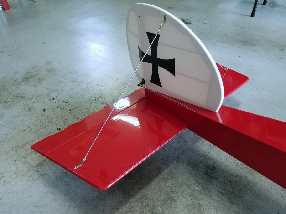

          The final change was to install braces on the vertical tail to ensure that the tow line could not become entangled on the rudder and elevator control horns.
Name:	20180412_105131 resize.jpg

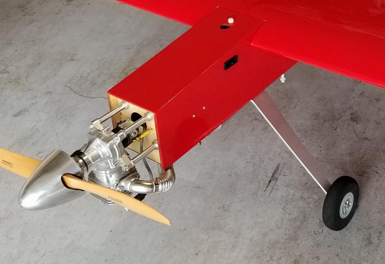

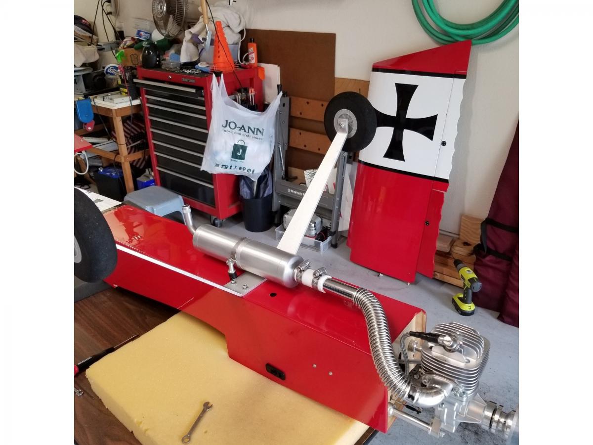

            Our initial flight testing and first aero tow were flown with the standard DLE muffler. While this nicely diverted the exhaust gunk downward, it didn't do much to reduce the engine noise. So the first upgrade to Stik was to install a 65 cc K&S canister. With this addition, we hope that the Stik is in its final configuration.
Name:	20180412_104523 flip and resize left.jpg

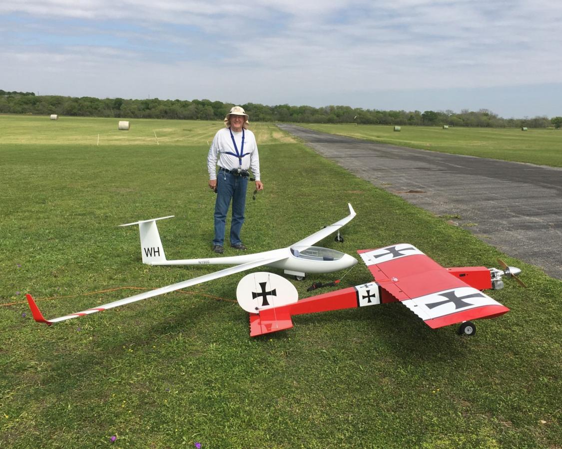

                              The HOTTS club's experience using the Giant Big Stik as a tow plane continues to be very positive. We flew four trouble free aerotows last year using the Stik as our only tow plane. No maintenance was needed over the winter to ready it for this year.
                              In addition to the Stik’s dependability, we have been surprised at its pulling performance. Jaded by our exposure to the 150 cc behemoths at the major events, we assumed that our little 61cc DLE would struggle to tow a sailplane as big as the Horizon ASW20 (4.7 meters and 19 pounds). But that was not true at all. The ASW and other similar sized sailplanes went up easily reaching release altitude after a single turn to bring the sailplane back over the center of the field. The performance was so good that we suspected that the Stik’s ultimate capability was much higher. And that has turned out to be true.
                              This past week the Stik increased its towing envelope into the super sailplane category by successfully towing a 1/3 scale Baudis Antares. The Antares is 6.6 meters and 28.6 pounds of absolutely gorgeous sailplane. The Stik lifted it off the runway without fuss and pulled the Antares to 600 ft in just 30 seconds. Our hard surfaced runway was used but we have no doubt that the tow would have been equally successful off our grass runway.
                              What’s next – half scale and 50 pounds? Probably not.
                              The Ugly and the Sublime - the Giant Big Stik and the Antares
                              Click image for larger version  Name:	IMG_6807 40 pix.jpg Views:	1 Size:	178.6 KB ID:	35066
