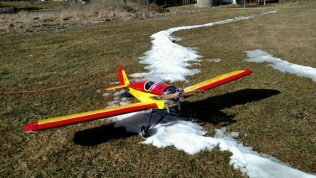

        I have been using a 1/3rd scale space walker with a Brisson 80 cc twin for years. It is very stable and can handle up to 5 meter ships if a scale like tow..it does much better with smaller 4 meter stuff...I beefed up the firewall area with fiberglass and epoxy to keep things together...also could not get a cowl to fit, so run the engine out in the open...using 5.5 inch Bubro wheels for clearance on the 24 x 12 inch prop...had custom landing gear made up by "cub landing gear" out in Oregon that is functional with bungee lines providing the shock absorption .....
        sweet plane...it is my "small tow plane" as primary is 108% Pegasus with DA-150 for the big stuff...

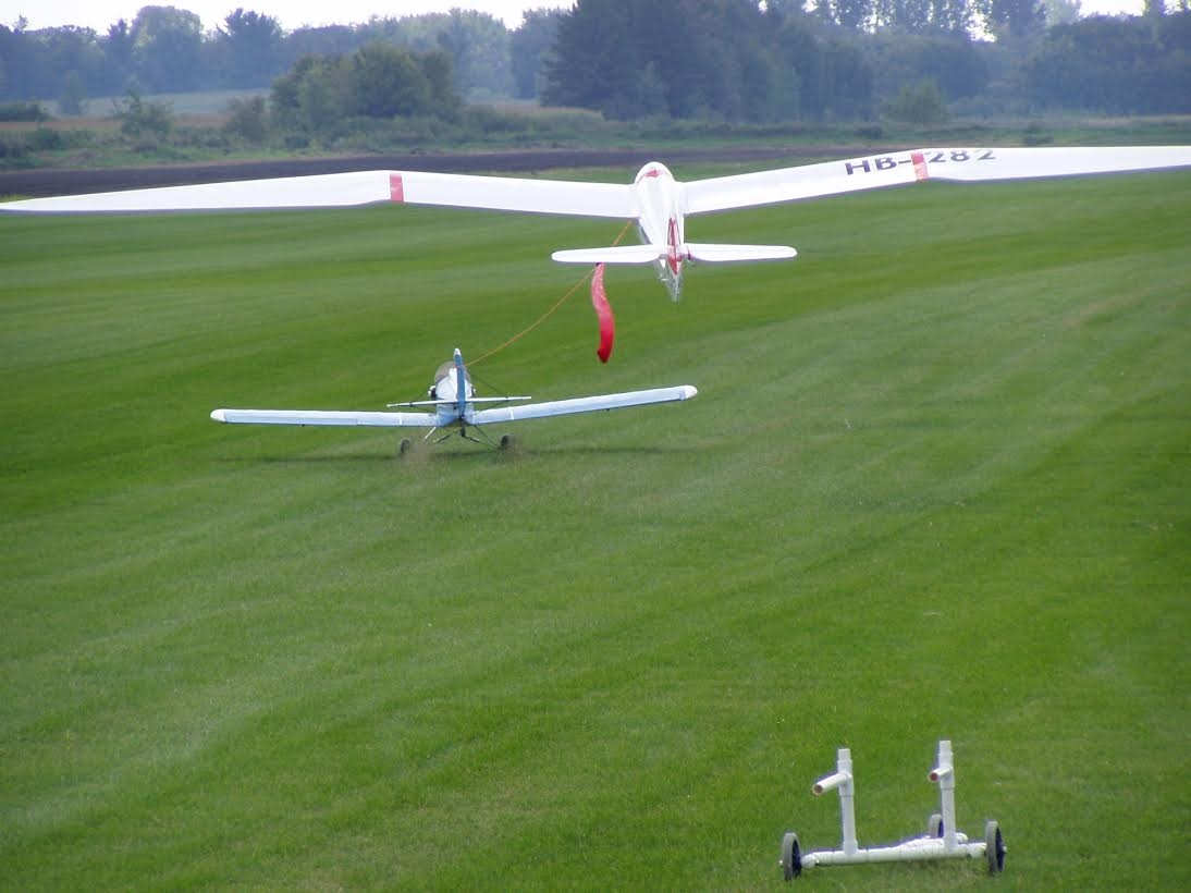

            A Spacewalker as a tow plane? Yes! I too have a 1/3 scale SW that I have been towing with for years. Many many flights towing gliders with this plane. Powered by a Zenoah G-62!

ID:	21691 This is the best photo I have of my Brisson twin 80cc Space Walker. Tim Mattsson (mosquito) was the one who got me to copy his Space Walker for towing...I think a DA-70 might even be better since that engine would be lighter weight etc. these are very stable much like the Popular Pawnee by H9
