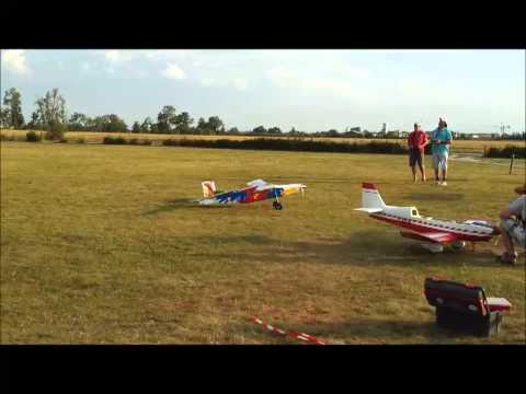

              I am using the Pilatus Porter for more than 4 years as a tow plane.
              At the beginning I used a E-motor Boost 160 on 12s Lipo. Now I have installed a DLE-55RA . The plane is good for gliders up to 12kg an 5m wingspan.
              You can find two videos of my Porter on youtube
              Börni
                on this video the Porter tows a 15kg / 6m - KA8 with the Boost 160 on 12s Lipo
                  On my homepage you find some pictures of my Porter and the DLE-55RA installation. Although it is written in german, I think the pictures show the details.
