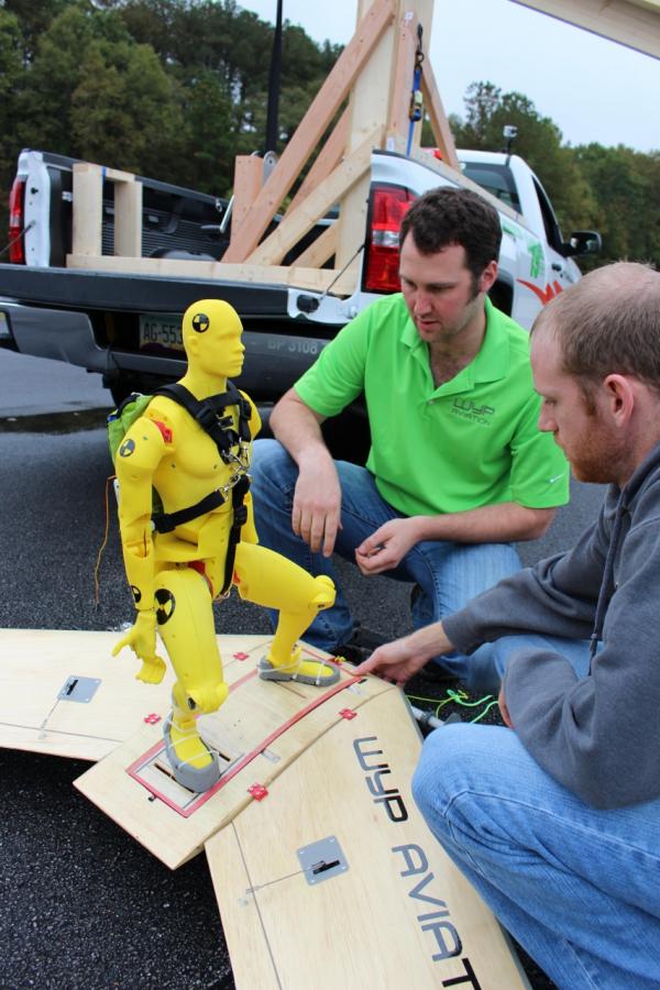

    One of my co-workers and good friend Aaron has been working on a project for a couple of years that I would like to share with you. For all of the details please go to http://www.wypaviation.com/wingboard.html
    After watching the video and reading up on what he has done make sure you click on the Current development link to see what is happening next.

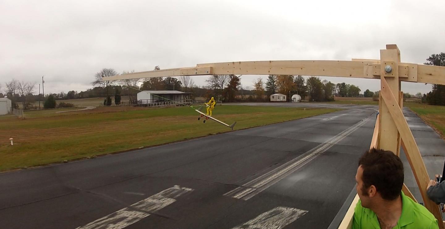

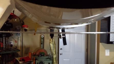

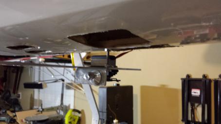

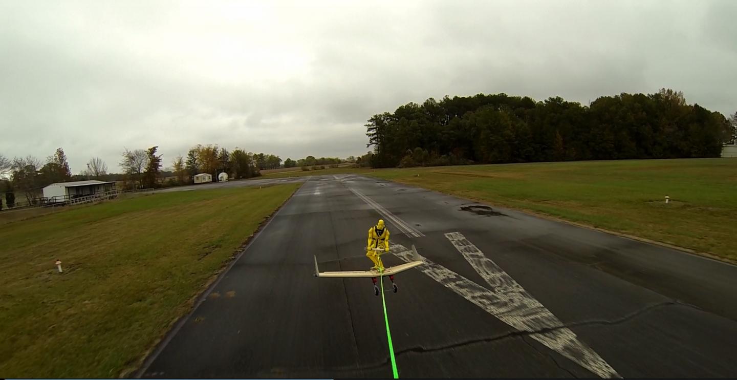

    I have agreed to be the tow plane pilot for the 40% scale wingboard test flights. We will be using my Bill Hemple 38% Super Decathlon powered (over powered) with a DLE 170. A bottom mounted frame has been added so that a tow release can be used from the bottom of the airframe. Gliders ride above the tow plane but the wingboard is more or less dragged with the tow plane so it stays below the tow plane.

    According to what we can see from the four cameras we were using the tow started off picture perfect and the first lap around the flying site was smooth as silk. The second lap was looking good until we decided to drop altitude and attempt a low fly by. I approached the runway in a decending turn and the airspeed picked up a little too much which caused the winglets on the wingboard to flutter. The yaw acceleration rates got so high that the ankles of the rider sheared and the rider fell off. The whole system went unstable at that time and the call CUT! CUT! CUT! was made and I hit the tow release and Aaron hit the parachute release. Big D was safe and continued flying unscathed. The parachutes deployed on the rider and that is when we found that the parachute reefing system needs some work as the deceleration was too much for some of the riders parts to handle. The rider ejection pulls the wingboard chute and it worked perfectly.
    It was really something to see the scale wingboard and rider being towed around the sky and flying silky smooth. At least until the flutter got us. According to the GPS data when the airspeed approached 65 mph is when the flutter started. Now we know that we have a speed limit that we need to keep track of. The wingboard will be getting a real time airspeed sensor added to the telemetry system and the winglets will be remade this time using 3D printed PLA instead of foam cores.
    The damaged rider is being repaired and will go into another captive tow test to make sure everything is still working and then we fly for CNN in two weeks. Wish us luck.

                  SUCCESS!!!!!
                  We did two flights and both went without a hitch, well, one minor one but it didn't do any damage. The tow line got wrapped around the tow planes tail when we started doing rolls.
