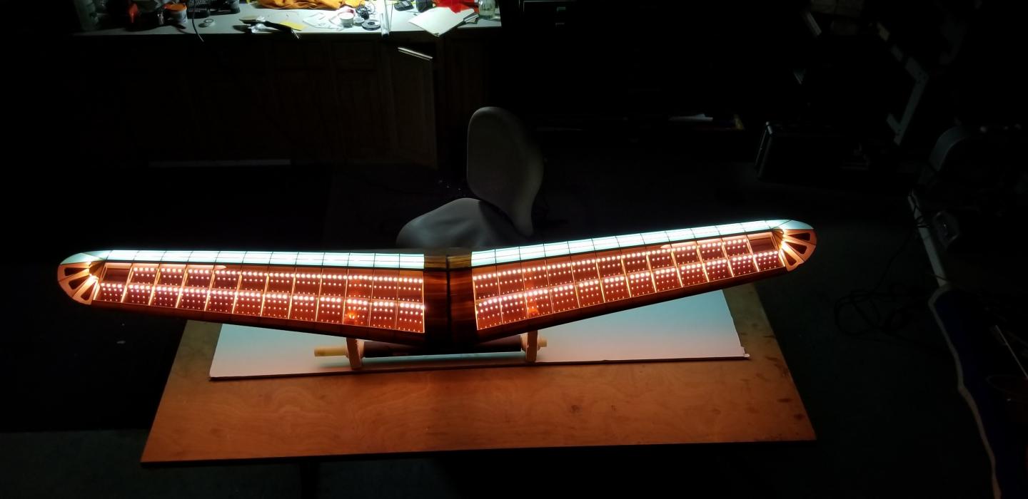

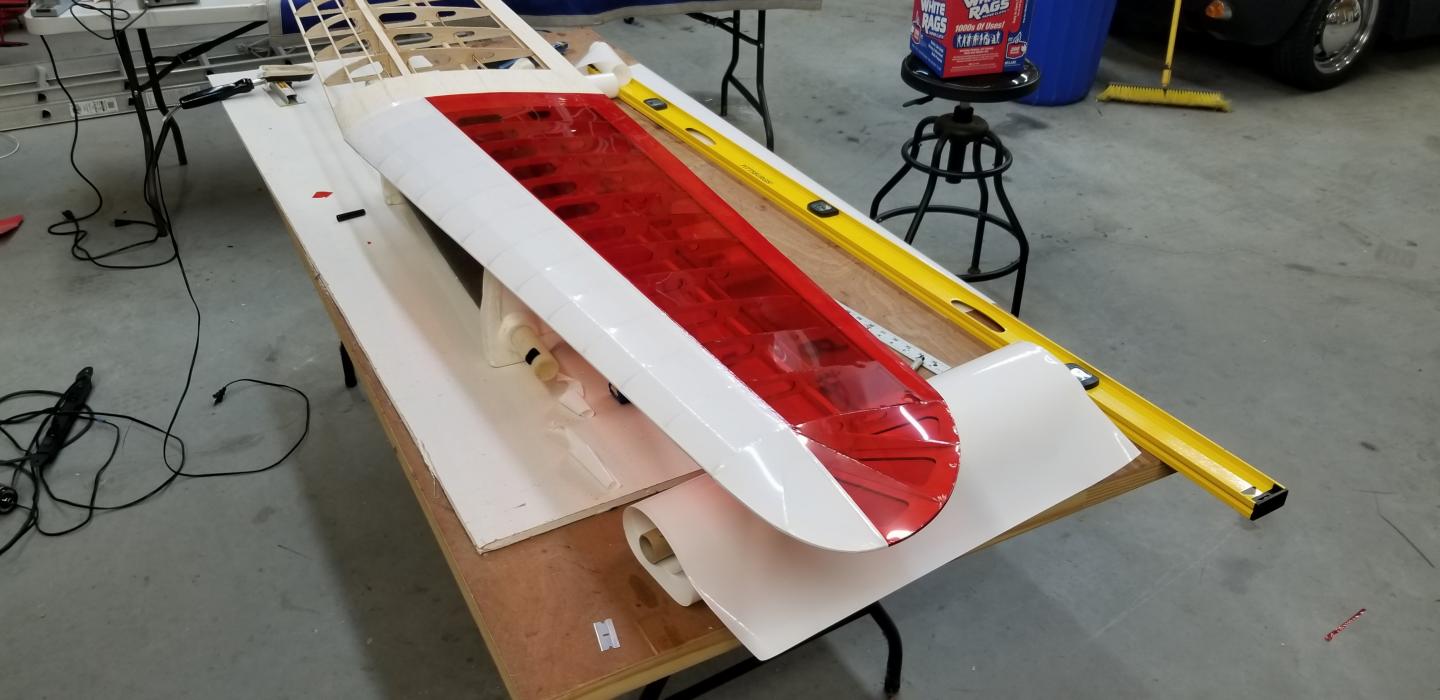

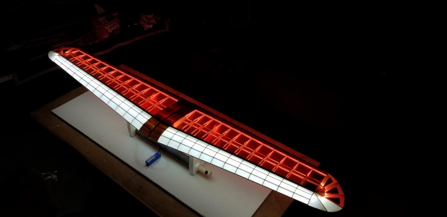

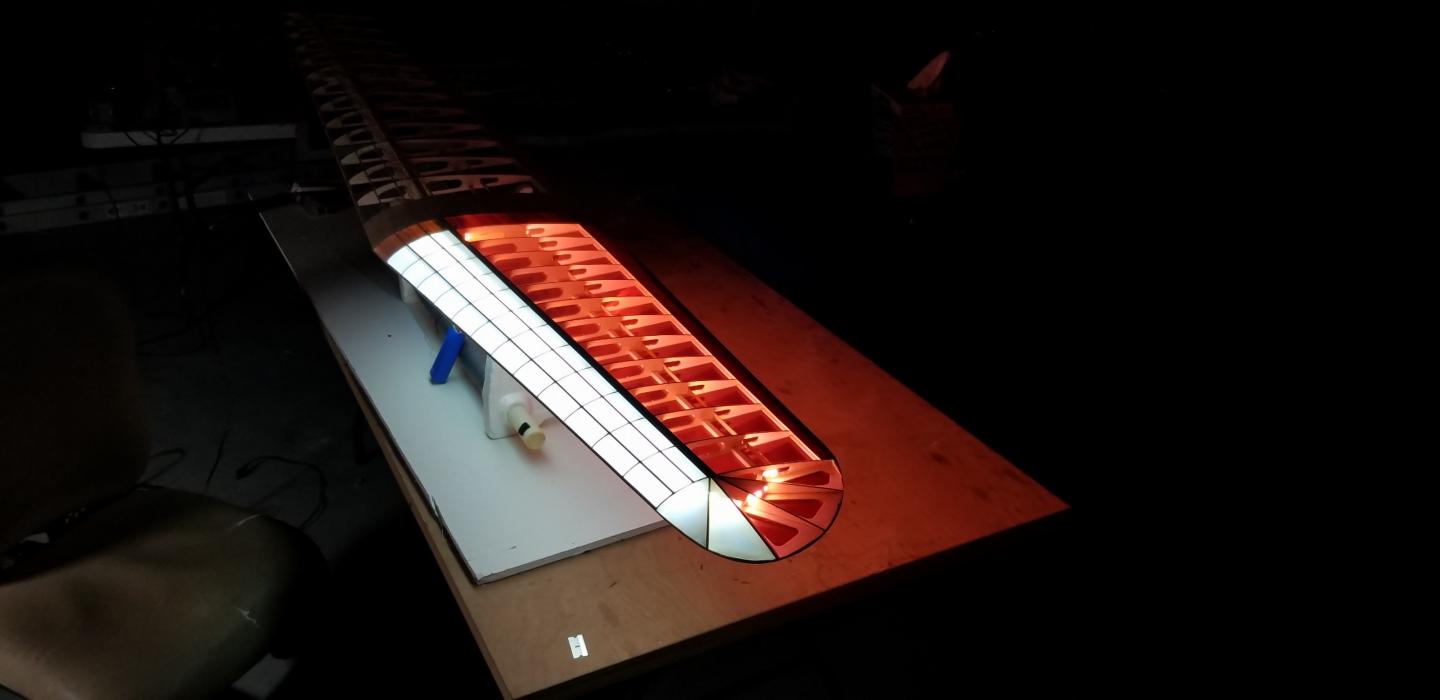

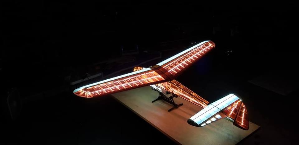

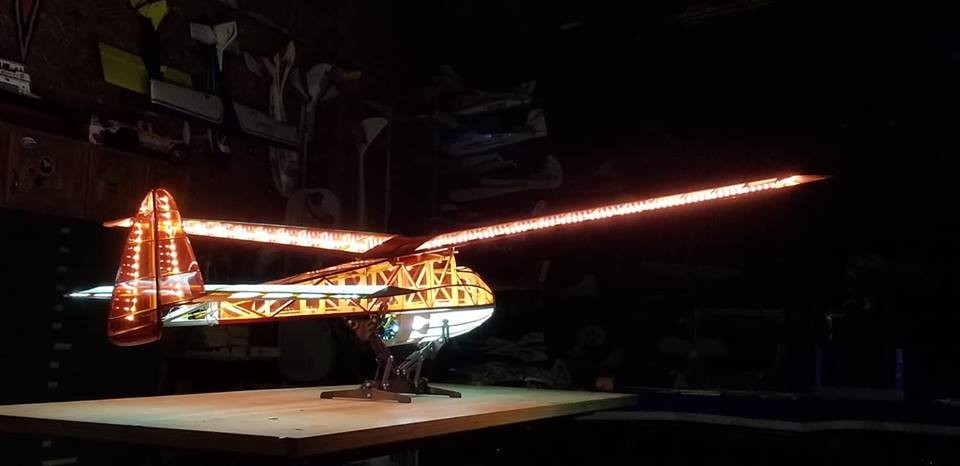

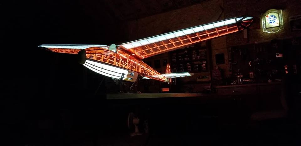

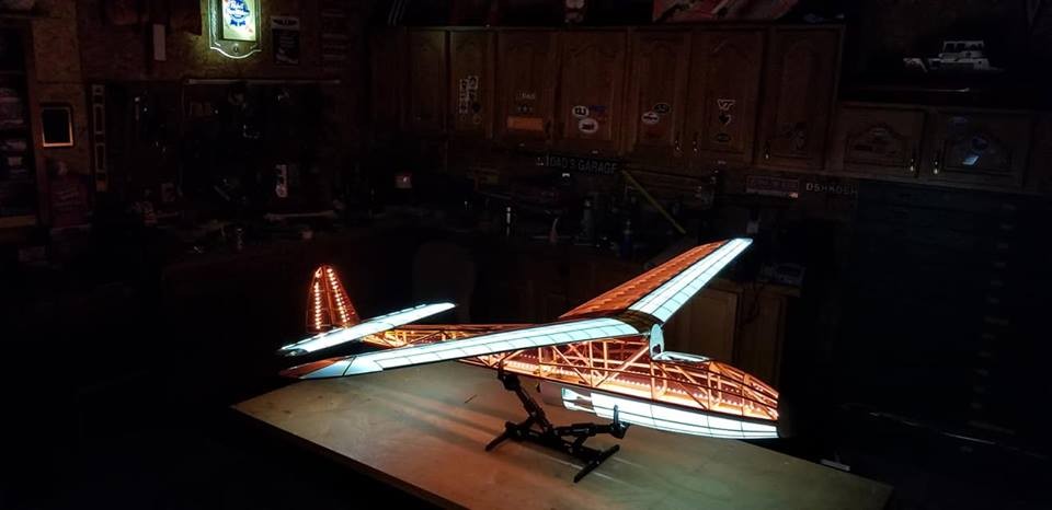

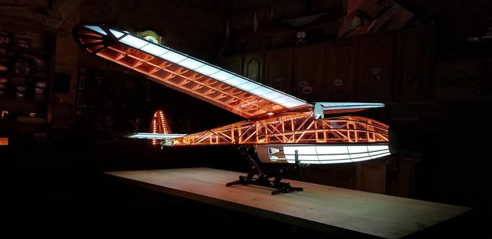

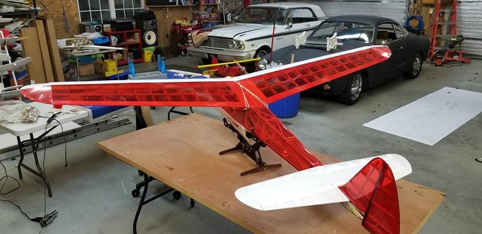

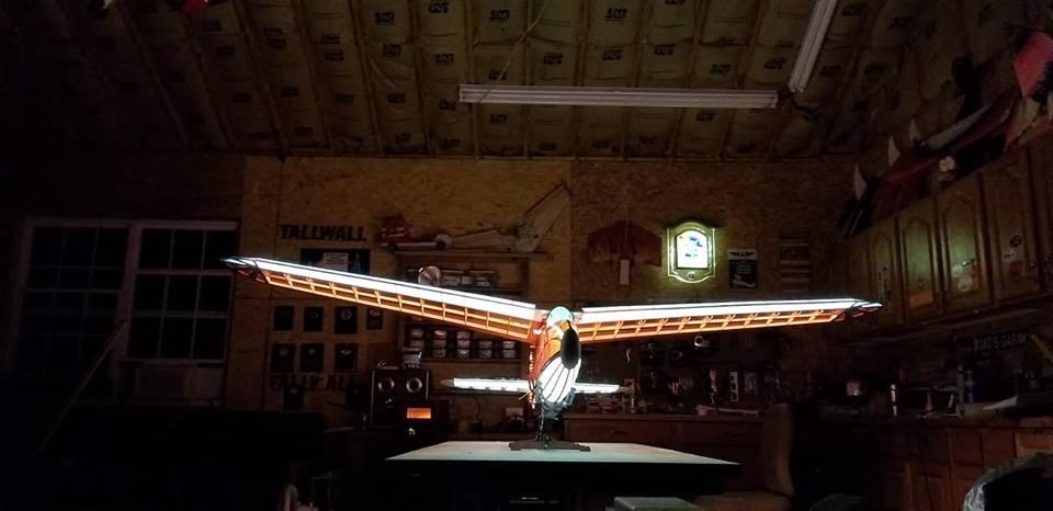

    So to prevent hijacking another thread I thought I'd start with updates on mine and with the lighting and covering progress. The Peter Goldsmith Sapphire EDF sailplane. Main structure is now complete short of some sheeting once I figure out the power plant installation. Going with a similar covering scheme to my Foxbat and have quickly realized I did not order nearly enough of the red. I am making mine a night flyer and so far am very pleased with the light setup.
    I mounted the rows of LED strips vertically inside the wing. One row in front of the spar faces forward and 2 rows behind facing back. The light seems evenly distributed and quite visible. At least in the garage anyway. Only downside is it really washes out the transparent red. I like it though and look forward to getting the other side covered tonight hopefully.

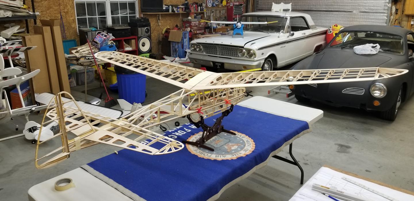

        Cool! I really like the VW KG, too!
          VW Karmann Ghia! I'm guessing it is a '68. I'd like to have a '58 low light KG. It would sit great next to my '57 and '59 TypeI Käfers!
        • FiremanBill
          FiremanBill commented
          It is a 71 ARUP. I hated those big gawdy turn signals so I got rid of them, filled the holes and put the early bullets on it.
          Did you do a similar treatment for the rear ones, then? Your Falcon is cool, too! '64?

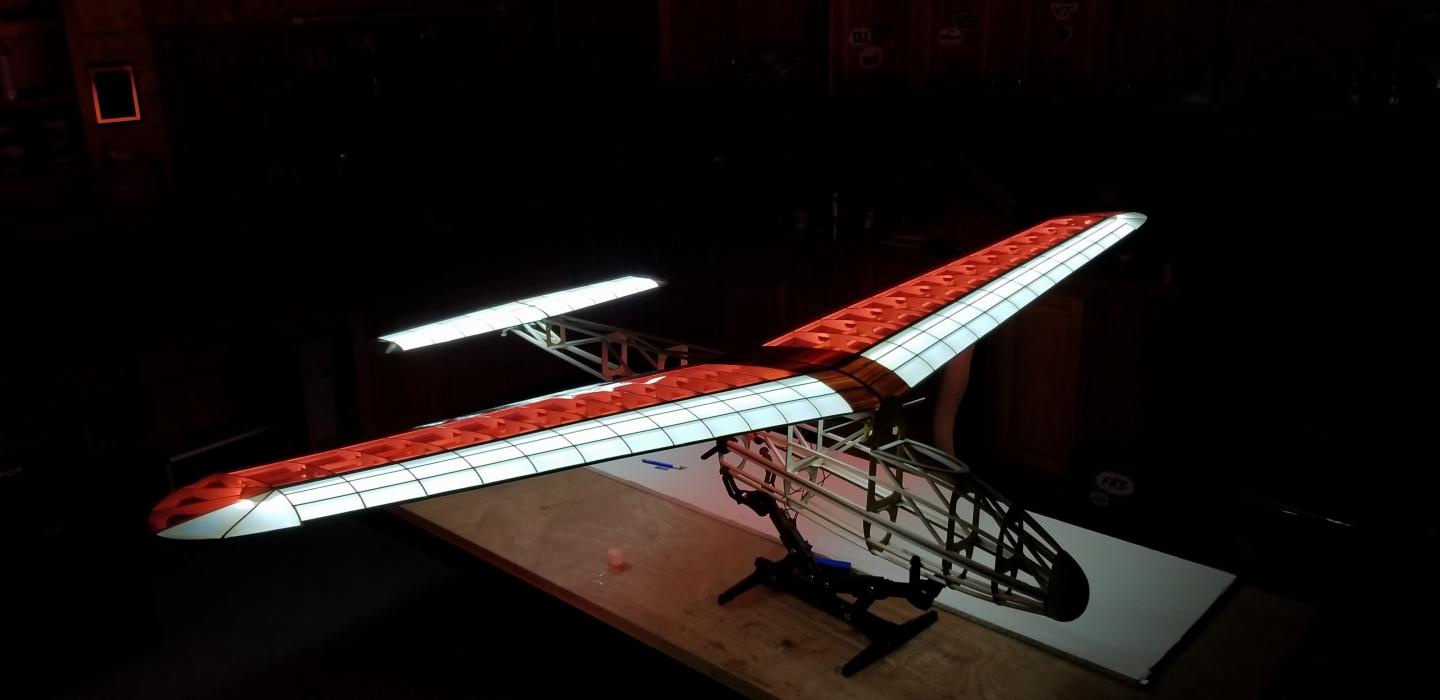

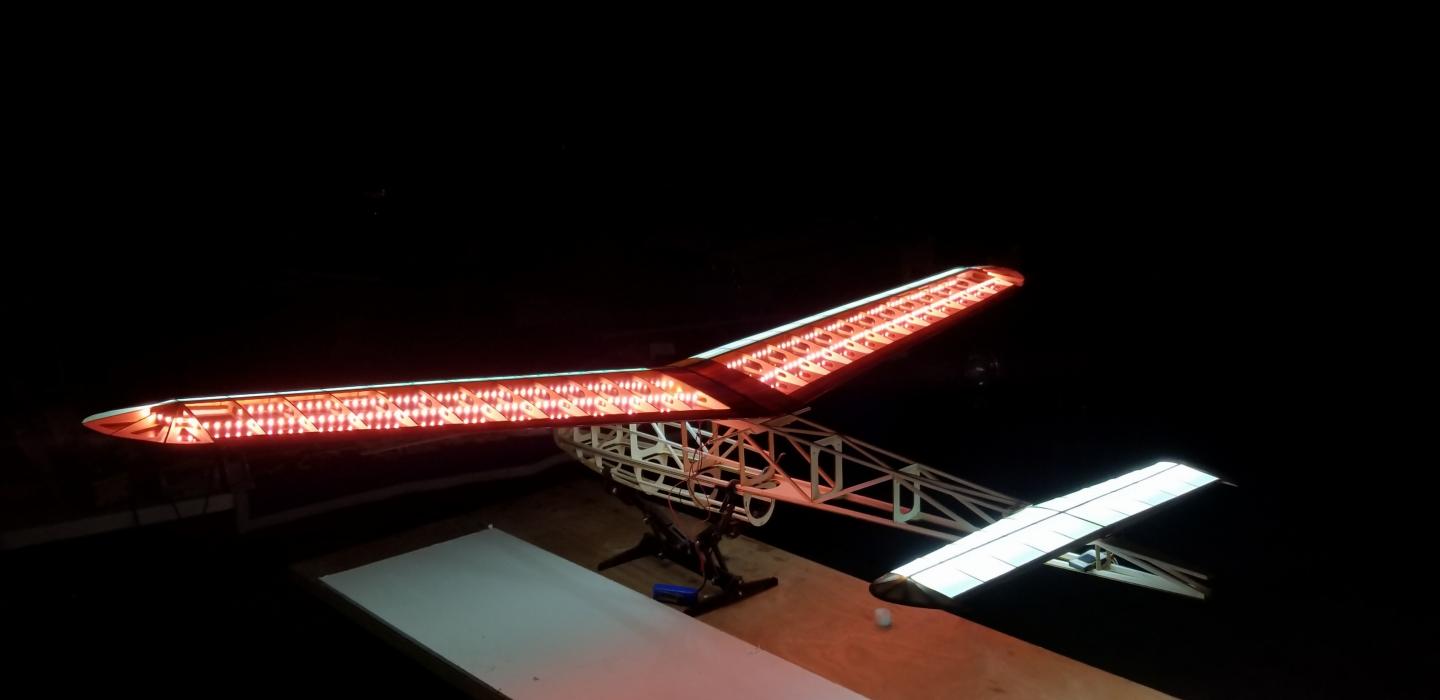

        So I got the rest of the wing complete and started on the lights in the tail over the weekend between weddings and kids visiting from Virginia. lol Will post pics of the tail when I get them finished.

          Love the reflecting light effect! Nice work.
            So I got some more done last night. Coming along nicely.

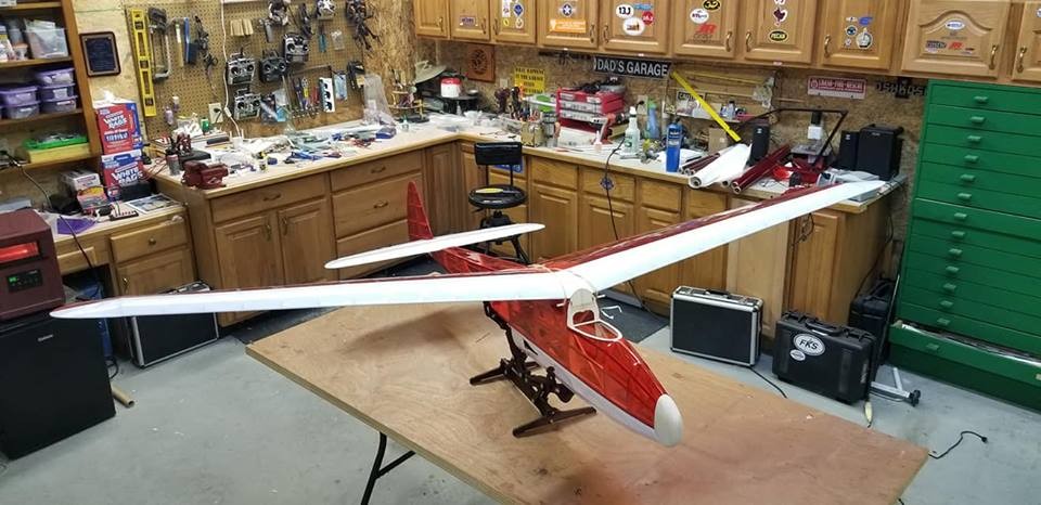

              So I am just about ready to maiden. Will get my radio gear in and a few minor things left after that. I am very pleased with how it has turned out.

                Really neat!! How much weight do you think the lights added? Enjoy the maiden!
                  Not much at all. Near as I can figure they add just under 4 ounces. I used a very thin lightweight lower powered LED than i typically use on night flyers. The lights will share power off the motor battery so no added weight there either
