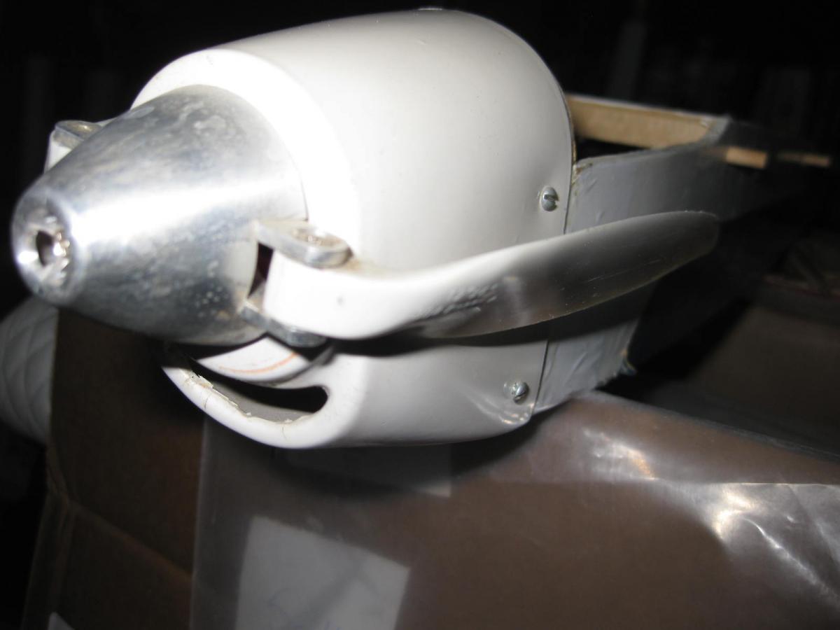

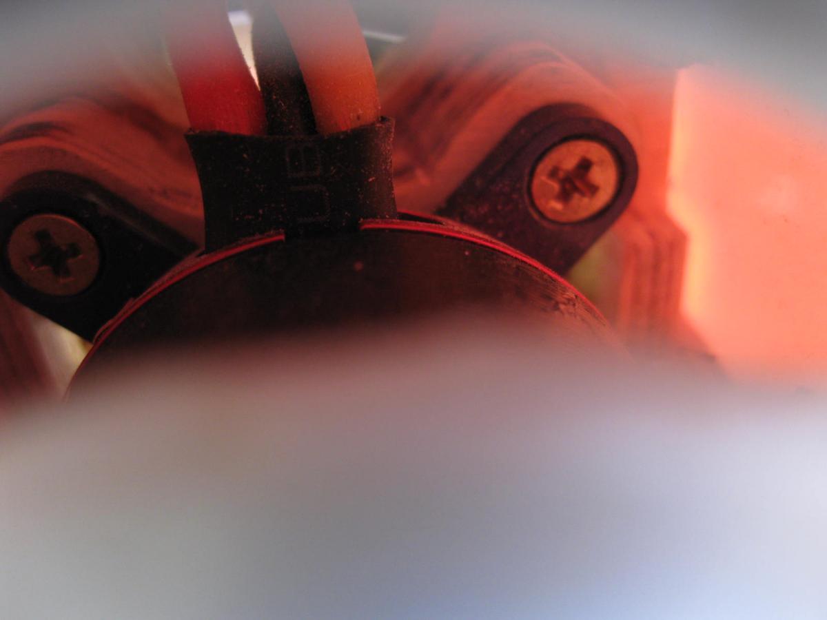

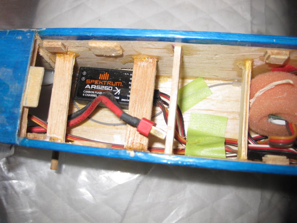

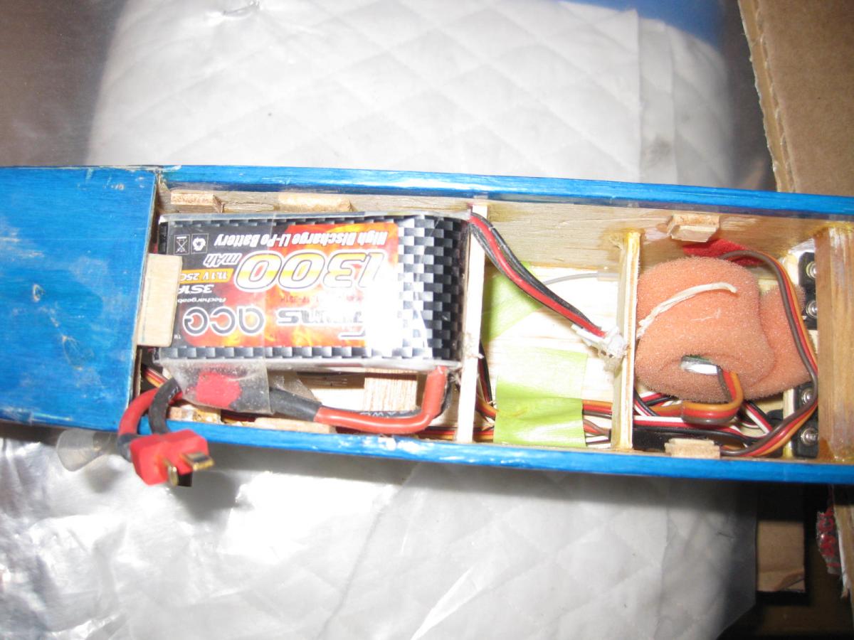

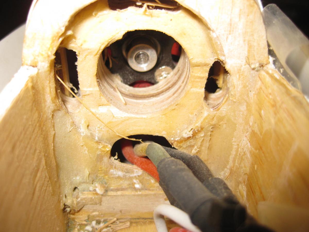

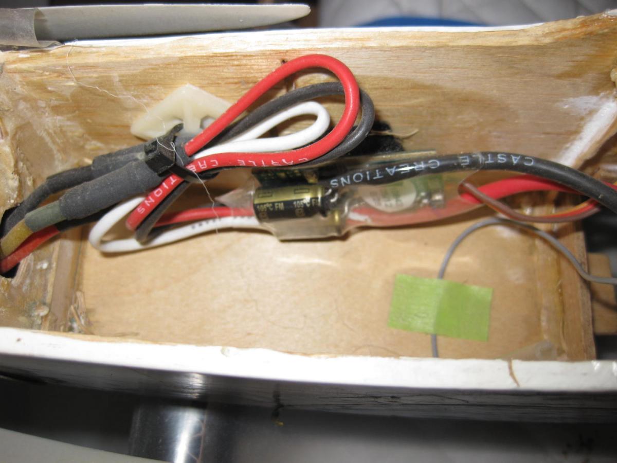

      I converted my Electra over to a brushless motor system a while back and cut out a bunch of weight.
      All you need is a 480 size motor system like the one in the smaller Radian Sailplane (arround 1000kv)
      I can't remember what exact motor I'm using .....and ....well ...I'd have to take the prop and small cowl off to see ......
      30amp speed controller and 1300mAh 3-cell lipo ---- receiver is run off the 3amp bec in the speed controller
      The Propeller is a 12 x 6 APC electric folding and spinner to match the motor shaft
      Battery was mounted at the forward edge of the battery compartment on some rails I installed - for balance and easy access.
      I just cut off the old motor mount ( mine was ABC plastic ) and glued a stack of plywood over the current firewall to get the motor out to match the old one.
      ​i did cut out the center to allow for air flow -
