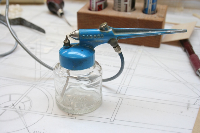

                  Pete, here is a paint sprayer that I have used for years. It performs a little better than a rattle can but about the same size spray pattern. I have painted whole models with it but mostly I use on small jobs. It would work nicely in your setup, or you could go outside with it on a bigger project. It's simple and cheap and works really good. Click image for larger version
                  Here is a link. I recommend getting a larger jar like mine.
                  http://www.amazon.com/Badger-Air-Bru.../dp/B0006MZPLG

                    LOL...I have one of those in my collection of airbrushes and sprayers! I use it all the time plastic models and even on the occasional RC model and other projects.
