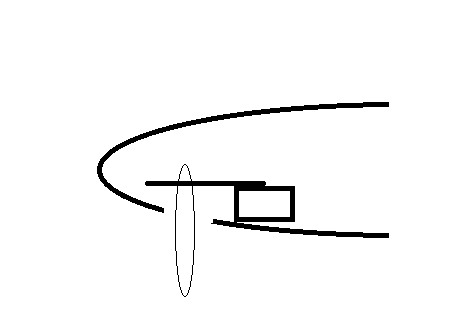

    how to install tow release the easy way ? i am new to this an where is the best place to buy one?
    thanks mosch
    the problem is i have a motor in the nose its a KA8B 4500
    Hey Mosch, welcome!
    The simplest way is a hole in the nose with a wire across it. I made a quick sketch that may explain it better. I like to use releases from Iflytailies, they fit nicely in the nose.

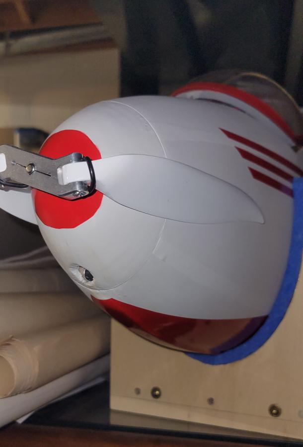

      I have my Zugvogel release below the motor. Click image for larger version
