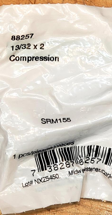

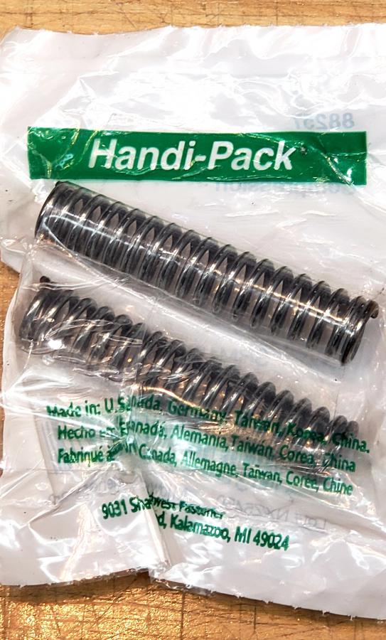

I had two springs stored in my toolbox that served the purpose @ Wind Ridge. Now than I'm home I "think" the ones pictured below are what we used -- Midwest Products 88257 13/32. They look right compared to what we used and I don't know why I'd have them stored with my spare Antares rudder and tips otherwise. YMMV.
