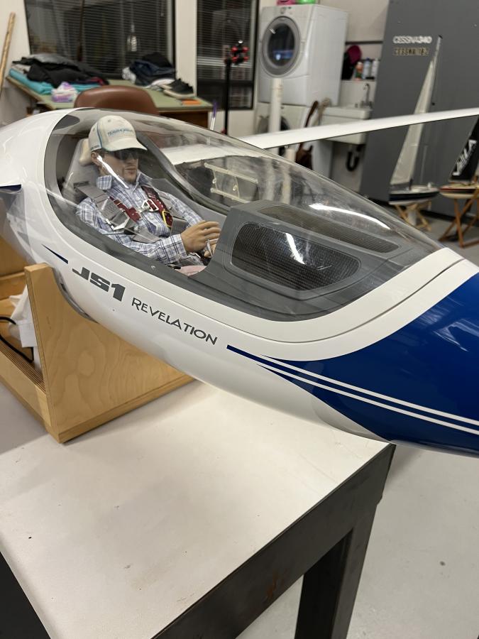

    Hi All, I have a LET Model JS-1 and want to touch up the paint, specifically the blue color on the nose. I went to my local custom paint shop for auto paint and the best match we can come to is RAL 5005, Signal Blue. Before I commit and order it, was wondering if anyone could confirm?

    Petr and others at Let are responsive to email if you can give them a few days. May be able to give you some guidance of the RAL color used.

      Thanks Steve, I sent them an email, hope to hear from the LET team.....
        FOr anyone who needs this for future reference purposes, depending on production sequence, the colors used were RAL 5002 (Ultramarine Blue) or RAL 5010 (Gentian Blue)
