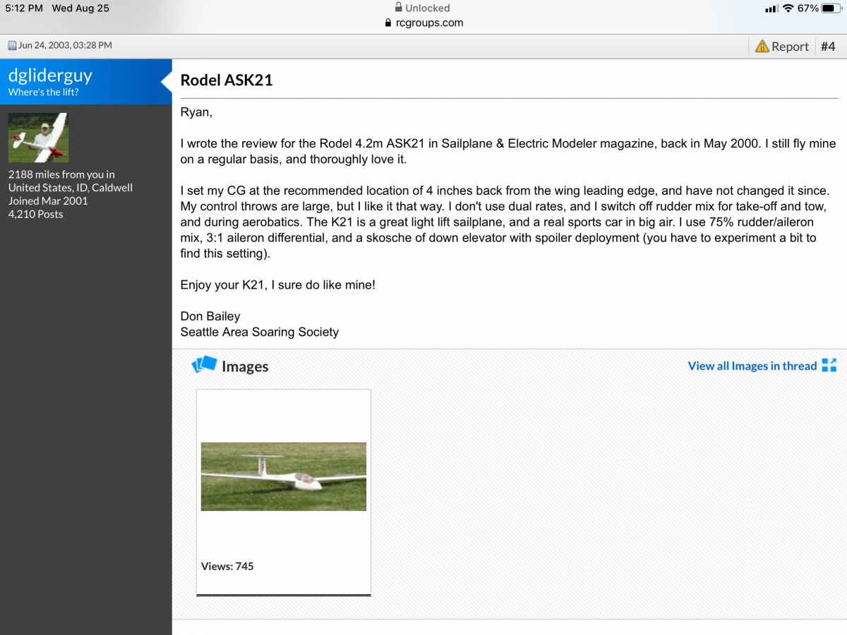

        I did a quick measurement on my Rodel Pilatus B-4 which is 1/4 scale. Probably similar construction, airfoils, size is in the same ballpark so travel measurements are probably similar..
        Ailerons were 12mm up, 10mm down in a more aerobatic mode and 12 up, 8 down in a thermal mode.
        Elevator travel is around 15mm up and down. Elevator compensation for spoilers is 3mm up
        Rudder travel around 35mm. Normal mix is 5mm with full ailerons but thermal mode is 10mm with full aileron.
