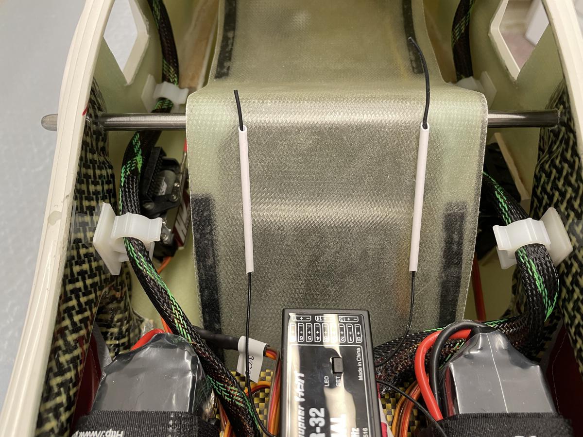

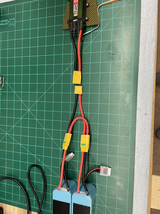

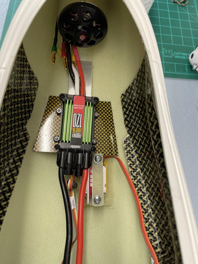

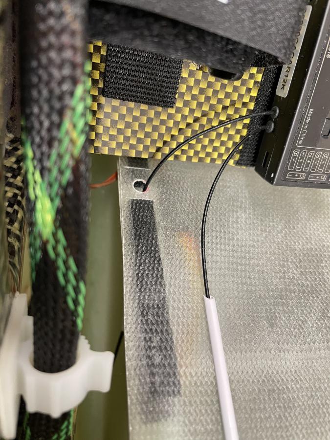

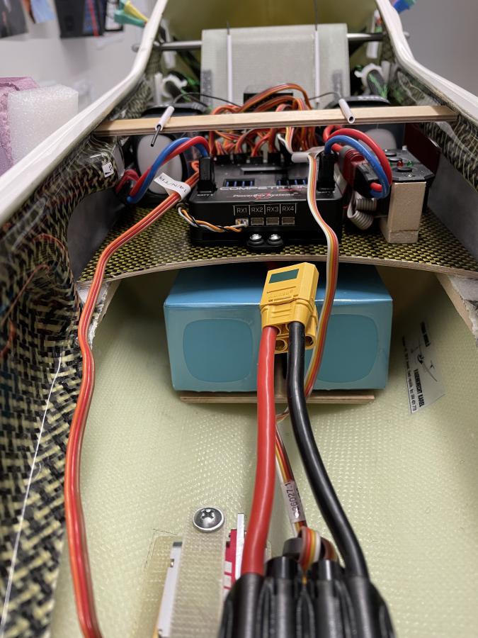

Just about done ( Lenny is relieved probably ) .....any comments on my install, tried to keep Rx antennas out of the way of the Batts and wiring. Two 6s 5000ma pack underneath mounting platform...wiring in series....balances out nice...when I just tow, I move the RX packs forward where the ESC is and it balances nice....Lenny, I used a Champion SRS box on this one, and the one you sold me for my Nimbus...Thx
Please dont hesitate with opinion, love to see how other people build.
