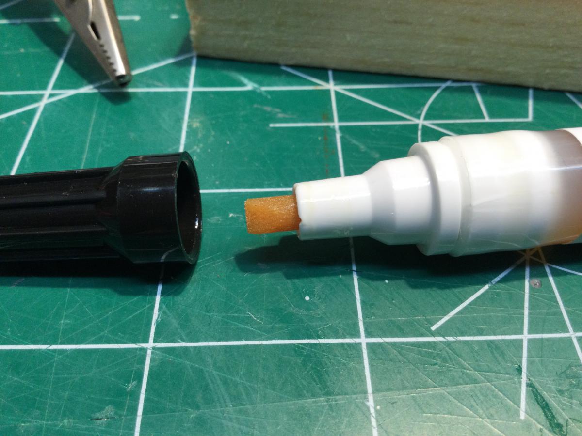

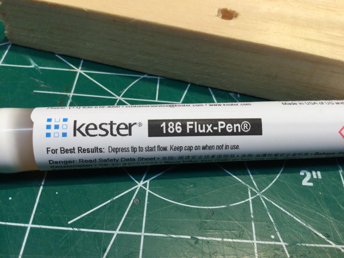

1. The Kester 186 Flux-Pen rules! Apply it to the wires and apply it to the connectors and even the best quality rosin core solder flows even better and faster.

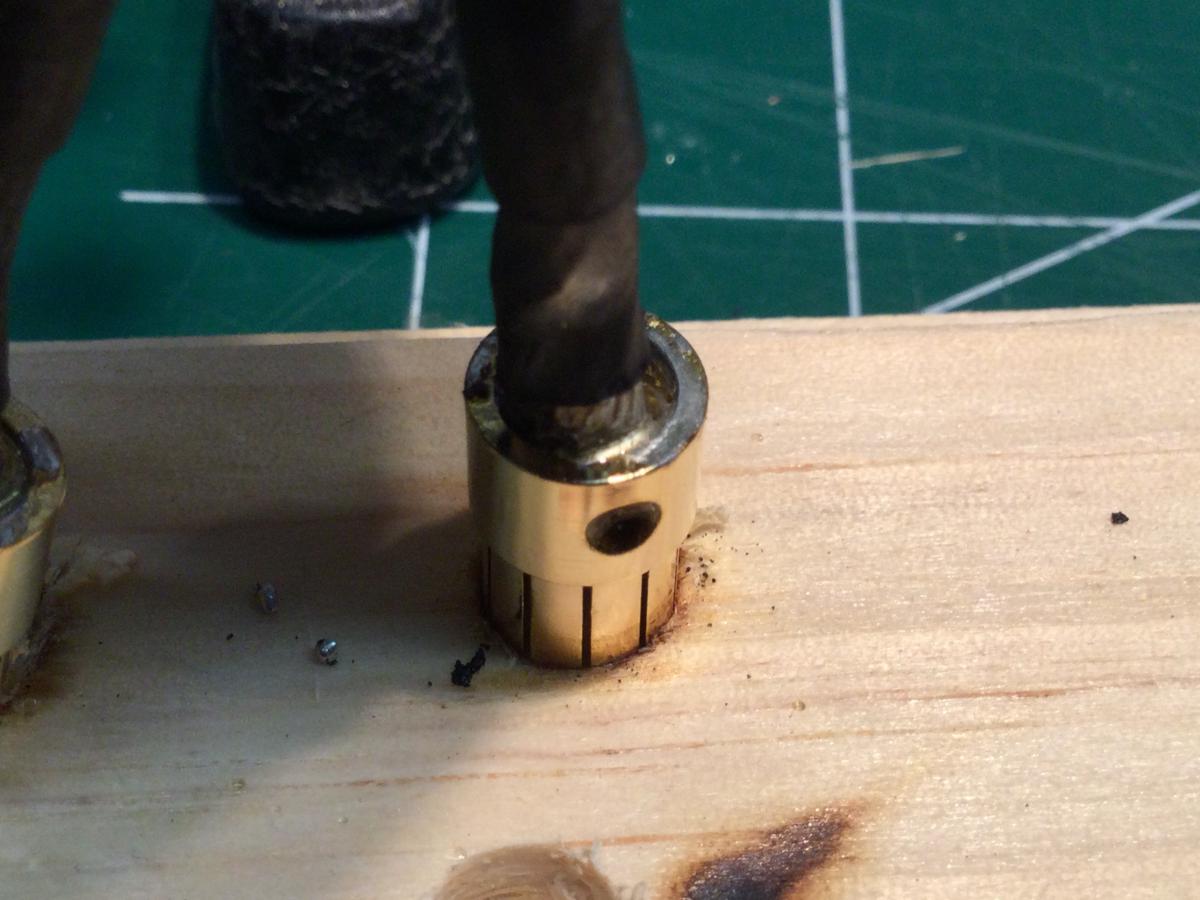

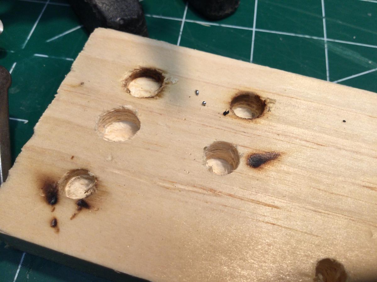

2. Simply drilling a hole into a piece of wood to hold a bullet, in this case 8 mm bullets, is the world’s best simple hold down. And by the time the solder joint is finished the wood really doesn’t burn.
