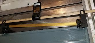

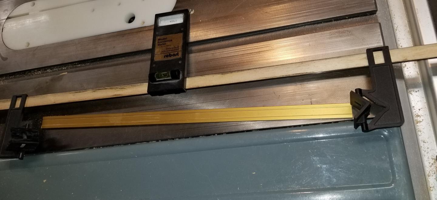

            Make a incidence meter out of wood that fits your wing that the Robart meter head sits on.....done it a bunch of times.
            TEAM GORGEOUS
              I did one better than a wood bar for the meter. I laminated two 3mm x 0.5mm strips of carbon to a pine strip. Fits really nice.

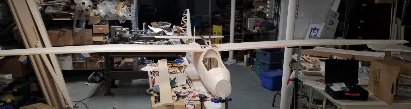

                OK, green cross laser set up from the ceiling. This draws a line down the centerline of the fuselage (and to the bottom keel where that is visible) and also draws a line on the wing panels just behind the LE balsa. You can also see it light up the fin LE. There is a second tripod mounted horizontal laser to the front of the model. You can see the red crossing the LE of the wing.
                So if the LE crosses about the same place and I can measure down to the beam at the tips about the same while the fuselage line is vertical up the fin and down the centerline, that is good. If the cross line from the top matches where it traverses the left and right wing panels, then the wing should be good that way. Since it is a 3021ish airfoil, essentially flat bottom. I can attach two long carbon rods to the left and right wing panels the same distance out. Those two rods should also be parallel so the wing angle matches that way.
                The ceiling laser is a cheap one from Amazon and it includes a remote control so you can turn the beams on and off when you need to tweak the model. The mount for the laser includes an adjuster to level it to the point where the self leveling works. It also rotates. Between that and moving things on the bench it is not too hard to align.
                The beam on the green one is almost 3mm wide. Matches the ply in the model pretty well. The red one is an old Ryobi I had and it has a finer line. But not as bright.
                The only thing I found in my building was the front of the nose got twisted a little from the back of the cockpit to the front. Probably when I did the first pieces of sheeting. The bottom of the fuselage is straight.

                  The red laser is not self leveling. It has two small levels. When I compare it to how things are visually, it is not good enough. Maybe if it was self leveling, it would be better. It is probably at least 15 years old.
                  I measured two marks per panel. One just before the mid wing break and the other about 6 inches from the tip. I put a T pin in the tip ones. The green laser has a horizontal beam too. I can measure down with a wood ruler. It's not any closer than maybe 3-4mm but in a 4M wing, I think that is good. I was also able to compare the two vertical beams lining up the LE and the fuselage centerline by measuring from the tip pins to the top of the fin and the center of the fuselage just in front of the stab.
