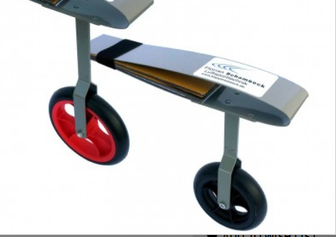

    Interested to know if someone has built there own portable clamp on wing wheel assy for towing the model out to the flight line? Plans building tech etc
    Icare-Icarus sells some. Construction is just a strip of alloy sheet folded in half, roughly mimicking an airfoil's front end where the fold is. Mount a post and wheel with hardware that is flush on the inside. Then just add a little Velcro strap and some kind of durable foam rubber product to line the inside for protection/gripping power.
