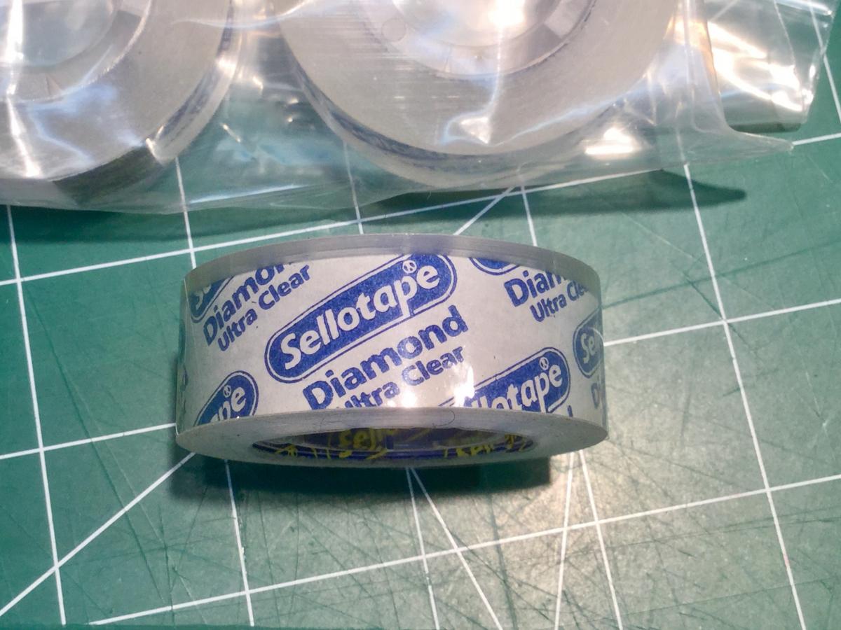

Looks like that tape may have been disontinued too. I really love Blenderm by 3M but it's not really clear and doesn't look as good on servo hatches. It's really strong and flexible for taping wing joints though.Originally posted by Steve P View PostI’m a fan of this for tape hinges. From the UK...

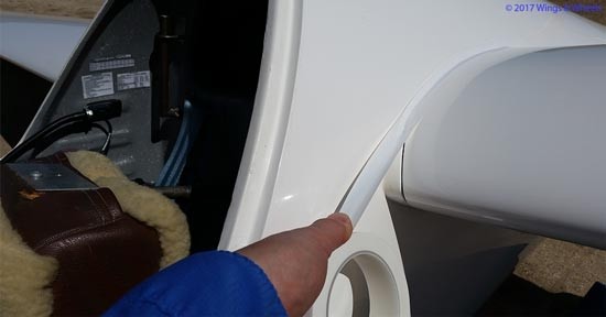

So what do you use to attach the servo bay covers? I've never seen anyone glue them on. And gap seal tape? Blenderm works great for the latter but it isn't quite clear if you are looking for tape that almost disappears after applied. I guess you could use white, but most tape manufacturers don't care what color white your plane is?Originally posted by Tom View Post

Servo covers are attached will a small amount on silicone or goop........never use gap seal tape since these are scale sailplanes and not TD compition airframes and extracting every once of performance out of them isn’t really something I’m concerned with.....and as far as taping panels together good old 3M white electrical tape works just fine.....sold at HomeDepot/Lowe’s.....Originally posted by edfmaniac View Post
