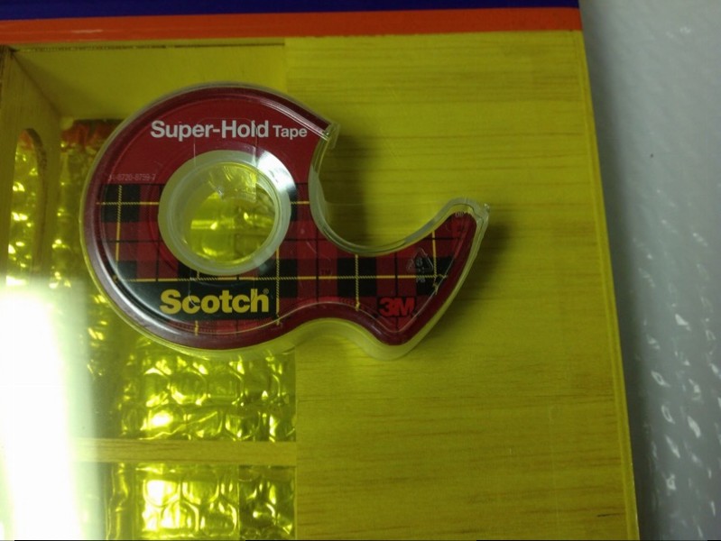

    Many sailplane wings use tape to hold wing joints together. We recently completed two of Peter Goldsmith's designs that use this technique; the Sapphire and the Skylark.
    Electrical tape works well for this b cause it comes in multiple colors, goes on easy, and comes off easy. Problem is, after several times on and off, it starts to pull the UltraCote loose.
    A way to limit this is to apply a clear tape over the covering, then the electrical tape applies over the clear tape instead of directly to the covering. We just found a great product for this and it is readily available.
    ​​​Scotch Super-Hold Tape

    Jim I wondered if about this because it has been pulling of the UltraCote. I thought that using clear packing tape place on the join and then the tape over it would be better and you just confirmed this that. Even better with the tape you recommend! Thanks a bunch!
