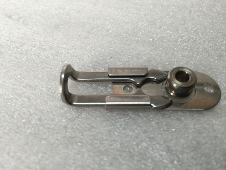

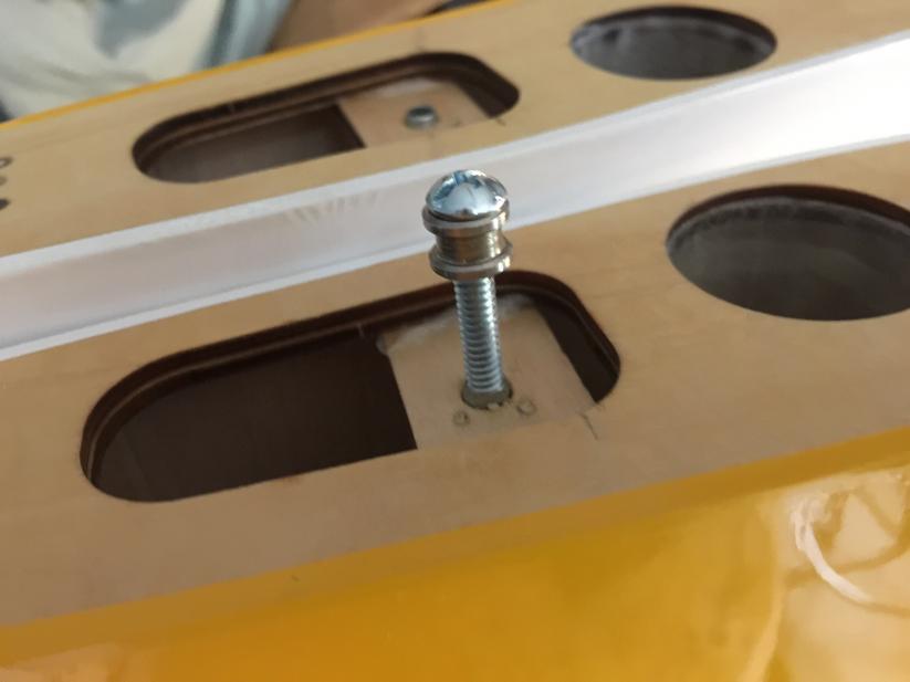

    Here's a new take on wing retainers, at least for me. This is a repost from the Bidule 111 build but I thought I'd post it here for those not following that thread. I think this may help in tight situations.
    I am repositioning the fuel tank over the wing rod and CG on my Bidule 111 and decided I needed a different retaining system since it would be problematic trying to install the plastic thumb screws supplied in the kit. I fumbled around for awhile and stumbled across these snap latches at McMC. One per side near chord center should be plenty. I used a 10-24 screw to hold the stub and installed a plate with T nut in the root of the wing. The pics and video should explain it.

    Stating the obvious and repeating myself but, "You da man!". Great idea, Asher.

      Thanks for the roses, Mike

        I can think of a couple model that these would speed the assembly time up tremendously!!! Thanks for finding them Asher!
