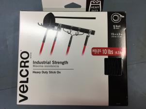

Velcro tabs can be added to act as resealable closures.
