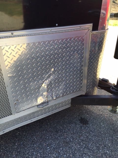

    This is the original panel. Notice it has a Vent panel added into the left side. Since that was a bad idea, I have never used it and water would get into the bay. I eventually just sealed it up with silicone to stop the water.

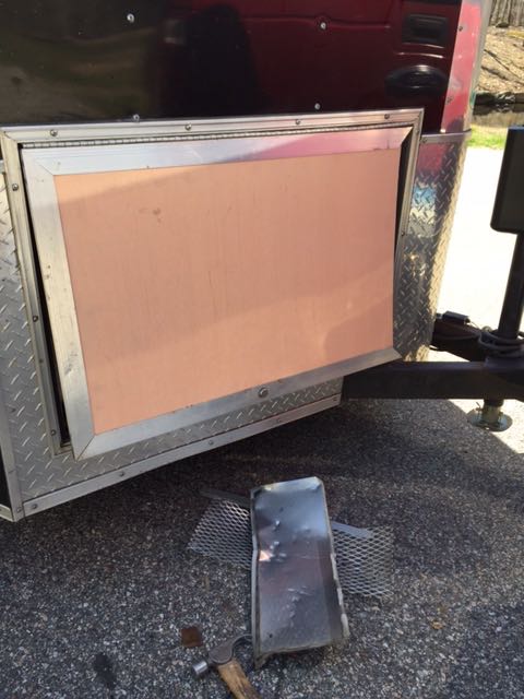

    Removing the section was easy, there were 8 screws on the edges of the frame which came out without any issues. I did have to drill out a couple rivets holding the divider between the vent section and the solid panel. That took about 14 seconds. Because I sealed everything with silicone, I needed a little 'Persuasion" to get the vent out. ( another 14 seconds)

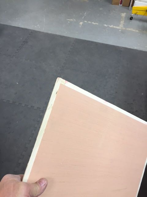

    The slot in the aluminum frame which holds the panel is just about 1/4" wide, of course I had some Luan which is pretty close to 1/4" believe it or not, so with the aluminum panel and the Luan added, it was too thick for the slot. A simple run through the table saw to remove 1/16 around the back side and we're in business.

    Test fit the panel,

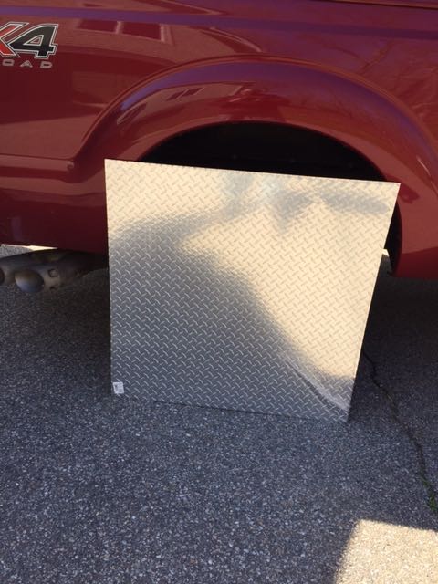

    Here is the sheet from Home Depot, still with the plastic on the surface.

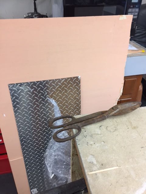

    The Aluminum sheet was cut with sheers. The Luan was cut with a utility knife. ( the relief cut was done with a table saw)

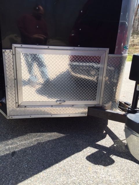

    Finished product. I'm very happy with the results and thrilled it didn't cost $150.00 as quoted by a trailer store....
