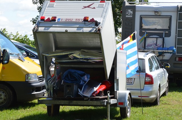

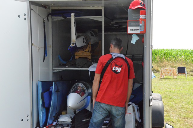

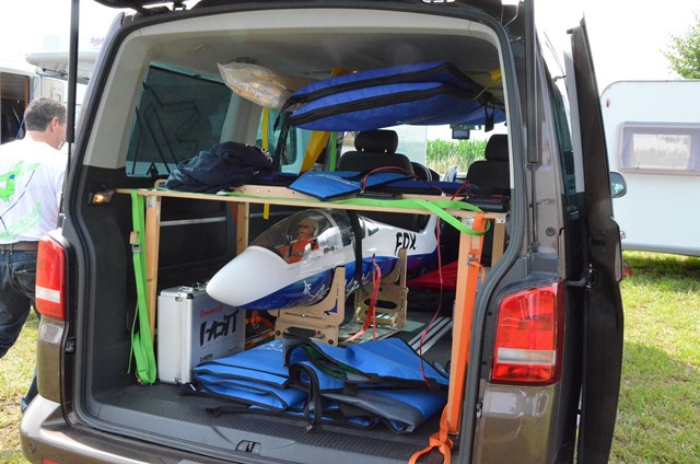

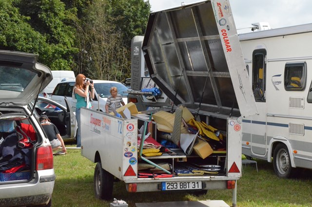

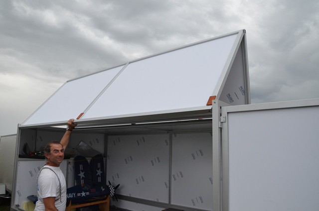

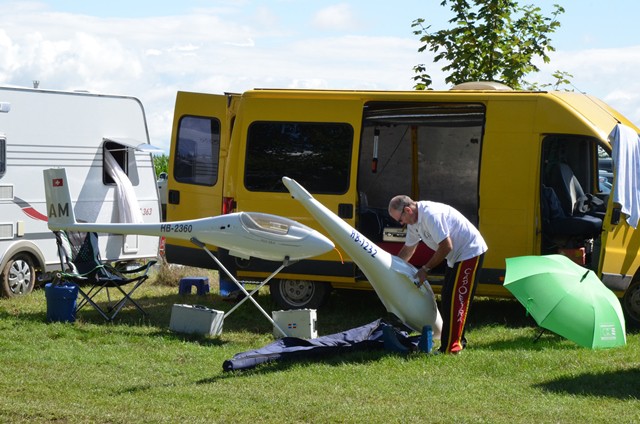

It is pretty much the same as here: vans, custom small model trailers, inside the camping trailer, larger model trailers. I have only seen 1 or 2 car-top carriers, shaped like full-size glider trailers. The move to larger scale sailplanes is creating demand for 2-piece fuselage models. A 6.5-meter sailplane can just fit in a Passat Station Wagon but you lose use of the passenger seats, except the one behind the driver.

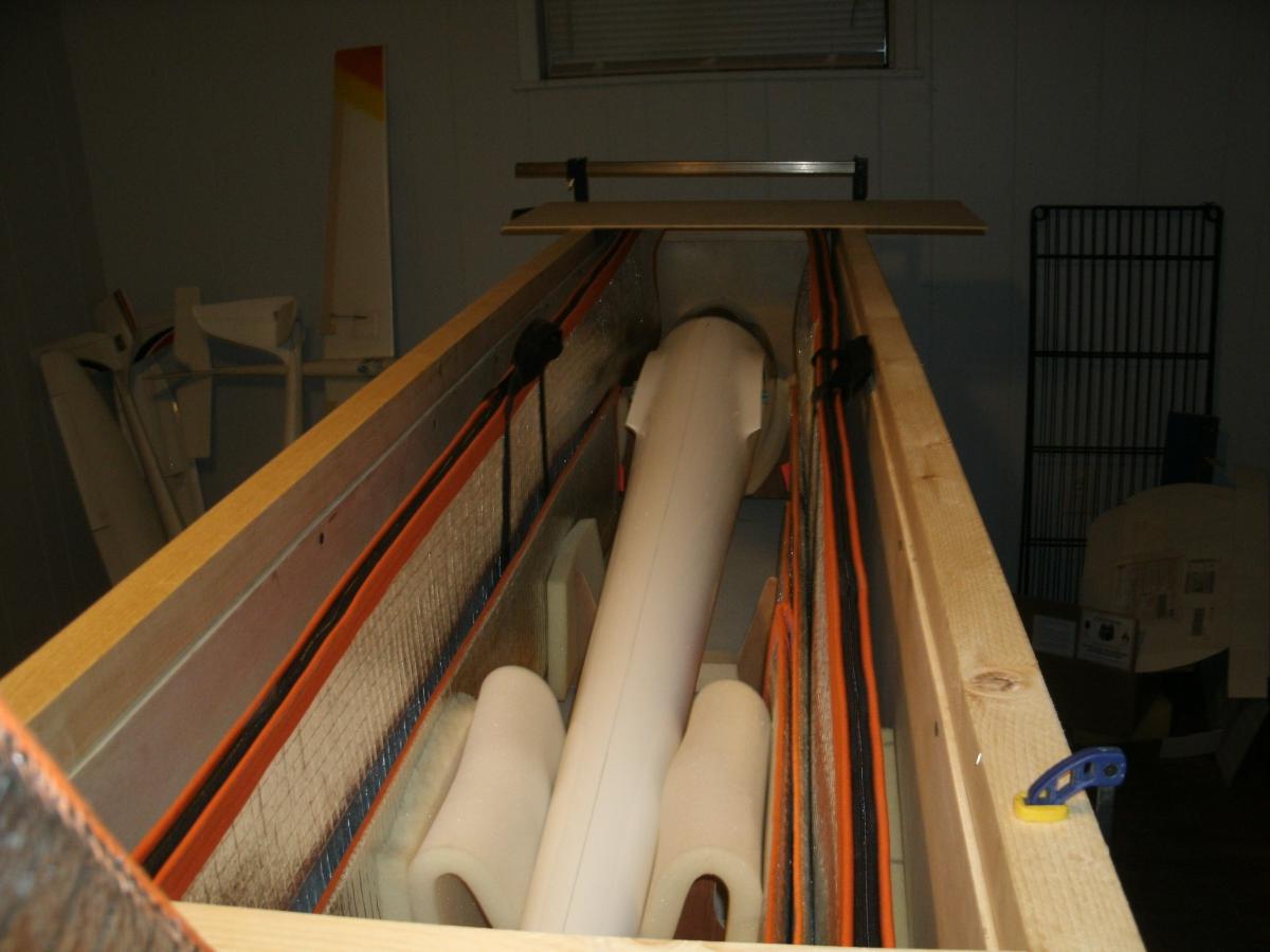

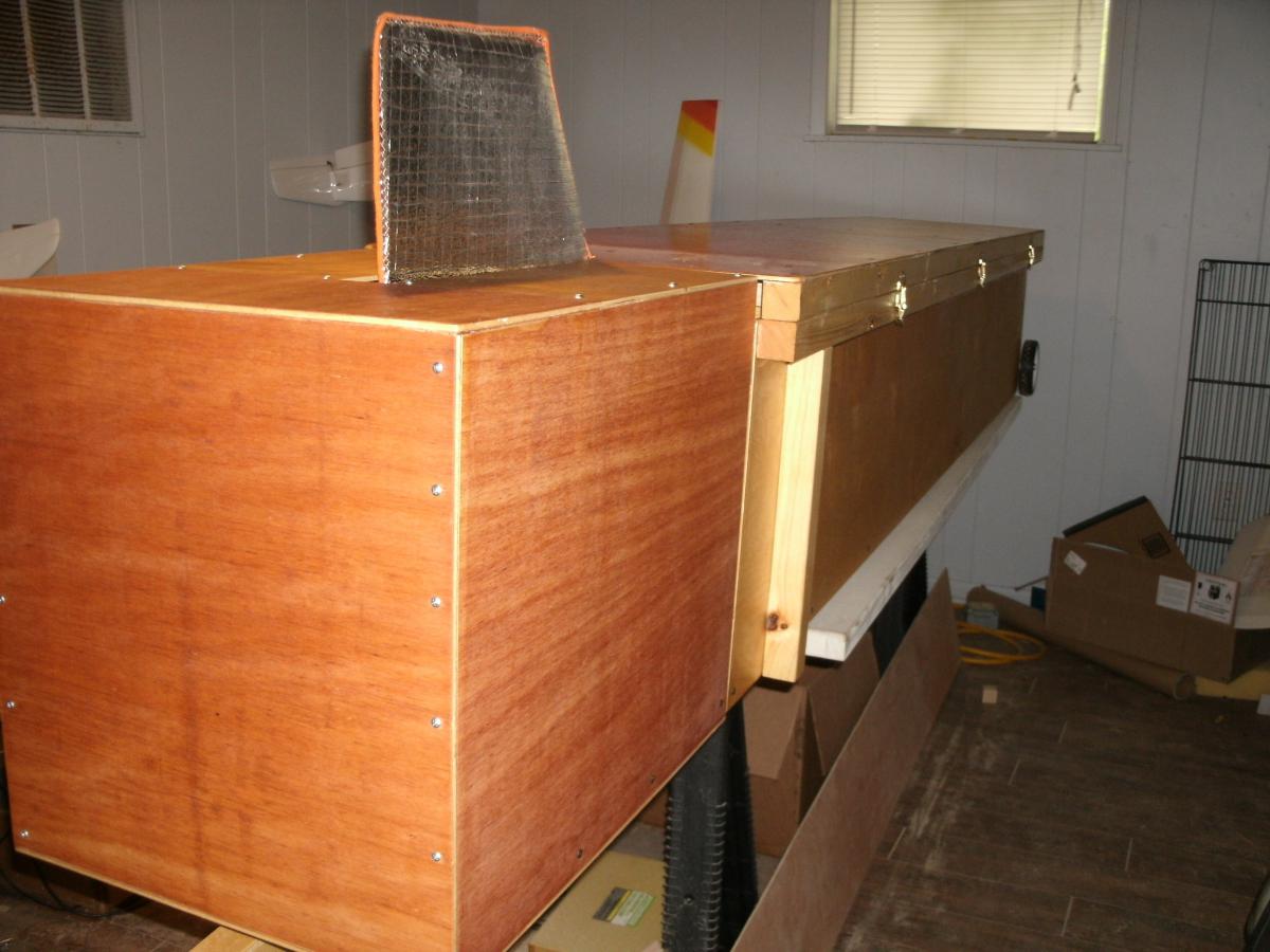

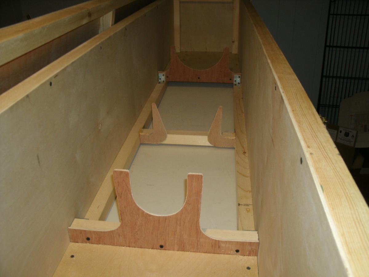

Here's the pic that was closest to showing it completed. The only thing missing is the hardware to hold the extension box in place and the rudder box that folded forward to cover the vertical stab after the extension was slid into place over the aluminum dowels connecting the two parts of the box. Not the most handsome box out there but strong enough once everything was latched together and light enough for me to move it around by myself, although I wasn't lifting it onto a roof rack by myself, just into the bed of a small pickup.
