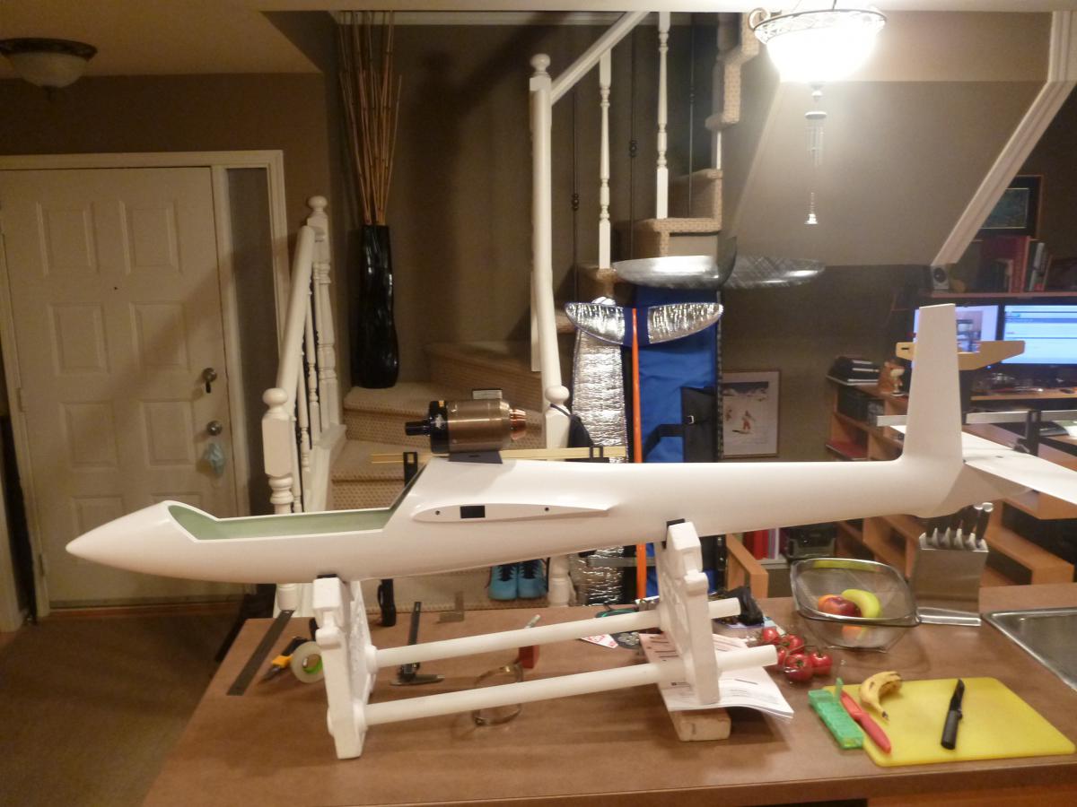

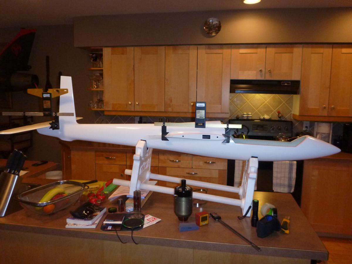

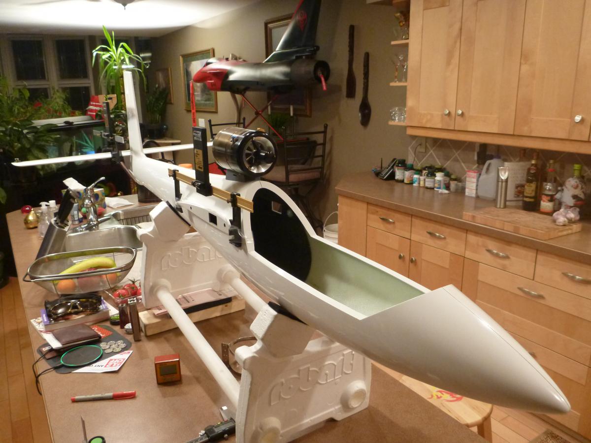

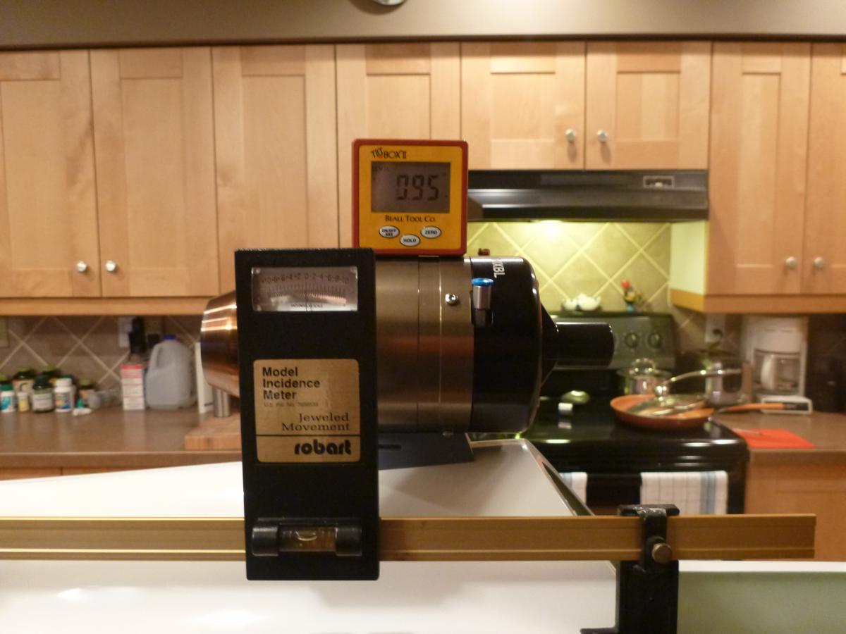

Next on the bench; 3.2 meter max carbon layup S-1 with 100XBL. Just received 3D saddle mount test-piece to confirm saddle mount-to-fuselage's varying radius, wing / stab to turbine thrust line (need another degree me-thinks), strap design (either single or dual with saddle cross-drilled for M3 bolt(s) / ny-lock(s) to squeeze turbine to mount and two M5 vertical bolt holes that will capture the hex heads - under the turbine before creating a file to CnC from 6061.
The vertical / captured M5 bolts will enter the fuselage and be secured with ny-locks from the front cockpit access to secure. The idea is to be able to remove the turbine and secure the electrical / fuel line back inside the fuselage in less than a minute.
