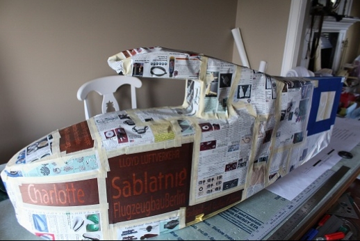

1923 B3 'Charlotte II' in 1:3 Scale
  • Thanks, Art! How's Larry doing? Tell him hello for me! Only four more ply panels to go. When done some pics will go on site. Covering will commence this weekend. The Bug's engine bay is cleaned up. Replaced emergency brake cables, throttle and clutch cables and all the rubber parts, seals and grommets.The rear brake plates and associated components and lines got refurbishing, too. Just waiting for a new Bosch voltage regulator so the wires can get routed for it. It is getting relocated to the under rear seat area because the twin carb engine doesn't allow room for it as it normally would sit. Yessir... we cut wood, mold fiberglass and turn wrenches on this here forum!

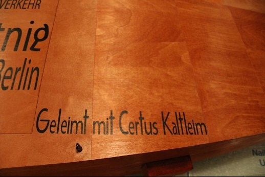

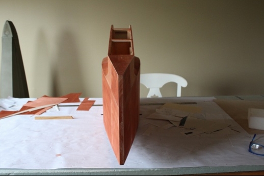

  • Here are some pics! I had to add formers to keep ply from 'oil canning' and I used balsa sticks over the seam and edge of the ply with these iron baluster off-cuts to weigh the ply down while the wood glue sets up.

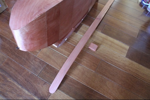

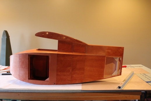

    • Ply covering done! Need to seal wood with nitrate dope then paint lettering using stencils from Flight Line Graphics. The skid was ripped from Ash then sanded. It still needs to be shaped and cut to length. The rudder bar 'bulges' on the fuselage will be vacuum formed using a shaped balsa plug. I'm guessing they were formed from aluminum so I'll paint them to resemble it.
