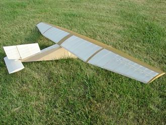

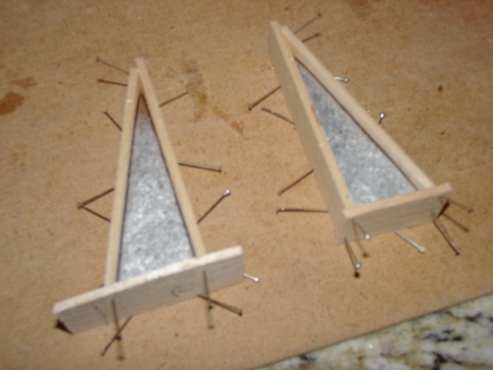

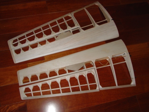

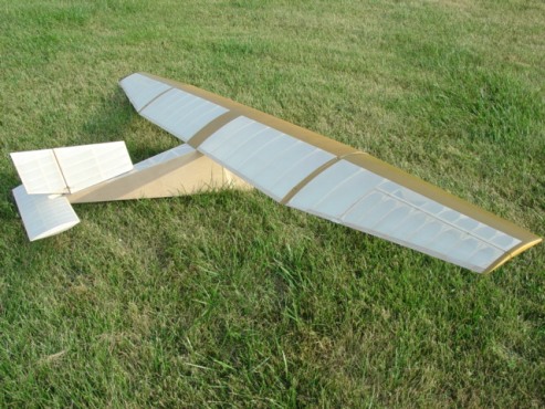

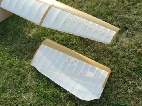

    The process to build an aileron panel was definitely a lot easier than the 'warperon' version! Servos with hatches were mounted in outer panels so extensions had to be fished though the center panel. Washout was built into the outer panels.I made some removable lead slugs of varying weight for best trim. They are shown cooling in their forms. They fit either side of the nose wheel. It is a thick winged antique that is a little draggy and can penetrate as well as a wet noodle into tungsten plate but I love flying the Vampyr! It can thermal pretty good not that I'm an expert. It handles like a boat as far as the ailerons are concerned. You keep applying aileron and keep bending the transmitter lever then finally it breaks over so you repeat the process the other way. It needs the rudder. The elevator is dialed in really nice. The Vampyr is only my third sailplane. It had some interesting construction features. I like it! Thanks for tagging along. You can unfasten your seat belts, now! Here are a few more 'in flight' pics by Andy Grose. Thanks, again, Andy!
