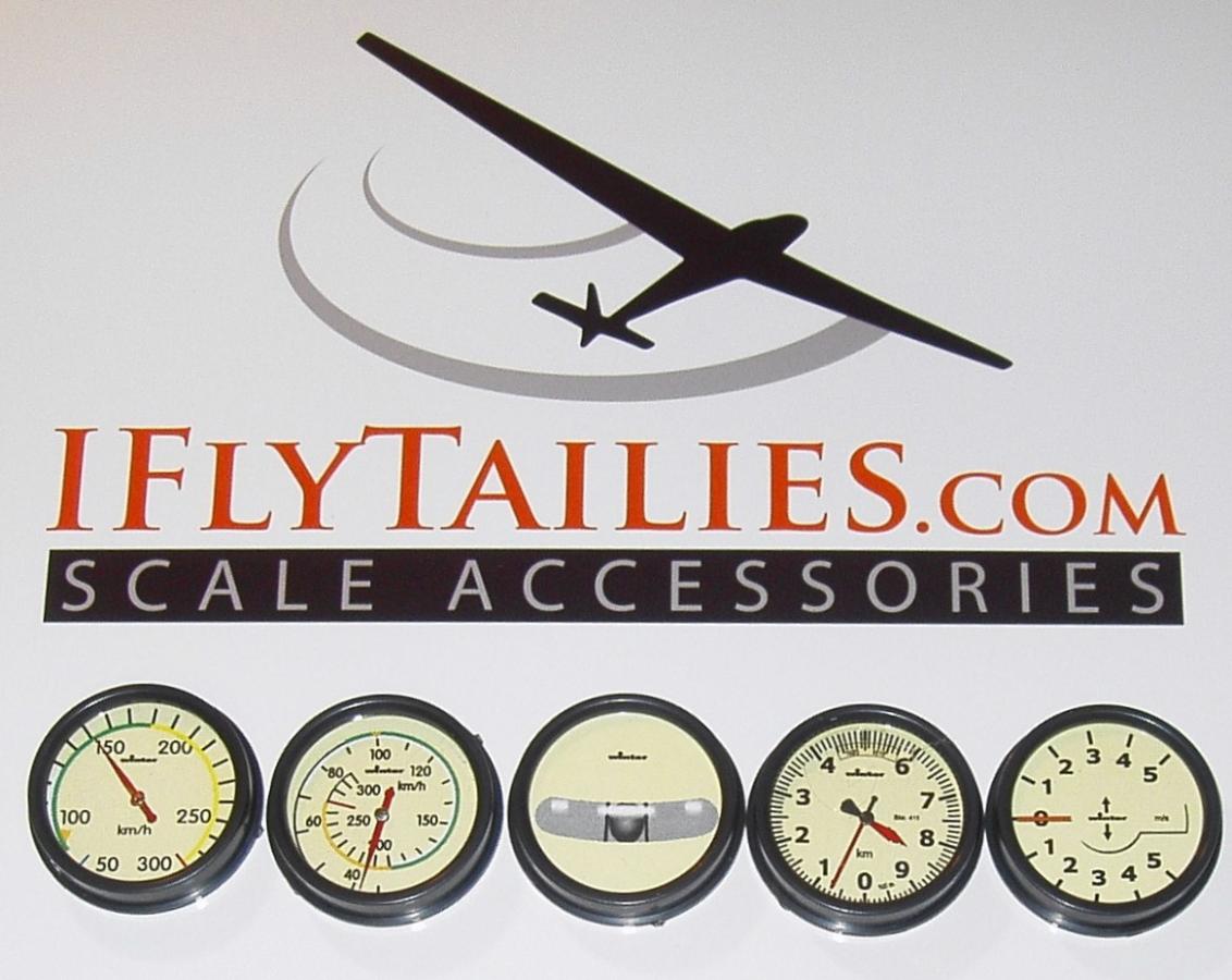

                    I need advices for 1/3 scale instruments ? I found a couple of adresses on the net but what would you guys recommend ? Any U.S. or Canadian distributor ? Is there different products ? Quality ? Thanks for your help.
                      Those from Iflytailies are good products
                        Ok thank you Len.
