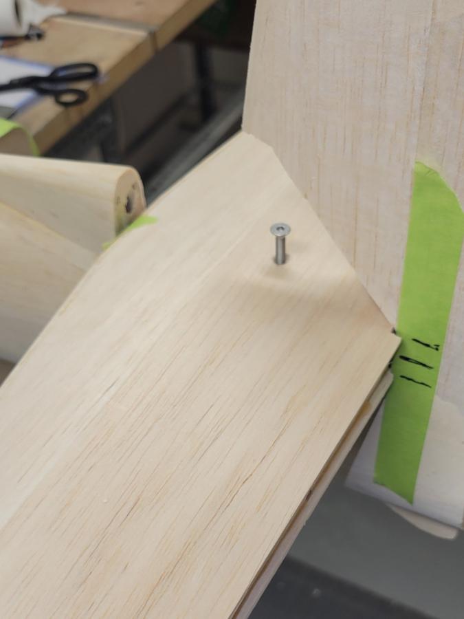

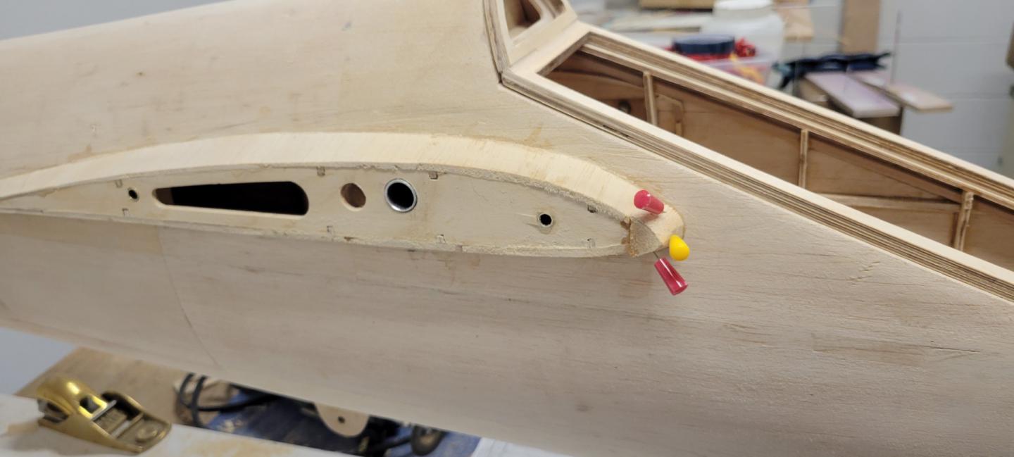

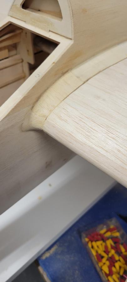

    Finishing up the wing root on the fuselage. The remainder was sheeted and blocks added at the LE. Then things were shaped to match the wing panels.

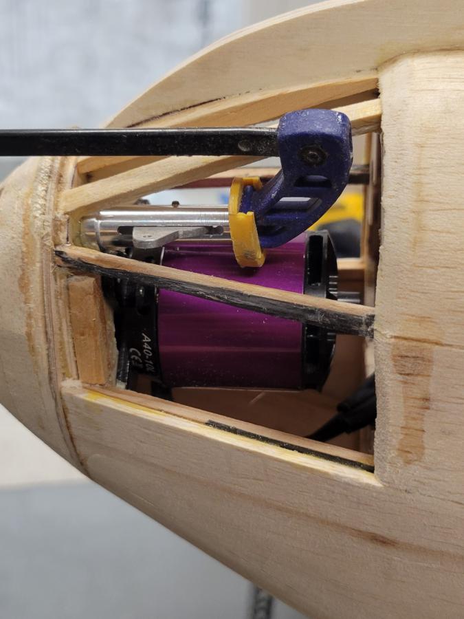

        Almost all of the fuselage sheeting is now done. There is just the front section by the motor. I have been looking for what to do with a tow release. I did find room to stick in a standard Topmodel release. Just enough clearance on the motor and the sheeting for the pushrod. I have also rough checked the CG. Things should be in the ballpark with no weight needed.

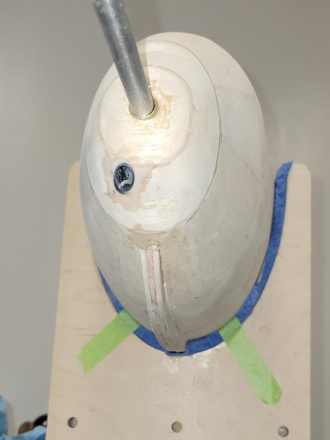

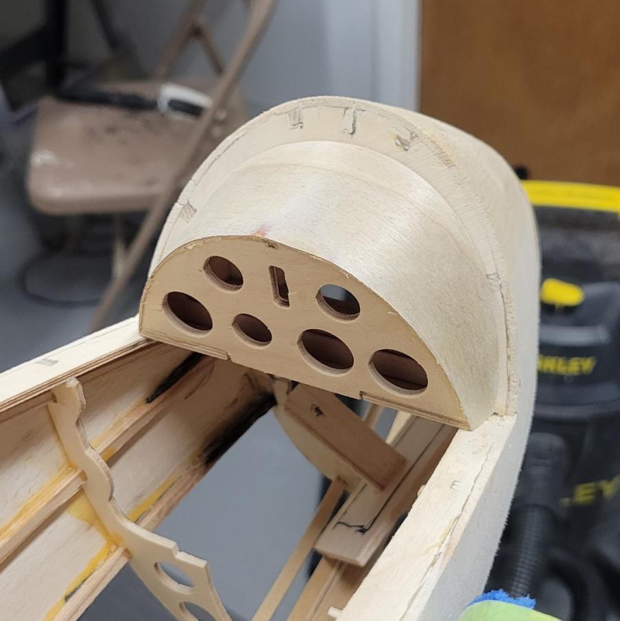

          The nose is now all closed up. The last of the front sheeting has been added and sanded.
          The tow release does not make it all the way out so I glued in a piece of fiberglass tubing cut on an angle to protect the balsa from the tow line.
          A short section of brass tubing was added to the nose block. It's not a glass fuselage so the tubing provides a hard edge on the hole for the prop hub. The other piece of tubing is just to make sure there is clearance when inserting the motor.

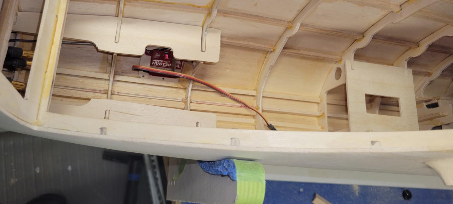

            The front of the fuselage originally had a ply tray that linked the first few bulkheads and also provided a place to mount the tow release servo. This piece was only used to align things when building the fuselage. It is in the way of the motor and access to the motor and tow release.
            A wing servo was mounted to the fuselage side down low for the new lower nose tow release. It still makes sense to tie together some of these formers. Two pieces were fabricated that go between the three formers. They extend all the way to the fuselage sides. Enough space remains to access the motor. The pieces will also be used to bolt a front equipment tray in the fuselage if the motor battery ends up mounted up front for balance. The Zugvogel had the battery mounted under the wing. But that model has a much lighter tail and smaller tail and lighter fuselage. The Mucha probably needs the battery weight up front. The battery can sit down low or up on a bolt in tray.

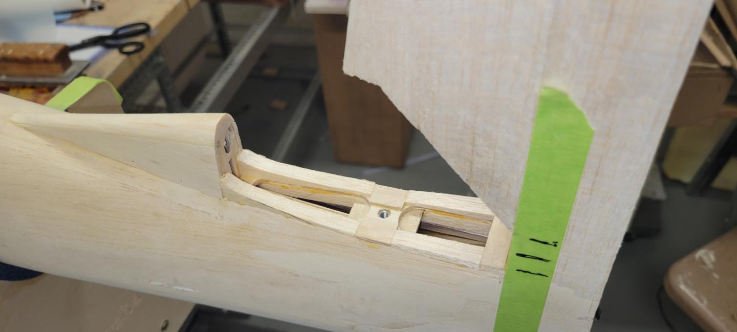

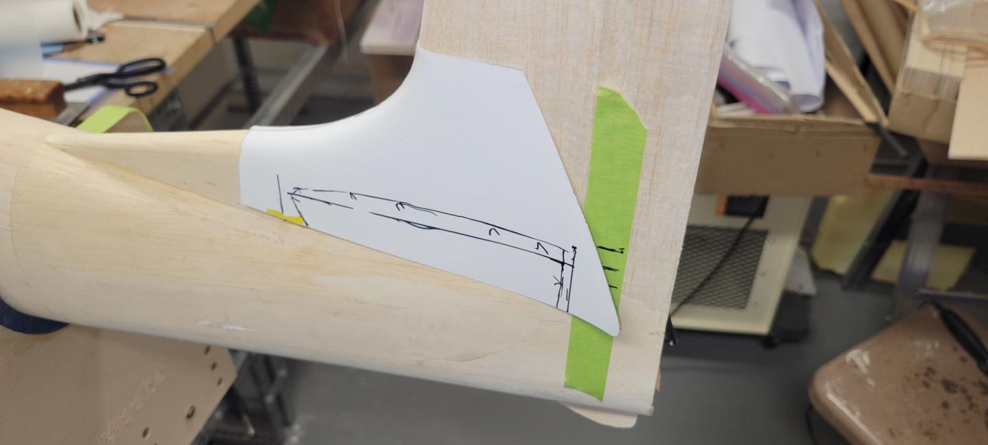

              Some work on the back end of the model. The stab mount needed some more work. The balsa filler under the stabilizer was added. The part of the fin in front of the stab was also sheeted. There is a hole drilled though there so the elevator servo could be plugged in through the top of the stab. That will make assembly much easier This is possible because there is a removable fairing above the stab.
              Here is where things go.

              And the faring marked up but not yet cut.

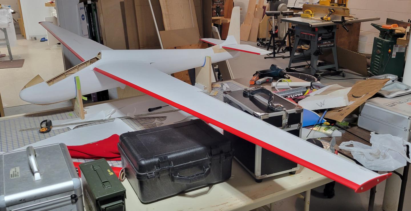

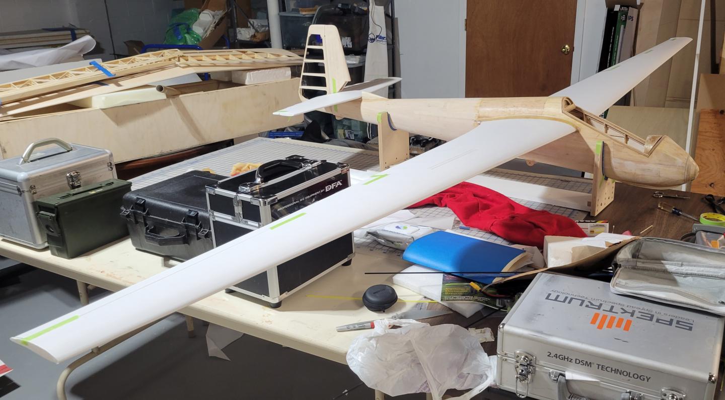

                8 months later, the project is still alive. I finally put servo mounts in the stab for the elevators and now the stab and elevators are covered.
                Final wing standing and then covering is up next.
                  Some progress on covering the wing and the tail. White Oratex. Now the wing and stab are ready for hinging and servo installations.

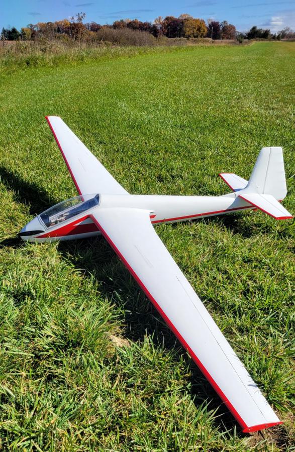

                    • #40
                      Covering and radio install was completed. CG around 120mm. The instructions called for 11 to 12cm.
                      The first flights were off winch launch.
Name:	MuchaFly (2) (Large) (1).jpg

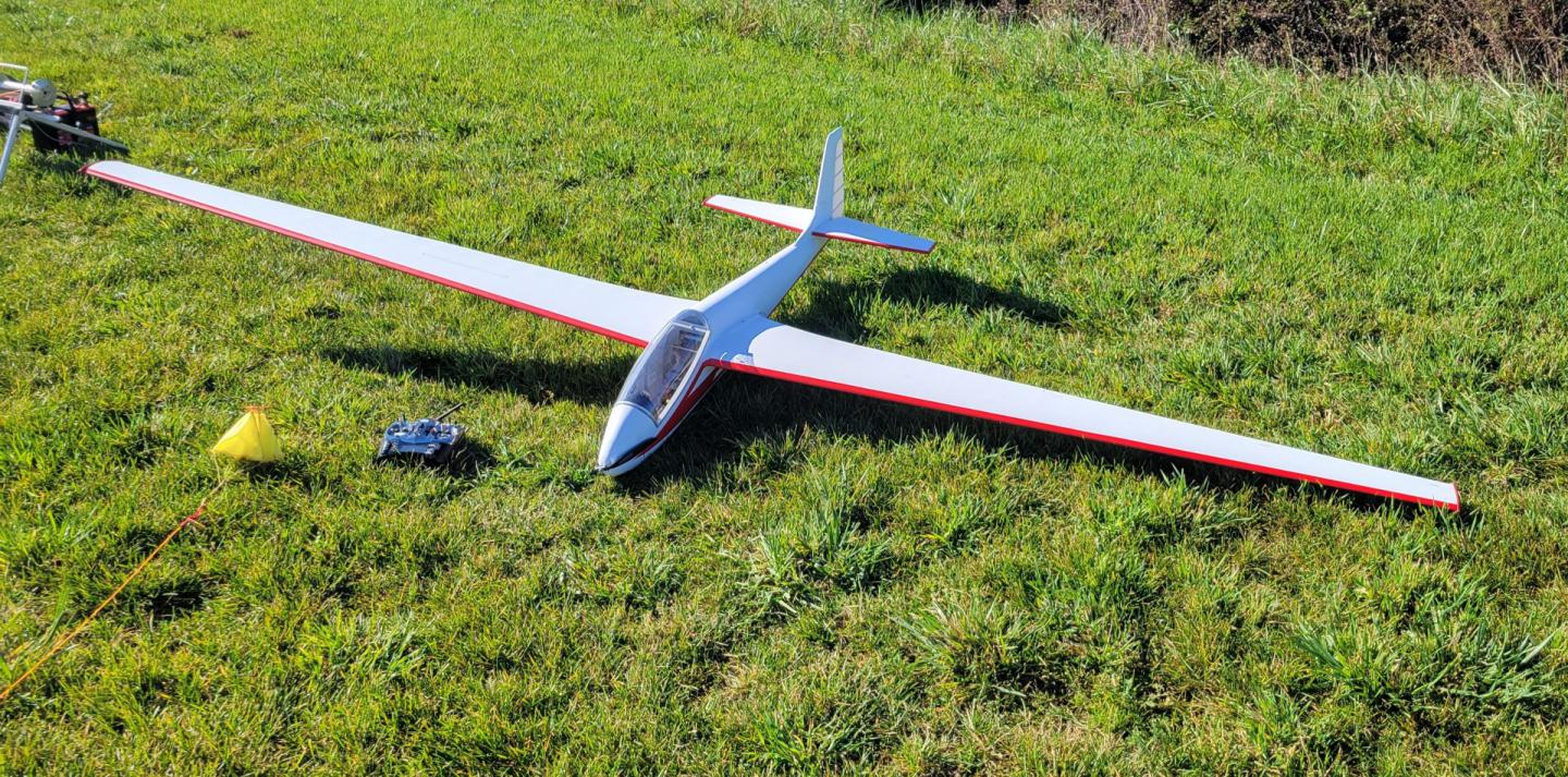

                      I run the winch enough to get things up in the air from the aerotow connection. After releasing, the motor provided more than enough power. Initially there was a 14x10 on the front end. At full charge in the cooler temps, it peaked at 59 amps. So in warmer weather it would probably go over 60 amps. The climb was pretty good so after the first two days in Cumberland, I switched to the 13x10 white blade. That dropped things down to 55 amps.
Name:	MuchaFly (1) (Large).jpg

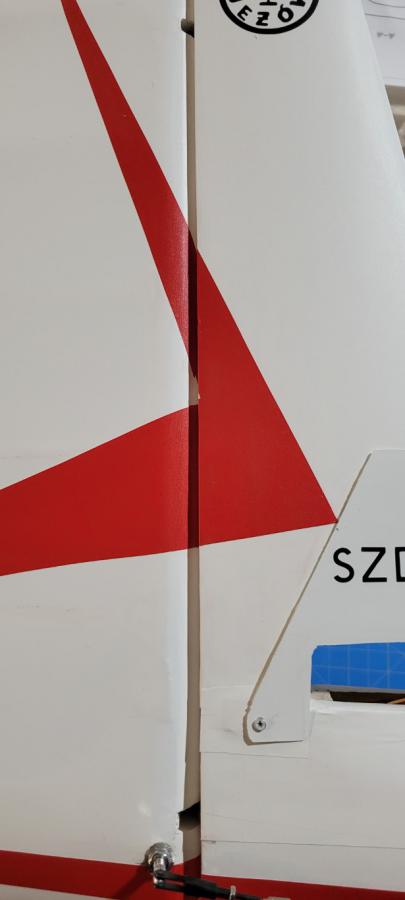

                      Some lettering and logos are still needed. After the initial launches, I added a red stripe on the bottom. That did help in visibility at Cumberland. I think I will remove that red and put on several stripes in the mid section and at the tip. The rudder and fin also needs some red trim.
