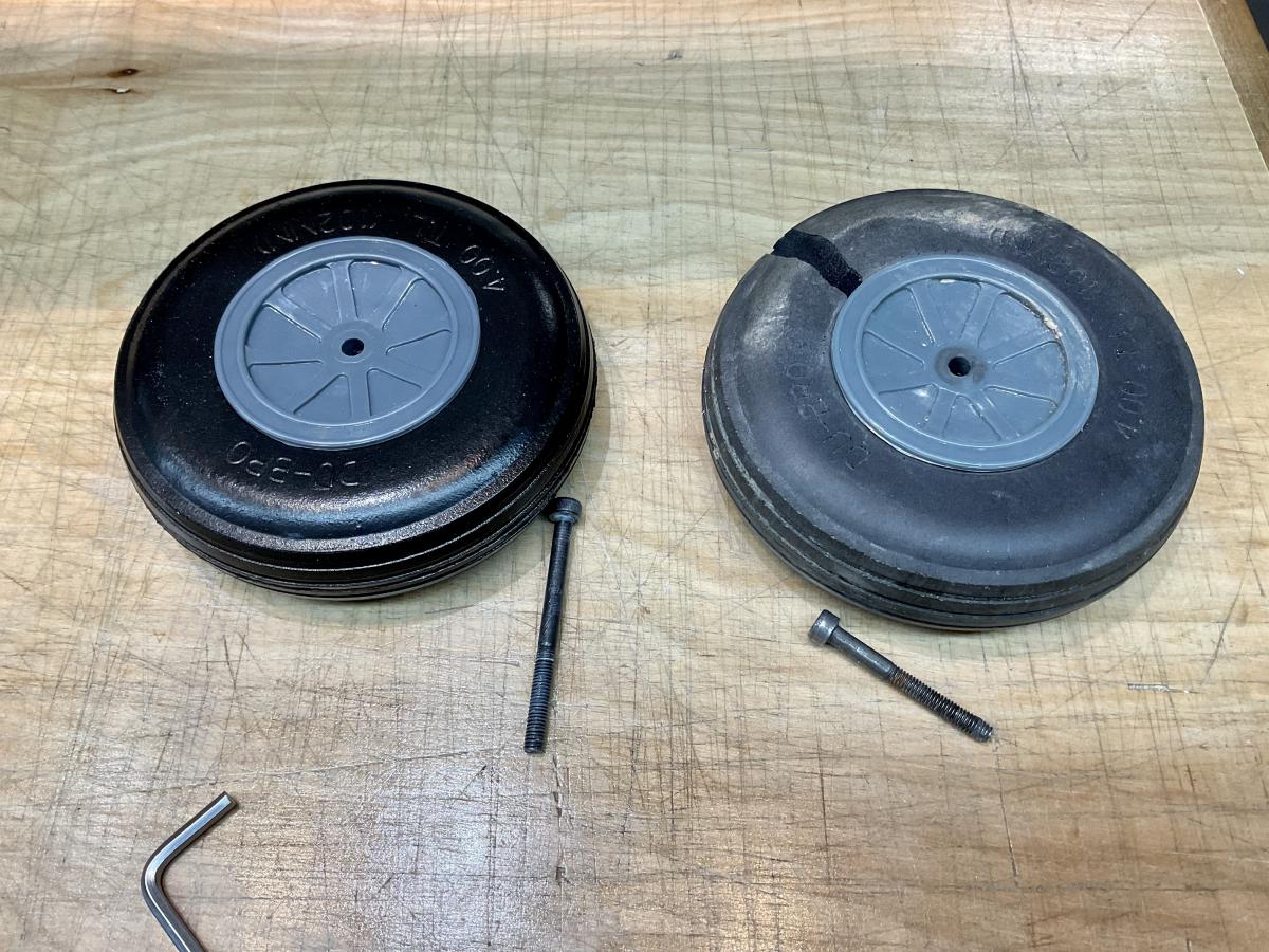

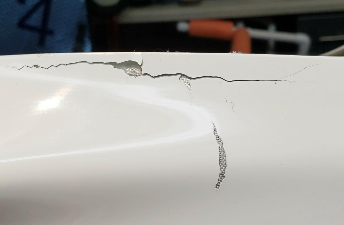

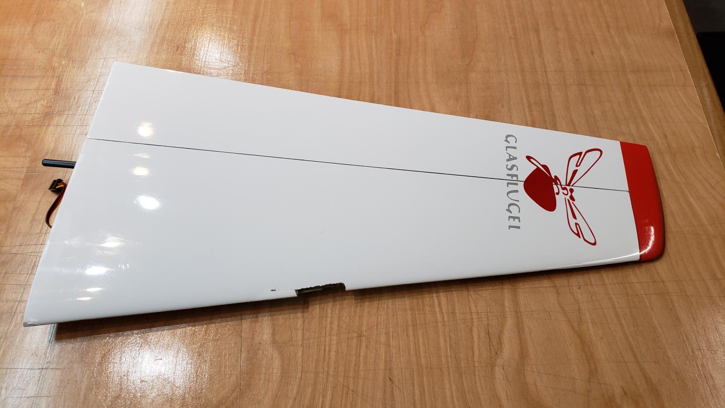

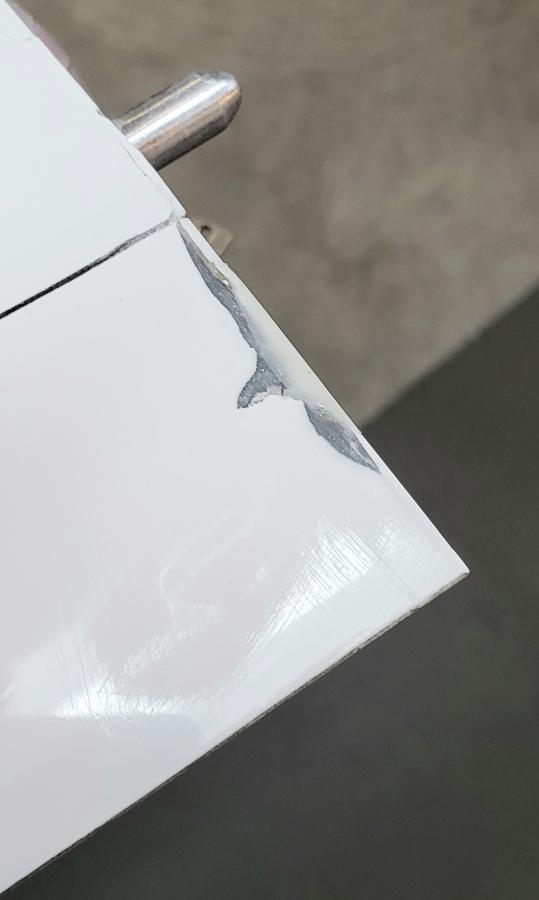

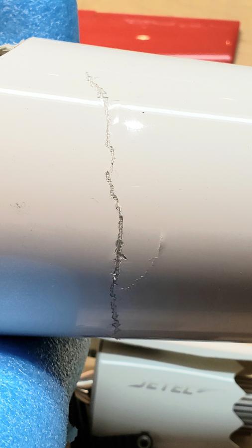

Next was a wing. It was okay fine! Then the fuselage showing a large stress crack behind the EDF opening and another along the canopy opening, but that was blissfully the full extent. Okay, I don’t think the wheel was jammed quite THAT far up into the fuselage!? Then, a few yards farther away another wing also perfectly intact save a small ding in the flap root. That wing had clipped one of the v-tails on its departure and took a one-inch section out of the tail’s leading edge. An easy fix and perhaps opportunity to add a stripe! Under the fuselage I found two big hunks of carbon that used to add up to a single wing joiner. In total, not altogether awful.

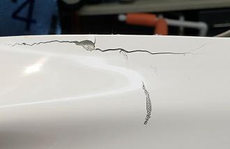

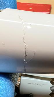

The large crack does not sever the cloth while the canopy area is all fractured filler...

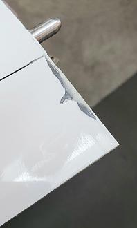

The tail damage is also the filler that makes up the leading edge...

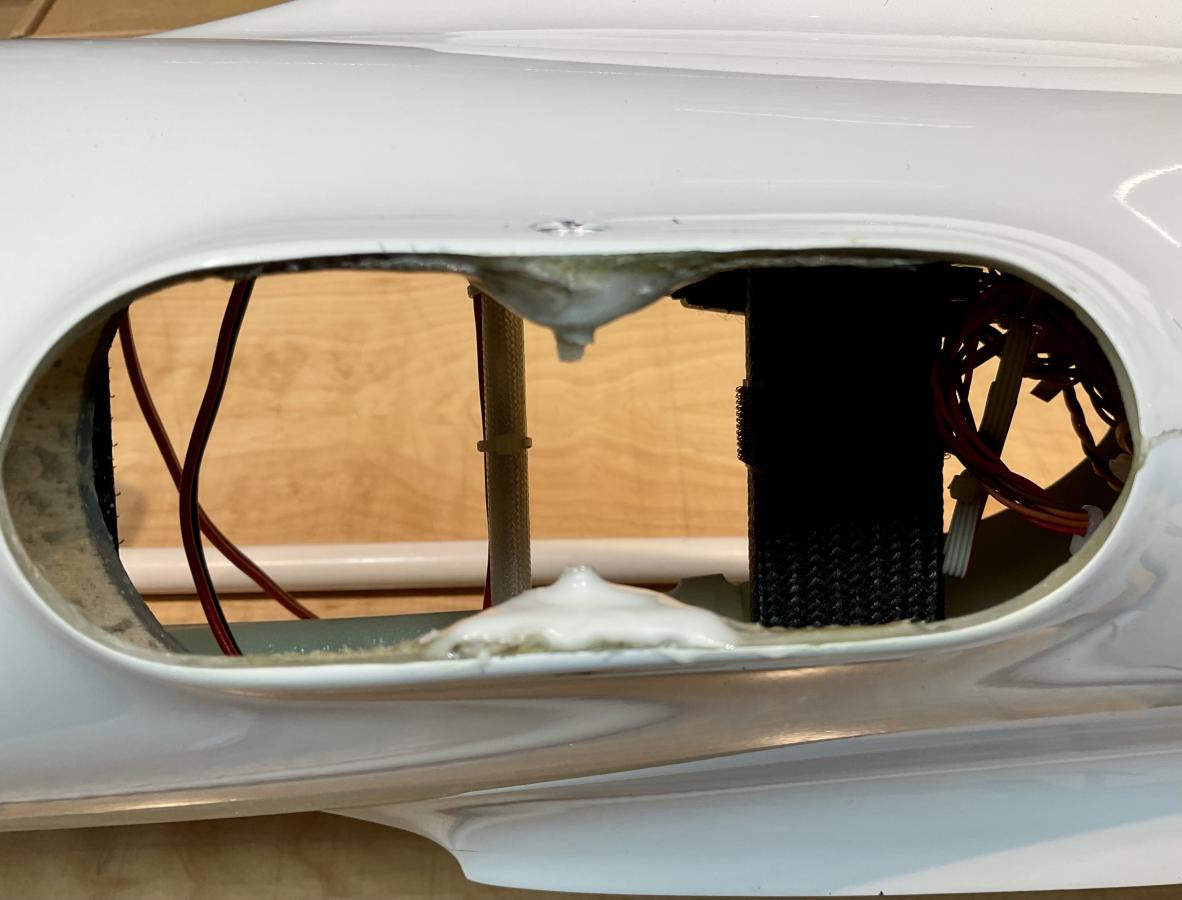

Back home in the workshop there were no other airframe issues to discover. The canopy area cracks were actually in simple fillet filler while the long crack was not clean though and could easily be repaired with glass and epoxy from the inside. Add a bit of time and paint and nobody need be the wiser.
The flap root was a quick repair with epoxy and West 404 high density adhesive filler. It will get paint when the fuselage is done...

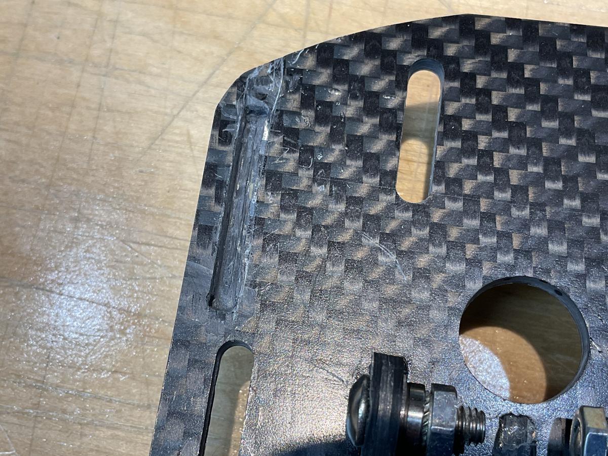

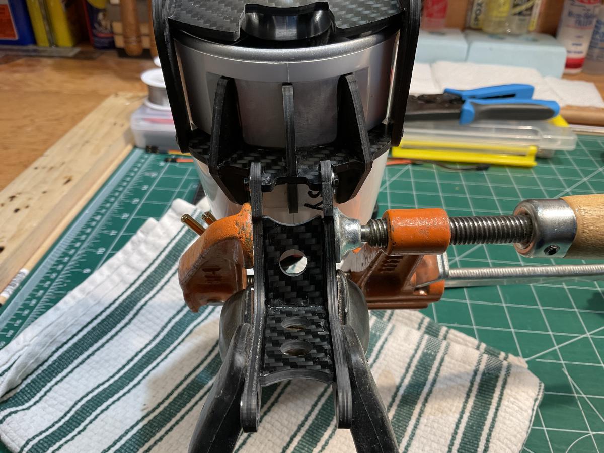

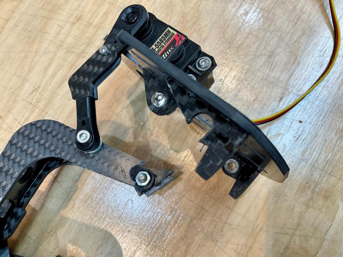

That’s when I discovered that the EDF I thought had made it through this affair unscathed (because it closed and opened with ease) actually had fractures in its frame.
%$#@! That’s not good. These are sold as complete units fully balanced and ready to fly, not in parts.
Some cracking, ripping and breaking to attend to...

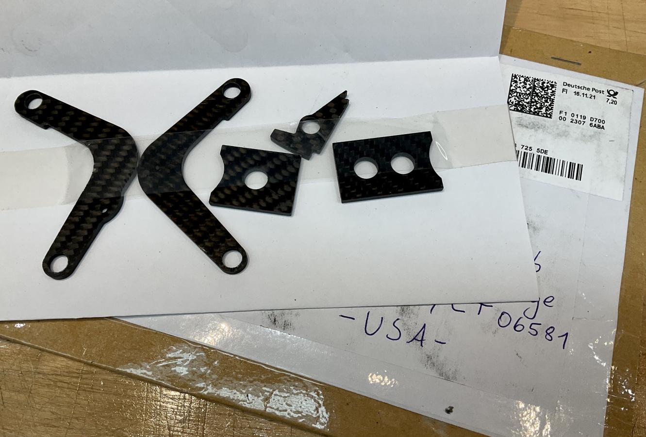

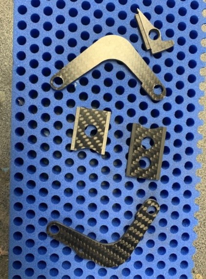

Thankfully, another good stroke of luck is that Migflight based in Hochdorf is just south of PowerBox in Donauworth. Georg showed me some Team PowerBox love and offered to either take the unit back and give it a thorough go-through (It ran fine so that option did not seem worth the time, shipping and customs expenses), send me the dfx cut files to have them cnc milled here so long as I promised not to share the files, or just make me a set of replacements and put them flat into an envelope as regular mail. Option three it is.
Within a day, the repair pieces were on the way to Connecticut from Germany. Thanks Georg!
